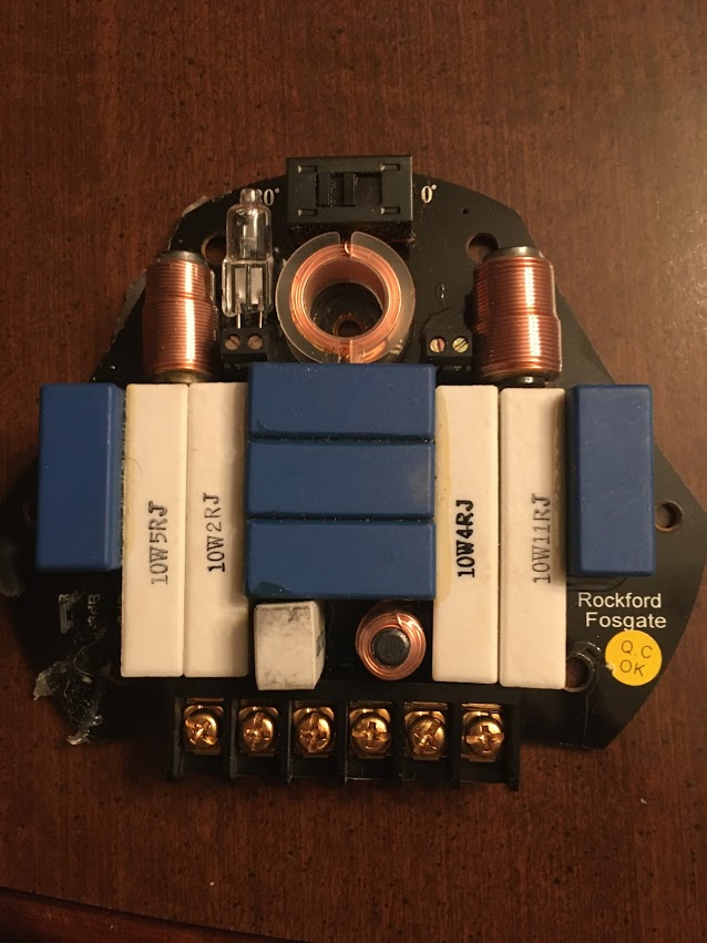

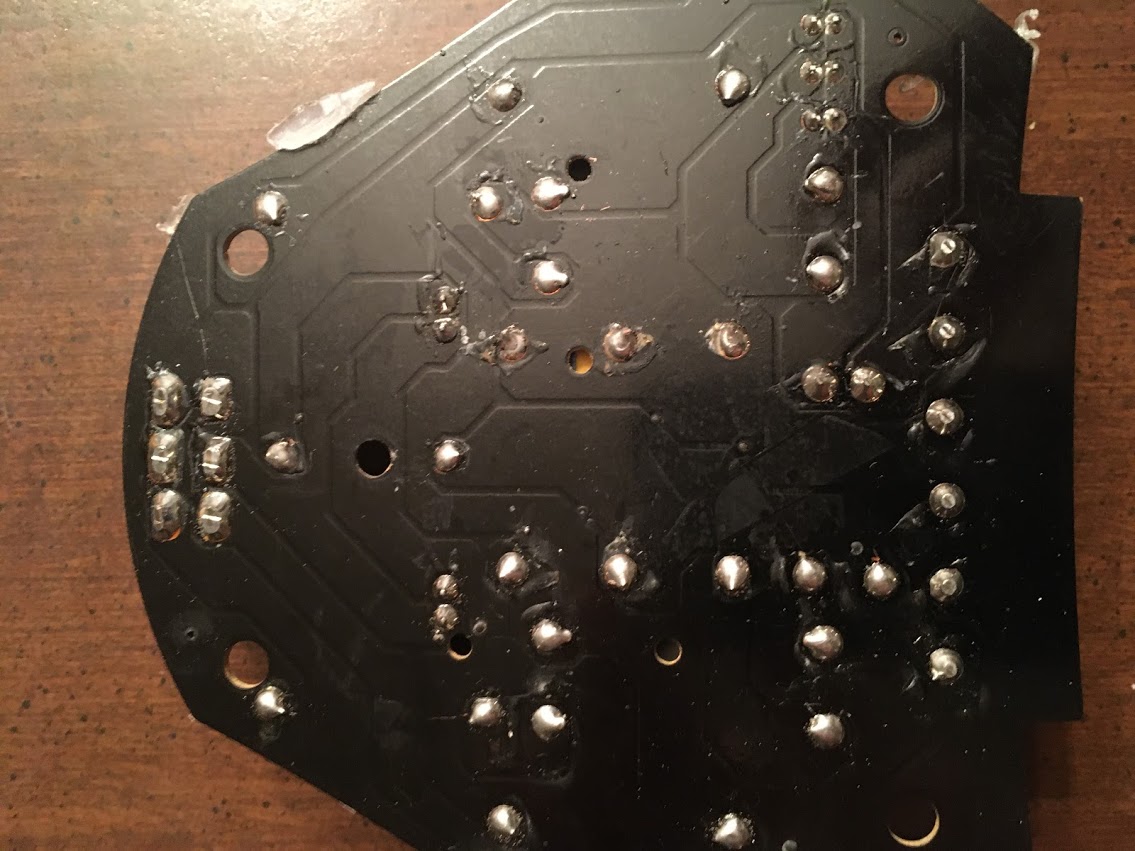

Passive Crossover repair help needed
I have a passive crossover I was using in a car audio install. The tweeter was dropping to very low, muffled output... then would cone back at random times. Now it just stays at very Very low output. I hooked up the crossover to a different speaker and a different amp to isolate and confirmed it’s the crossover causing the issue. It’s a good one and I’d like to get it working again but don’t know where to start or what to look for. Capacitor gone bad maybe? I’ve got a ddm and general knowledge. I think I could do it with a little advice. Would appreciate any thoughts on it thanks!
Do you have it apart yet? A poor-quality solder joint is the most likely culprit.
A careful, thorough visual inspection may be all you need. Electronically, a passive crossover is not terribly complicated. Odds are there isn't even a Service Manual for it.

Photos (good quality, top and bottom of the board) would help us to help you.
Post #2 is likely correct. You could touch the various components on the board to see if touching any specific one makes a difference.

Maybe check the resistors, have had some run warm in similar arrangements.
Those are film capacitors, should last a lifetime, would be the last thing I would suspect.
I’ve seen the electrolytic type test with elevated values after years of use in filter circuits however.

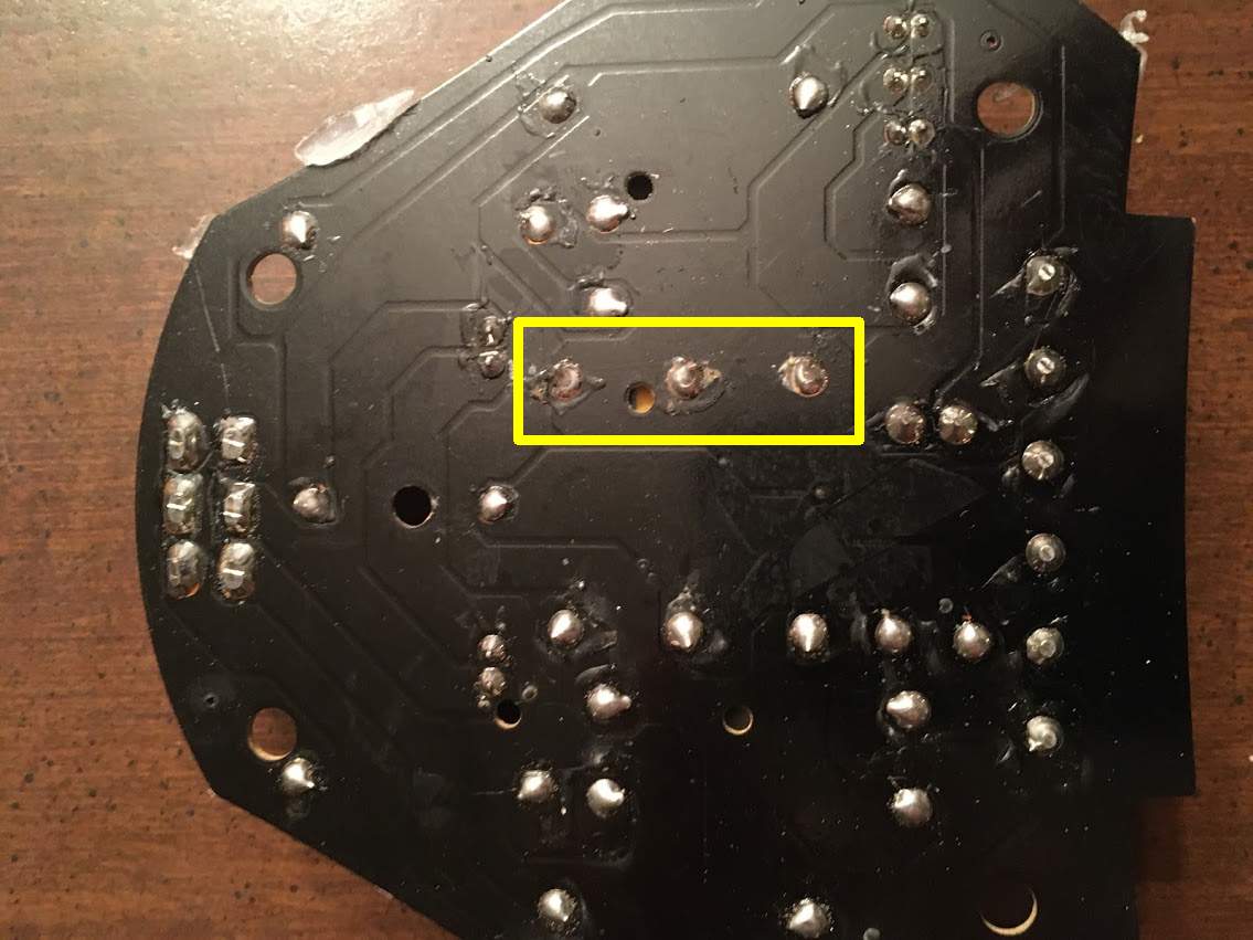

Usually turns out to be the solder joint where a screw bears down into a connection.
I think the torque breaks the copper foil around the solder joint, it can be hard to see unless you remove the solder.
Scrape some solder mask off around the pad, tin and solder on a wire link twisted around the pin.
