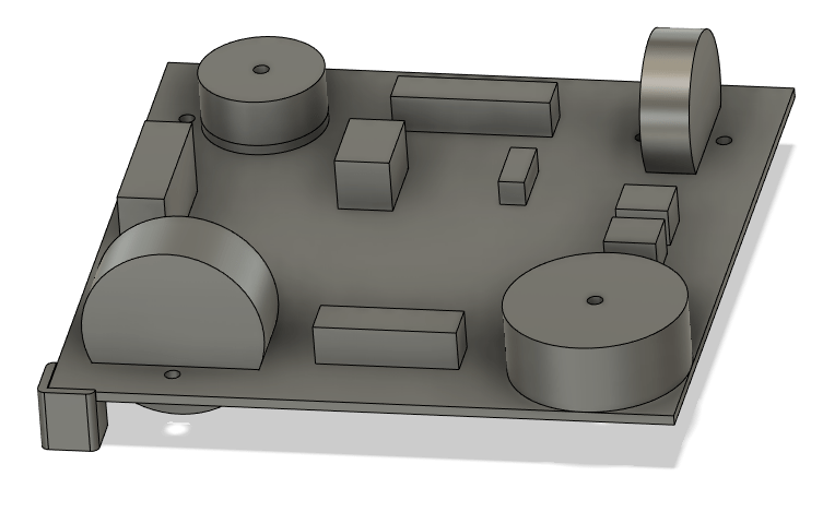

Hello all,
here is my DCX464 crossover layout - it contains 4 coils. The bottom part is low pass for the mid part (LCL) and the upper part has a highpass (LC) on the left and a notch filter inductor on the right. The board is now 240 x 240 mm. The C-C distance of the inductors as shown is 170 mm along the edges. The squares are other components and terminals. Can I get the board smaller by rotating the inductors better? I could follow the orientation rules for two or three, but what would be the preference when having 4 with these functions? I think I can leave the boards this large, maybe shift the smaller inductors further away a bit closer to the edges if there is nothing much to be gained from different orientation of the inductors. Any opinion is welcome.
Try to rotate axis of one inductor orthogonal to the other so that they don’t cross couple. Distance helps but it is surprising how audible the cross coupling can be when axis are parallel. You have all 4 parallel here.
Here is a video I made of air core inductor cross talk. One XO board transmitting sound to another XO board that is not connected to an amp.
Make 3 orthogonal. The 4th should be the smallest one and placed furthest from the largest - make these 2 with same angle...
Thats my take on it.
Warning: there is a bit of intuition in it 🙂

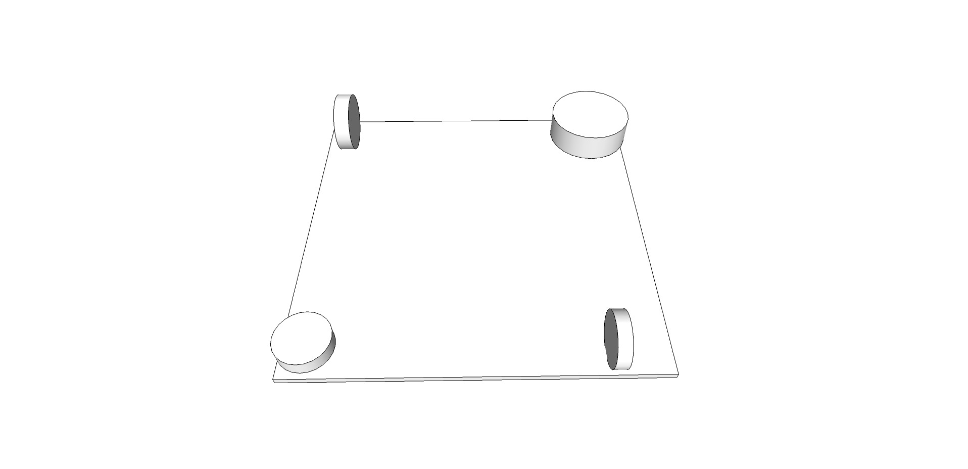

I came across this solution to the problem recently:

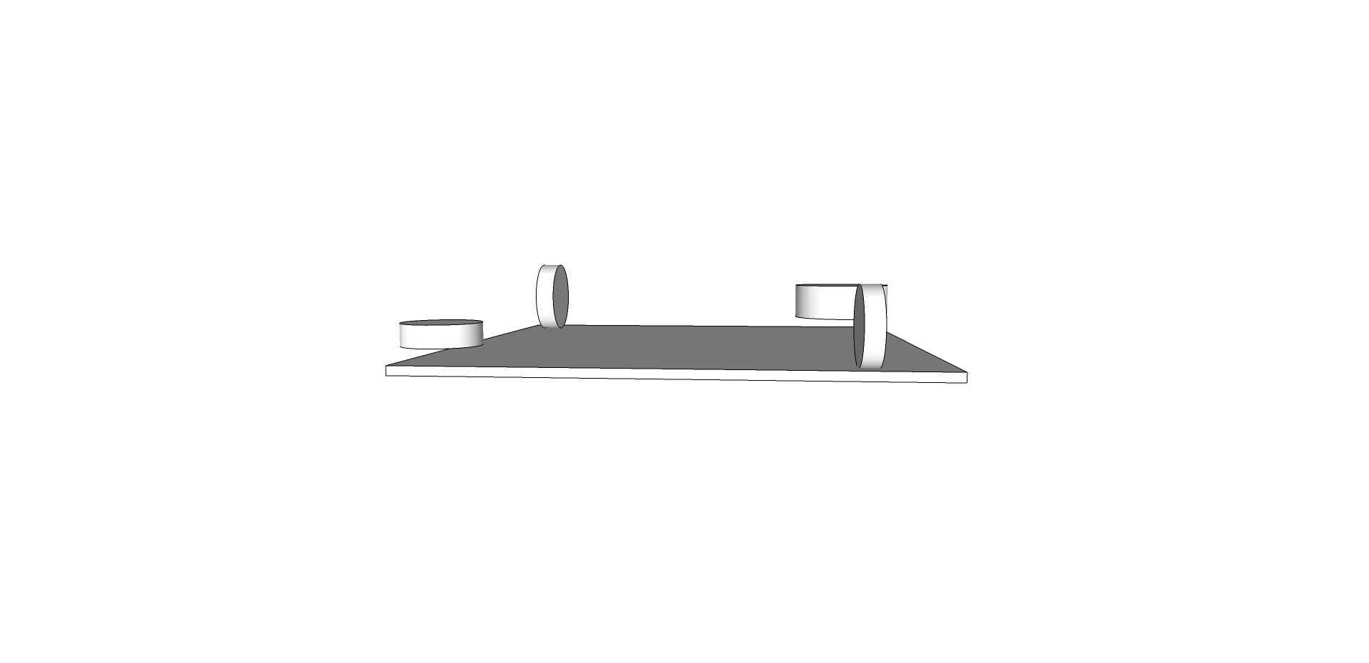

There was a suggestion to also raise up the horizontal ones so they sit more or less opposite the mid points of the opposing inductors, something like so:

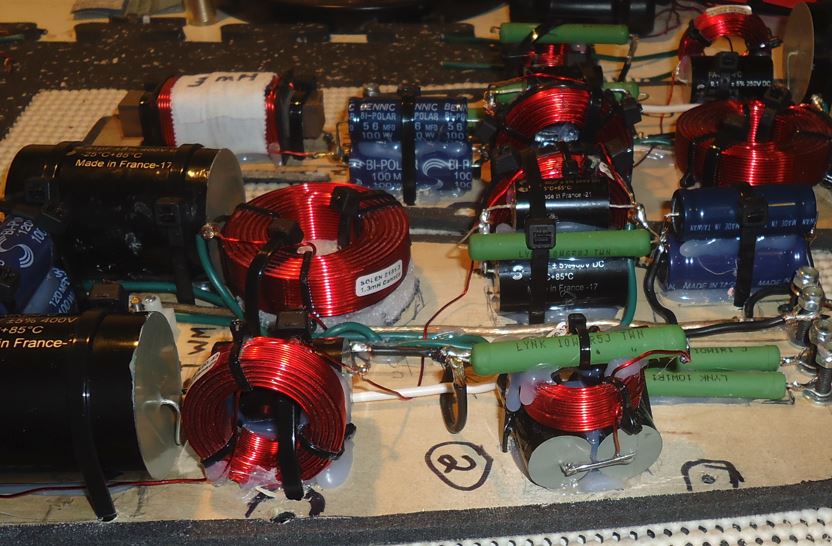

I didn't measure the inductor values once I installed them but the FR measurements I took showed no variation in response from when I had the xo (and inductors) spread out on the floor during the testing/fine tuning sessions. And my distance between inductors was closer to about 70mm than 170 (that's the 2 xo's side by each in the pic below btw):
