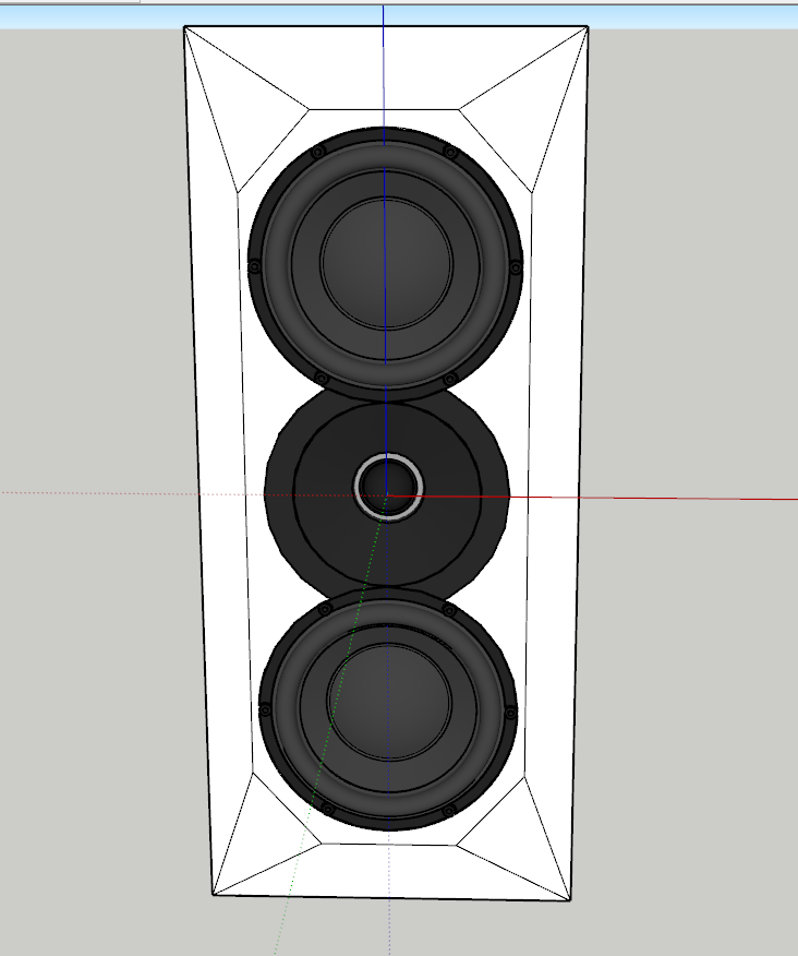

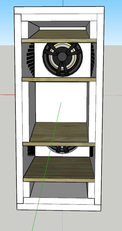

Satellite Box Construction
I want to make the cabinet out of two 18mm sheets MDF laminated together (maybe with Swedac Damping Glue DG A2, if I can get my hands around it)
The tapered enclosures are thought to be 10mm plywood or is this too thin?
And should I plan more bracing?

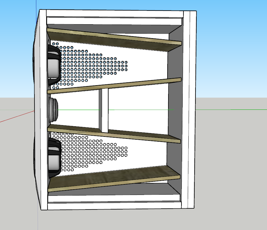

On the sides you can see a pattern of holes which will hopefully make a cardioid response. On pic 3 you can see two 3cm thick pieces of acoustic foam on the sidewalls. Together with the holes this should make a aperiodic enclosure.
The centers of the mid-drivers and the tweeter are located together as close as possible. For a "perfect" D'Apollito arrangement I'd need to cross them at 1655hz, which I think should be reachable with the use of the waveguide.

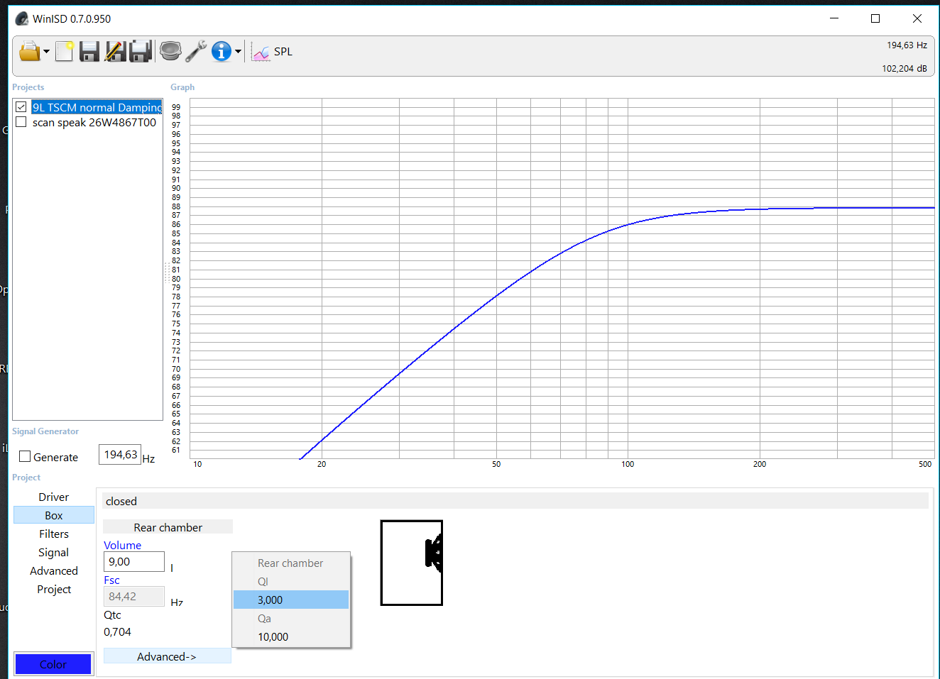

Some Calculations
Somewhere I've read that you can simulate an aperiodic enclosure in WinISD with a box leakage(Ql) of "3", is that correct? Furthermore I simulated some stuffing with the a Qa of "10". Which gives me a Qtc of 0,704 at 9L .

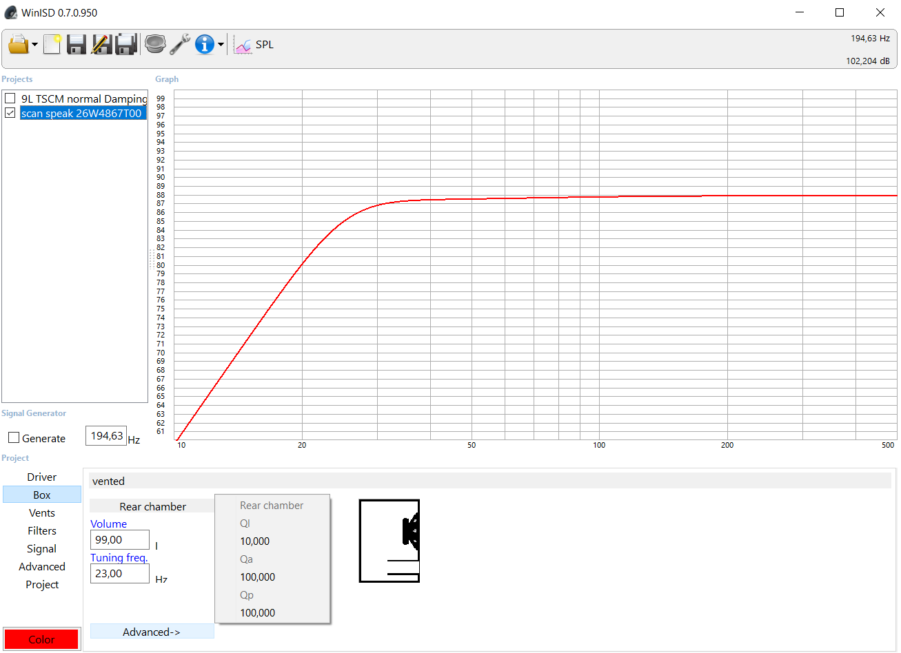

For the sub I simulated a big(99L) vented enclosure, because most programs I found can't simulate a transmission line and I'm not yet good enough in hornResp.

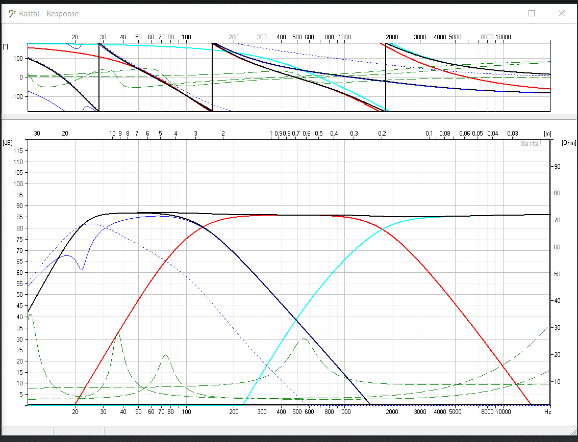

Then in Basta! I simulated a active crossover so see how the drivers fit together:
