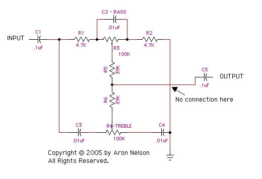

Tone controlls ... what do you want active or passive ?? what is the source impedance ??
thise post shown a passive 2 band tone controll ...

This is the picture from the first pick ...
Well I don"t have any passive curcuits that would be good for inside your guitar cavity ... You loose more than half of your signal with a Passive setup (passive setups allmost allways have an active Makeup gain stage to compensate) so You will have to crank up your amp Way higher just to get the same volume .....
You could fit an active setup inside yer guitar and run it off of a 9v battery .....
The pic I posted is passive but needs to be fed with a low impedance signal .....

For guitar, I've never seen a two tone jobbie for pickups that wasn't active, because the insertion loss of the stack would load the pickups too much.
But if you went active by building a simple preamp buffer coming right out of your pickups, you could easily incorporate a tone-stack from just about any amp of choice.
