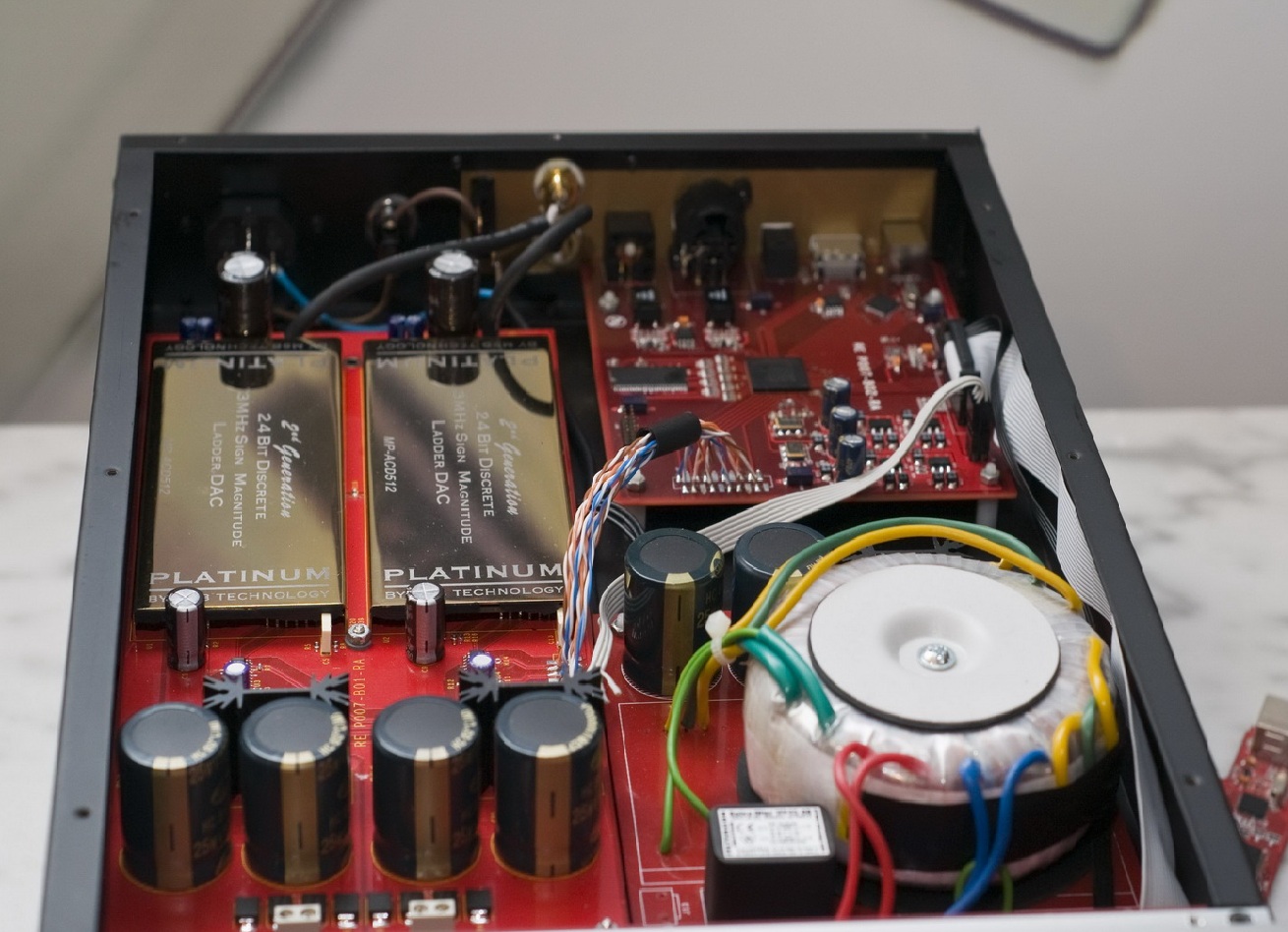

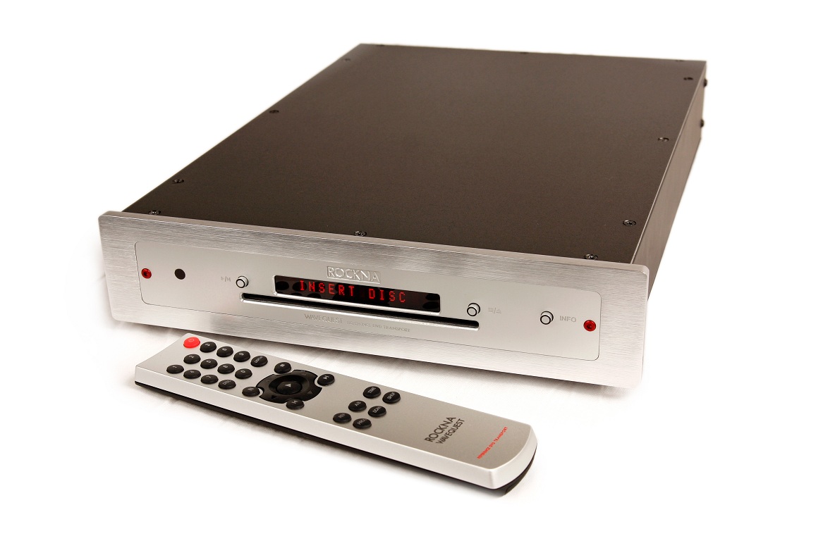

I use high-end music source consisting in Rockna WaveQuest transport and DAC. The transport is a special memory player, very similar to the PerfectWave from PS Audio. The digital to analog converter uses the discrete ladder module from MSB Technology . These babies need a real amp now...
