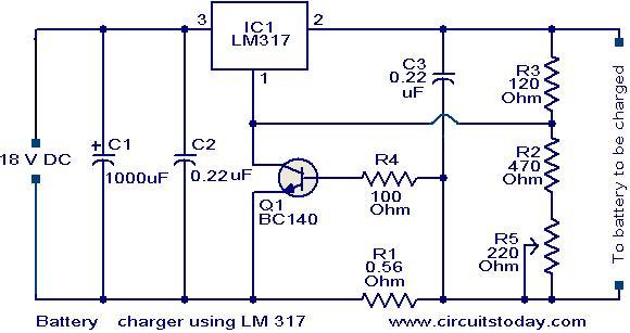

Hi there
I was using a LM317 and transistor
Battery charger circuit using LM317. - Electronic Circuits and Diagram-Electronics Projects and Design
There was a bit of difference in sound lost of focus and a bit of hier noise floor but it was an OP amp circuit so discrete may be different

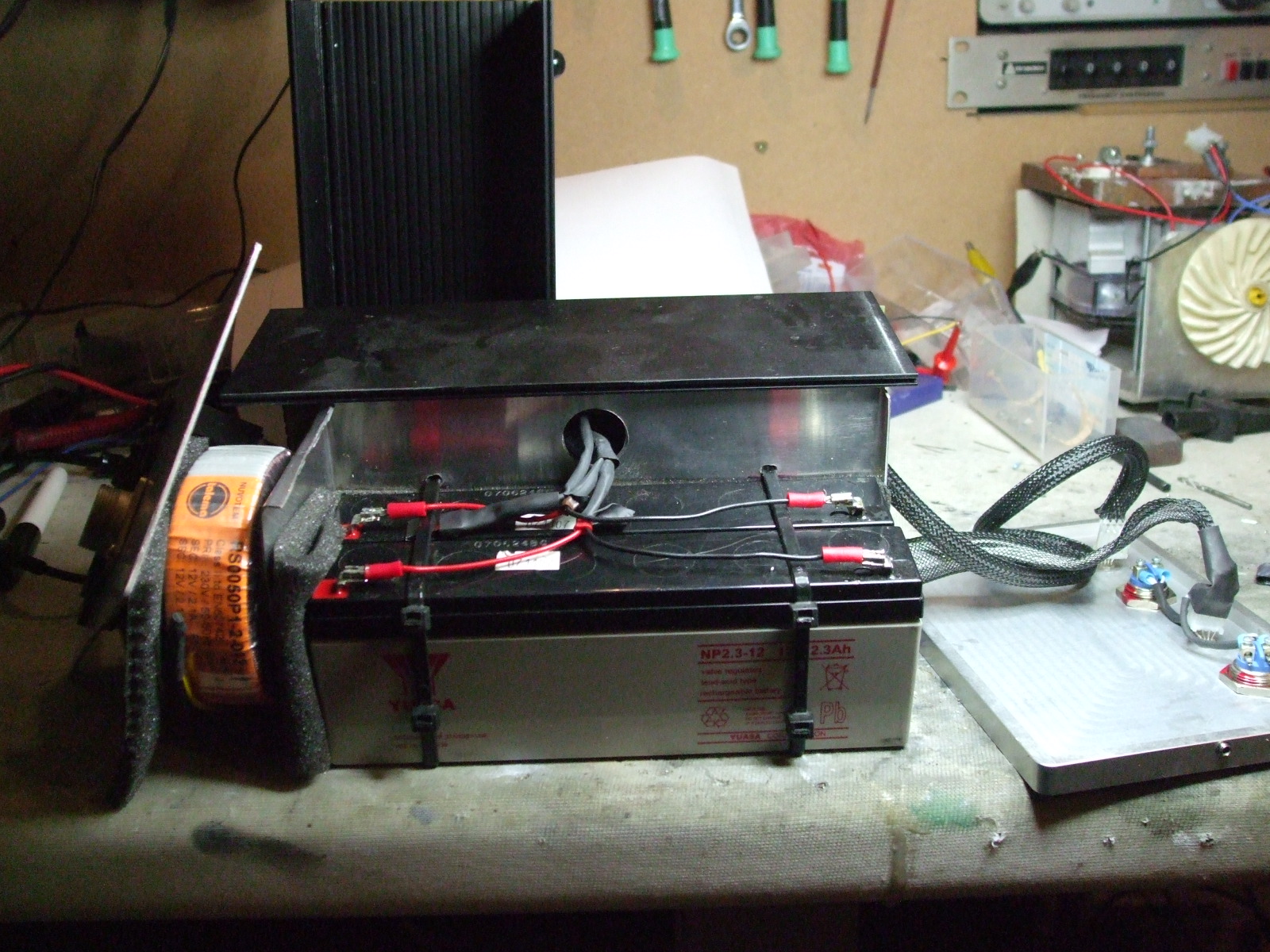

I had 2 X 2.1 AH cells for 24 V (nominal) and those lasted about 3 days while I was using just the cells.
Big help of bateries is that you are virtualy totaly disconected from the ground
so no hum from that side of things.
If you need 30 volts why not use 3 X 12 V cels and a decent regulator like Sallas Reflektor to get 30 V
The voltagge on the Cells changes from 13.5 (full charge) to 11.5 (dead cells)
as you such up the juce from them so a regulator is needed any way

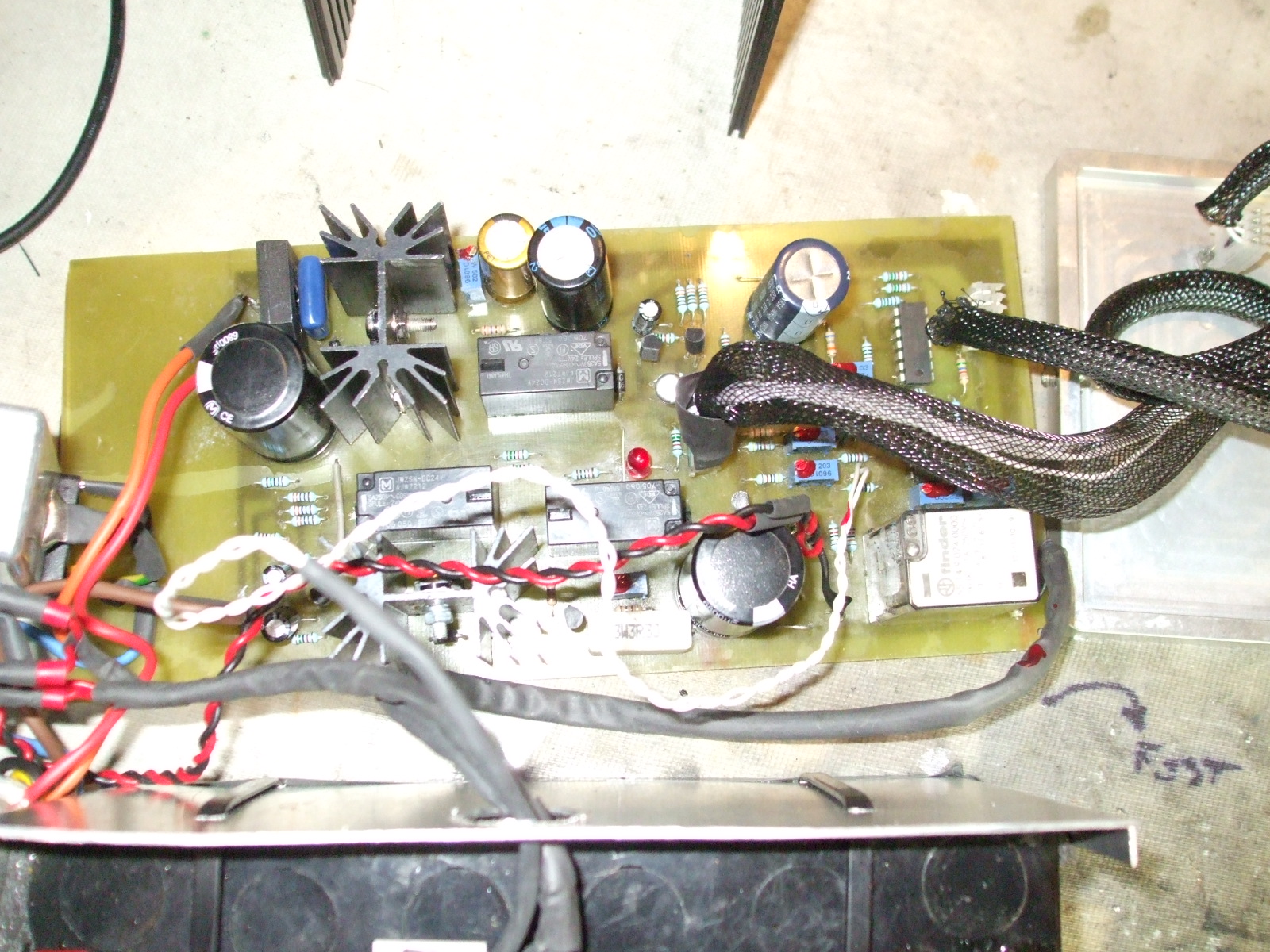

The Suply to my old MC stage in the pictures

I'm just building a XOno with batteries

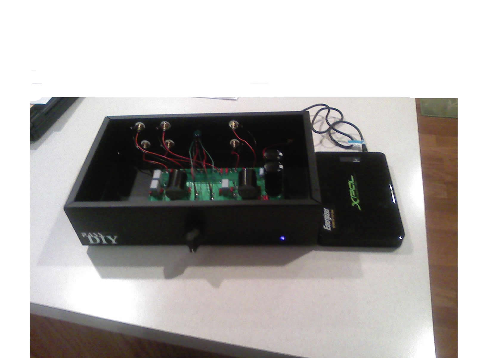

I'm running my Pass B1 on a battery. I charge it while listening when it gets low. Can't hear any difference. Of course I get lots of listening in between charges.
That is preaty nice now I want one to.
Old thread I know but what battery pack is that?
Energizer XPAL XP18000A
