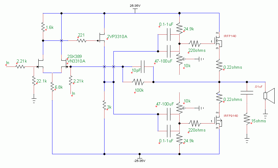

Pass JFET Op-amp to MOSFET Push-Pull Follower
I'm posting this for review. Here is a picture of the circuit I have been considering building. Basically the 2-stage JFET opamp from Pass's DIYOPAMP article to a push-pull follower power stage. I'm not sure if the JFET circuit will have enough voltage to drive the push-pull stage as drawn? Any errors or suggestion?
