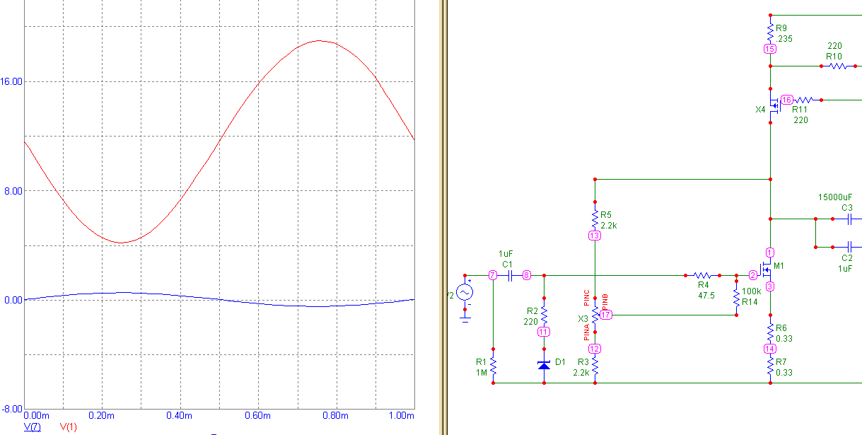

neg end of speaker is going to live output , pos end of speaker is going to cold output
so ........ really and still - nope
I think the speaker polarity is not of much concern.
Given the fact that F2 is common source, to me it is inverting.
http://www.passdiy.com/pdf/mos.pdf
So........yep. 🙂
So........yep. 🙂
By that argument, regular amplifiers usually phase invert
several times.
If you treat the red output terminal as + and the black output
terminal as - then the signal to the speaker is in phase with
the input.
several times.
the input.
I see. I simply looked at the amp, without taking the speaker polarity -which indeed can always be inverted- into account.
So, It is?
I have been using mine with Red to Black and Black to Red. From what Nelson says this seems to be correct.
