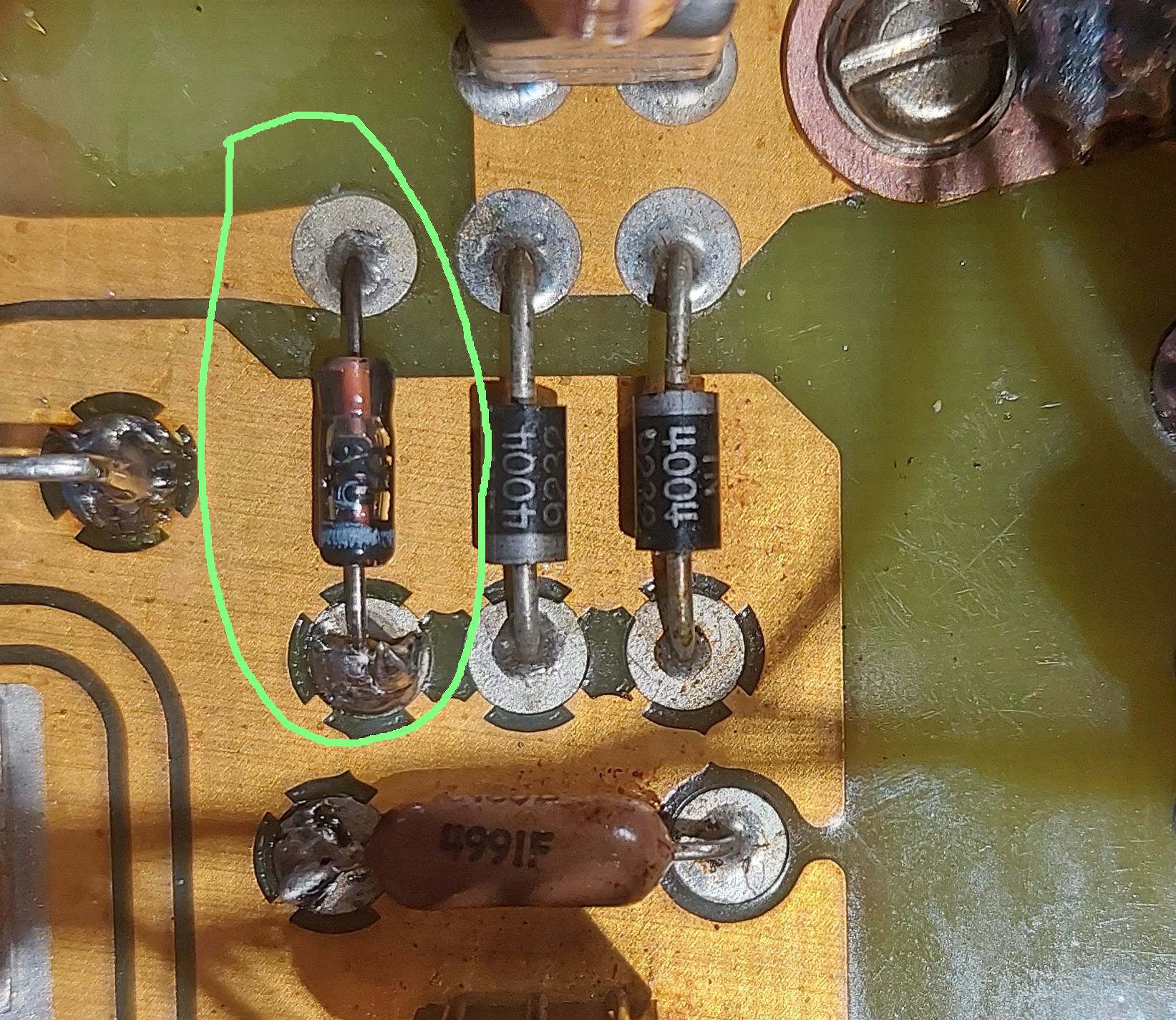

I am new to the hobby. Can the experts here help me to identify the diode/component "69A" highlighted in the attached photo?
It is in a linear power supply, sitting next to 2 IN4004s. I was doing some reflow yesterday and this thing suddenly turned transparent, because of the heat I presummed, and it horrified me.

I suspect there are more numbers hidden under it. As in something like 1N 52 69A. I suspect it is a zener diode. A 1N5269A would be an 87v 1/2 watt zener if my guess is right. It doesn't look clear to me, but it is a glass diode.
I would say Zener as well.
Does the supply still work correctly? If it does then measure the voltage across the part and see if that gives a clue. You might just have burned the paint off.
When soldering or reflowing something like these then using a small croc clip as a heat shunt clipped onto the component leg can give a lot of protection. Parts like that where there is a lot of copper around it need a lot of heat... a hot iron with a large tip and two or three seconds is all that is needed to reflow a joint like that.
It probably is OK, yes. Parts are pretty rugged and maximum junctions temperatures allowable are higher than you might think.
If circuit information was available we would be able to be more certain what it was but it really does look like a glass Zener.

Zener diodes can take a *lot* of heat before dying. The usual failure mode is for the diode to turn the PCB to charcoal or cause oxidation of the joint. I don’t see either happening here. Just one overheat event from a soldering iron won’t do anything to it. I burn my fingers with them when salvaging off PCBs all the time and they still work.
Working fine. Since it almost completely burned off the paintwork on the diode, the temp must have been high. I've seen many zener in clear glass shell. Haven't seen a painted one until this. Just by looking at the size next to a 1N4004, can you tell the power rating? Voltage difference is 14.8 from start to 15.8V.
Since it is likely a 15 volt zener (if they are damaged somehow, they go open or short - not change voltage), what part number is both 15 volt and has the numbers “69” in it? That would end up telling you the wattage. 22 volt is too far off, so that’s probably not it. Wouldn’t be a 1 watt, because those are 1N4744 and have a sharper knee (less voltage variation), and they’re bigger around and “stubby”.
