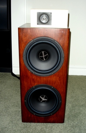

I too am looking for a bass driver to mate with these new Jordan speakers. I would like to find something around 5” so the overall enclosure size remains small. My goal is desktop speakers for my office with an active sub for the bottom end.
After building a couple of different sizes enclosures (4 liter and 2 liter) and listening to them in my office I am not so sure these little guys are up to the task. Regardless of enclosure size they sound hollow and don’t perform well near field. It could be a circuit of some sorts is needed, but I don’t have the means to figure this out.
Not wanting to give up on the JXR6, I unhooked my main setup today and mated the 2 liter enclosures to some stereo Vifa subs I built a while back. Here is a link to the Vifa driver http://www.madisound.com/cgi-bin/index.cgi?cart_id=7558976.2149&pid=1808 . I use a two channel pro amp and 4th order LR active crossovers to drive them. Rather then run the JXR6 full range I used the high pass on the active crossover to remove the lower LF, which allowed me to feed them more power. I played around with crossover points and like the 250 Hz to 350 Hz range the best. Note: From my experience this Vifa driver is able to play quite high. I was really surprised how well the JXR6 kept up with the 2 10” bass drivers per side and how well they filled my room. They image quite nicely and have good horizontal dispersion.
I think there may be something to this JXR6 after all. A two way monitor would be really nice and the suggested 7” Seas driver my just be the ticket.
The above success with the Vifa subs and my main listening room has somewhat restored faith that there may still be hope for my office PC speaker needs. I will do some listening with one sub in my office and see how well it performs. My concerned is the office setup will still require the higher JXR6 crossover point and my desk most likely is going to get in the way.
More to come… in the mean time, any other suggestions on small bass drivers would be greatly appreciated.
