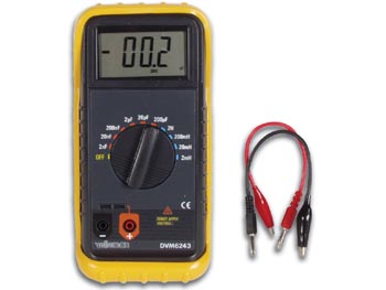

Westrock2000, if you need 1.36 mH and you can get 1.4 mH why bother? That is just a few percent off and accurate enough.
To get an accurate value, the best way is to buy a value to first higher value available. Then indeed trim it down by removing turns AND use an inductor-measuring device by trial and error until you get the value needed.
I am using this one and it works pretty well for LS crossovers:
I have no L meter. What about take a known capacitor with the unkbown inductance in series. Feed some sine from a signal generator in this, use a scope to look at the waveform. Turn sine generator frequency for lowest amplitude on scope screen . Read frequency on generator and calculate L ?
