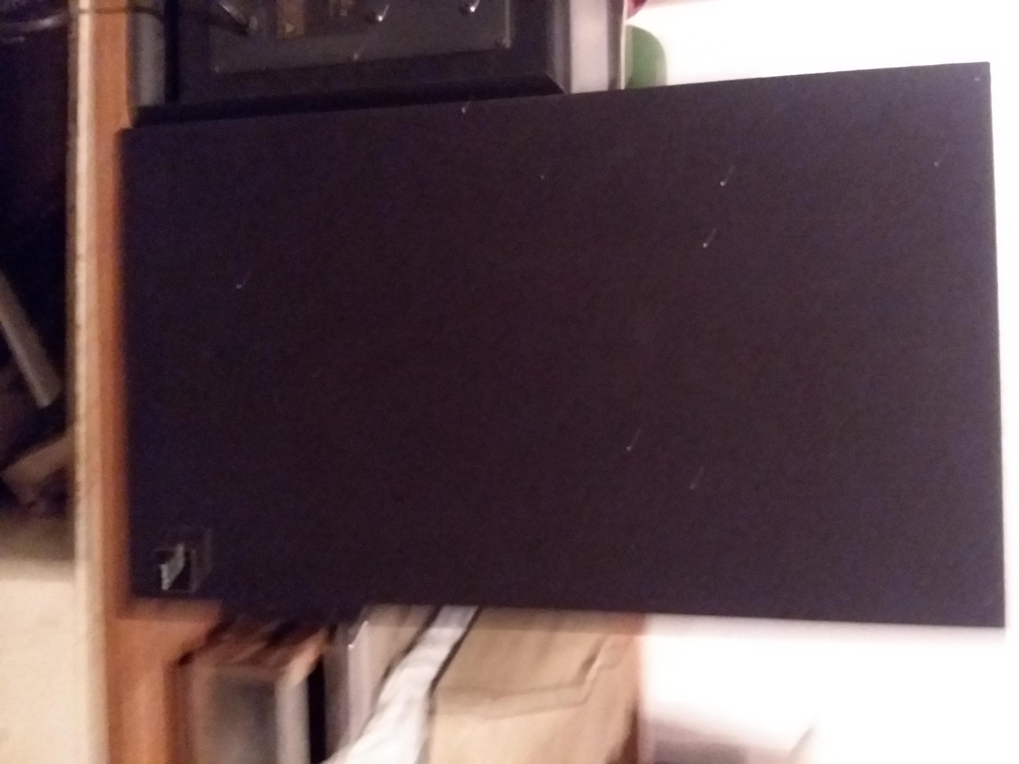

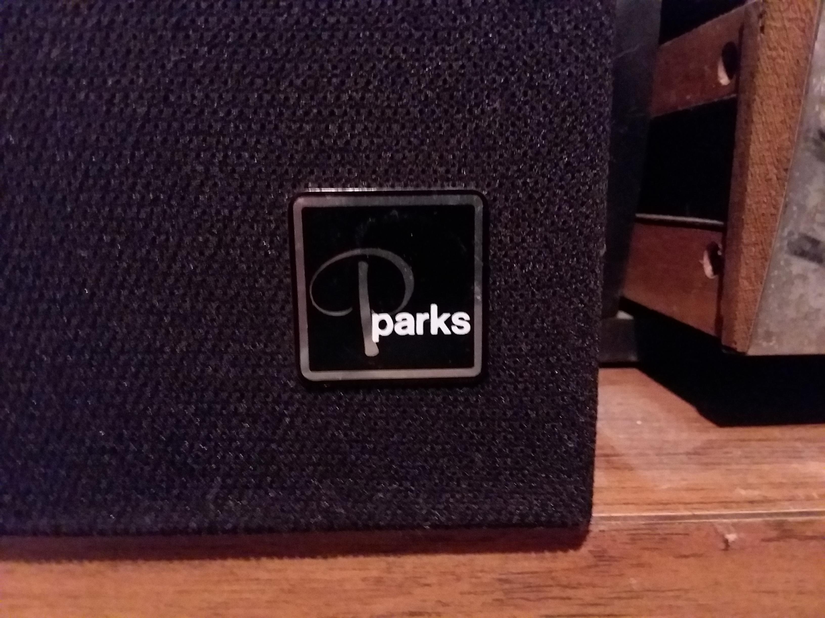

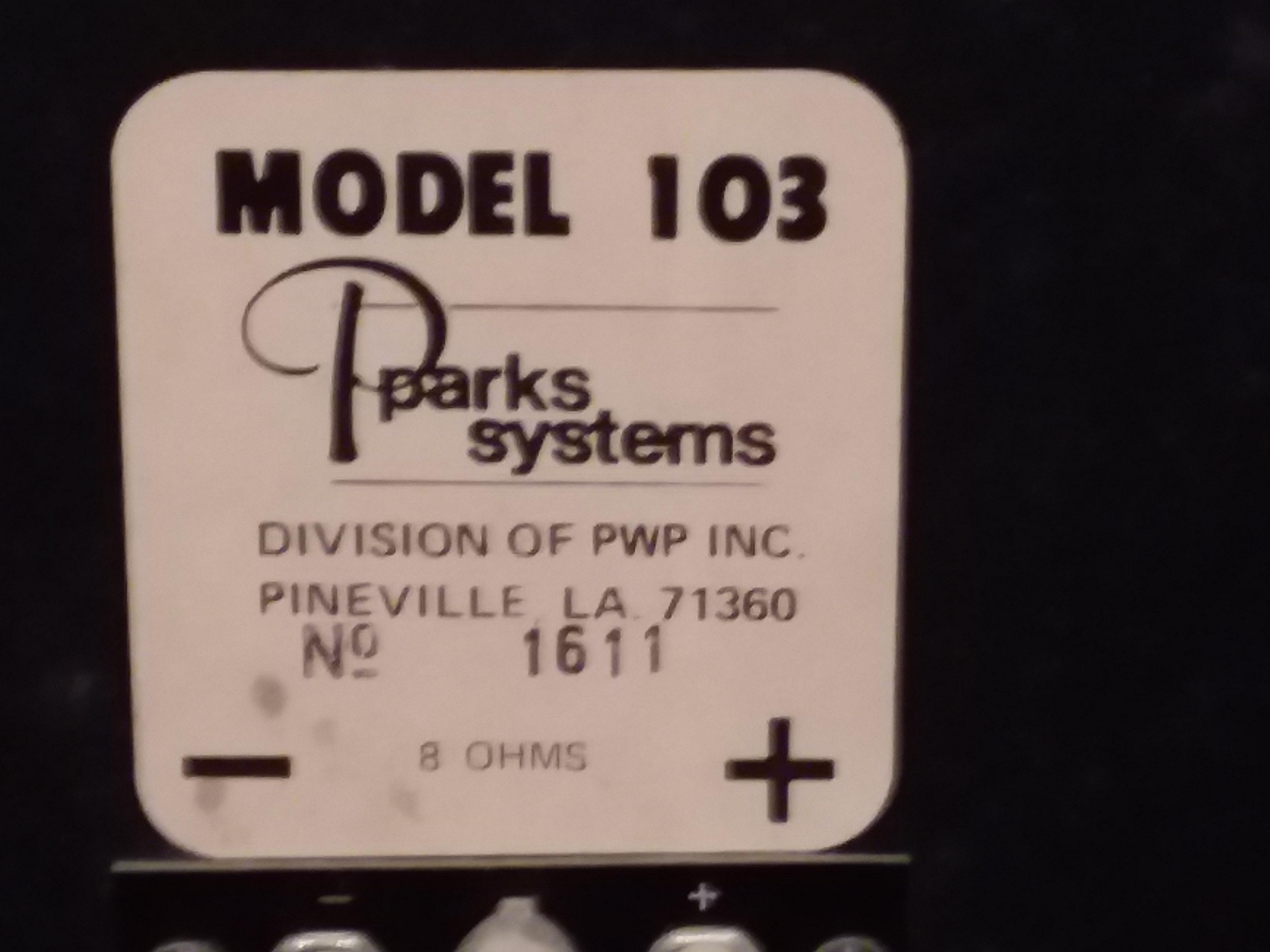

I bought a pair of these Parks Systems, bookshelf speakers at an estate sale, and I can't find any information, on them. There are model 103's, 8 ohms, serial #'s 1611, and 1695. The back of the speakers, says they were located in Pineville, LA, 71360, and that they are a division, of PWP INC.
They are a cone type 3-way, with a 2" tweeter, a 5" mid, and an 8" woofer.
Does anyone, have any knowledge, of these 103's?

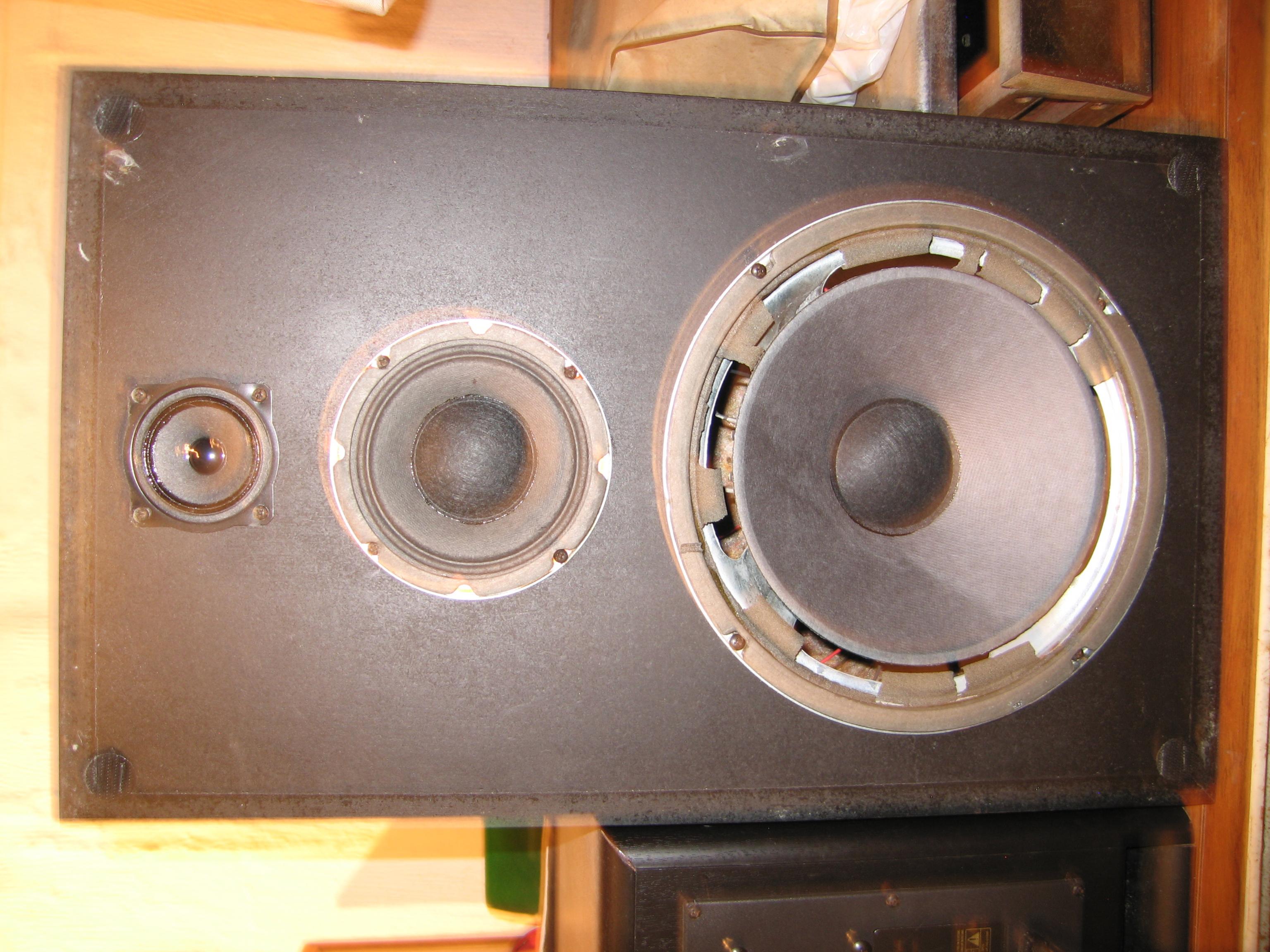

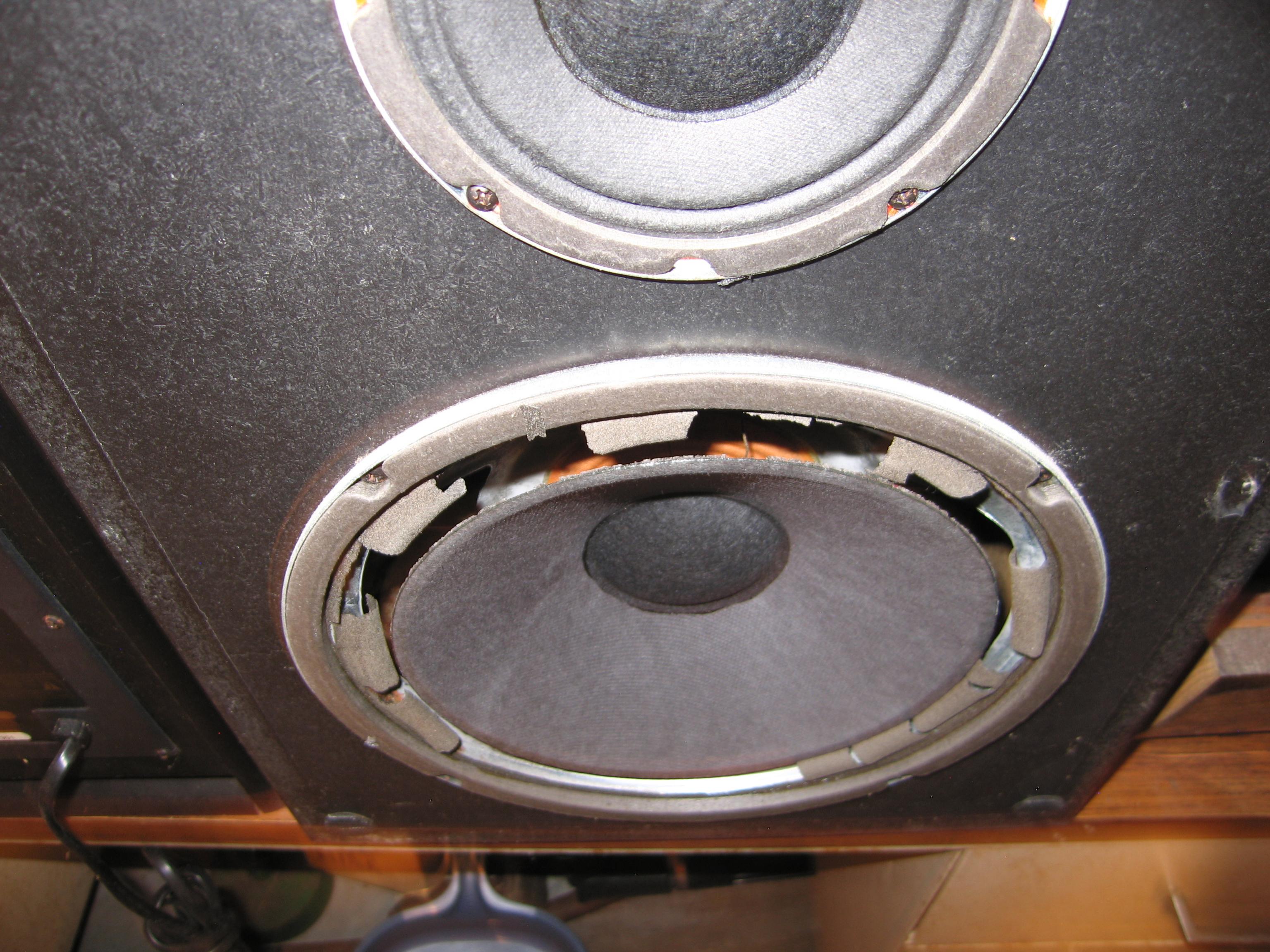

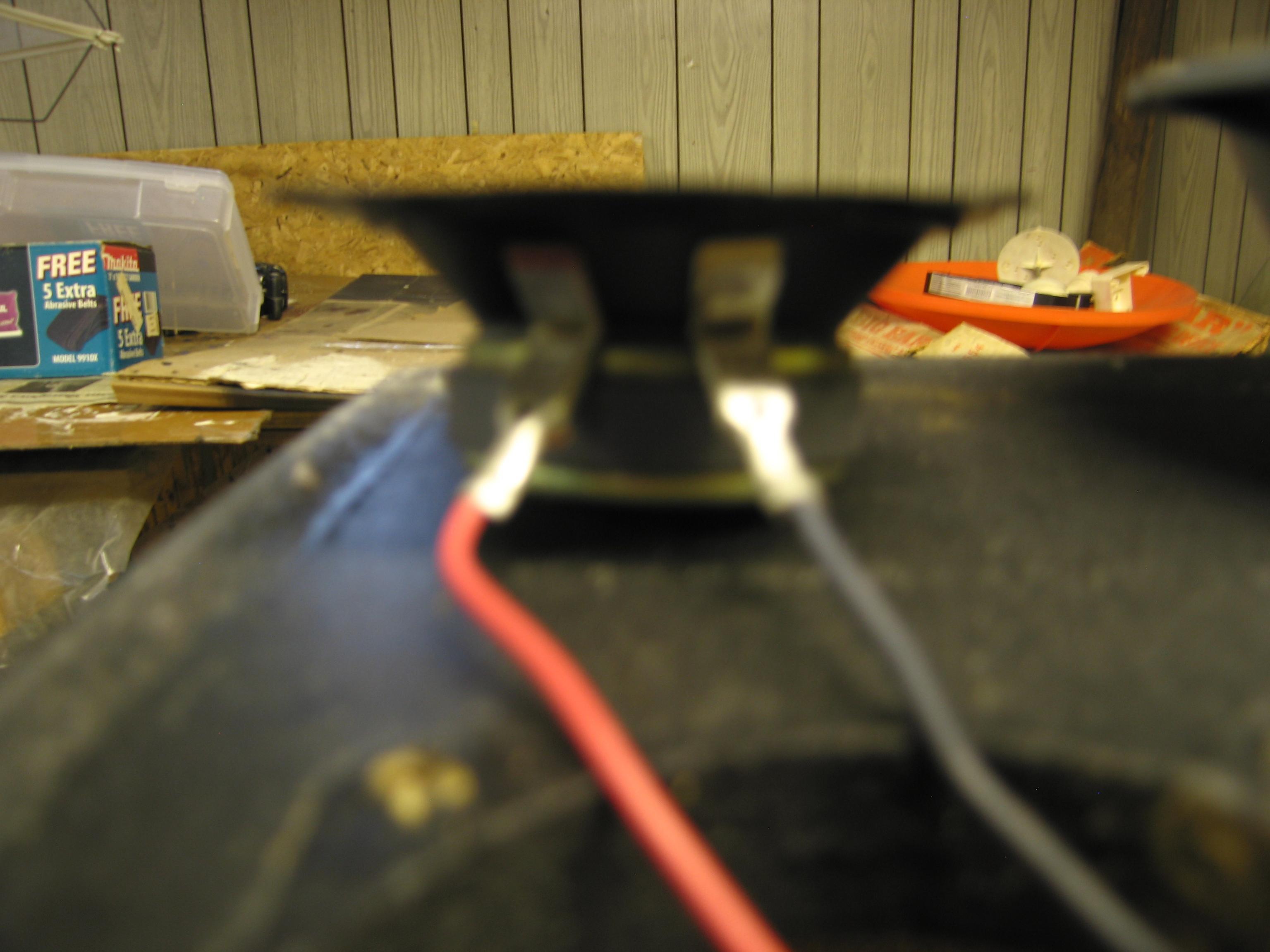

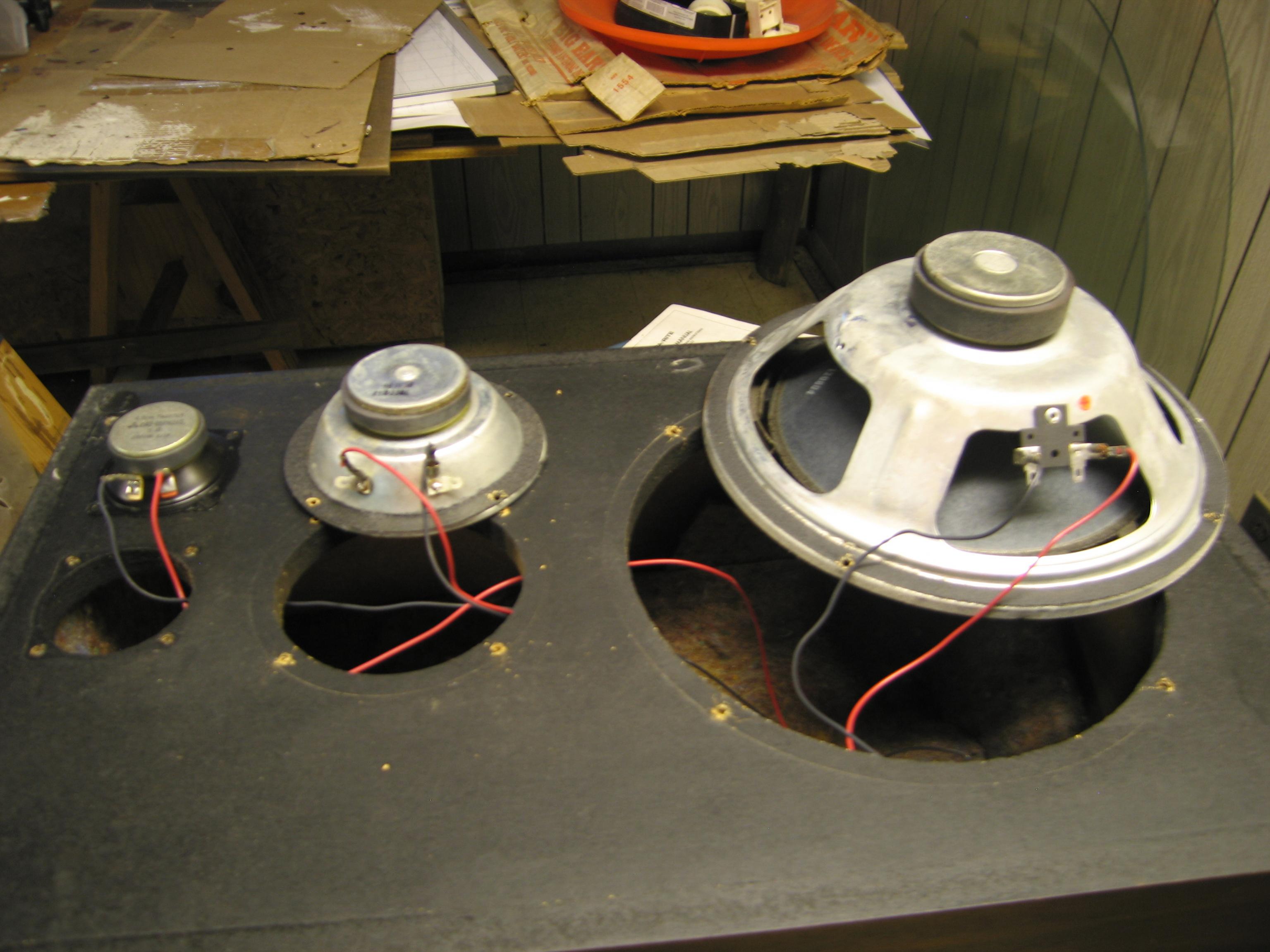

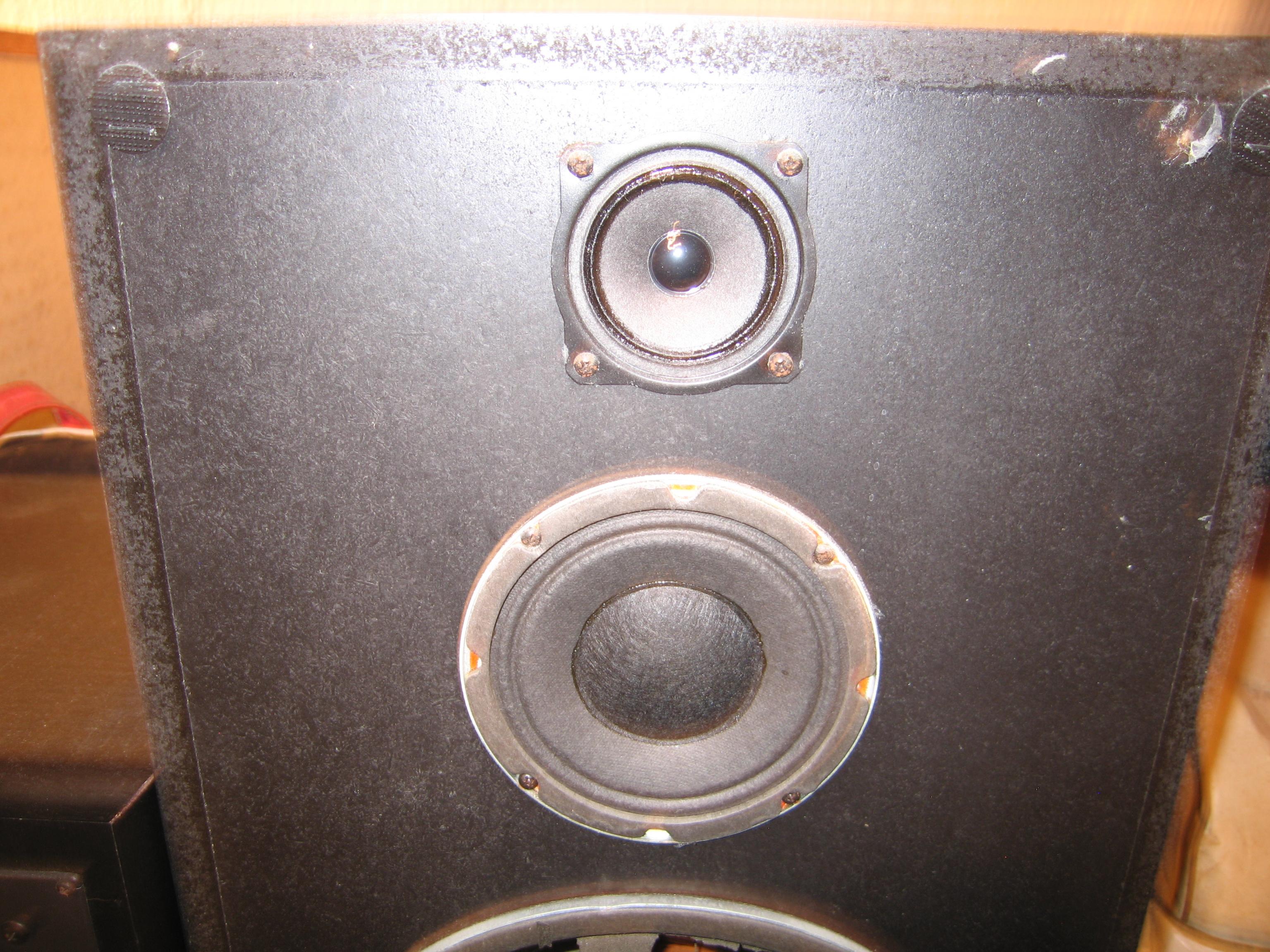

The foam, on the woofer, is gone. I'm trying to add pictures; however, I get this: please enter the url, of your image.
You can probably just refoam the existing woofers. Given their obscurity (probably a house brand of a long defunct local retailer) you will only find generic foam surrounds unless you can identify the maker of the woofer. (And maybe even then.)

Yeah, I reckon it would pay off to refoam the units and possibly redesign the crossover which is quite an undertaking. I have done something alike with some Aiwa's and the cabinet was subjected to a major facelift.

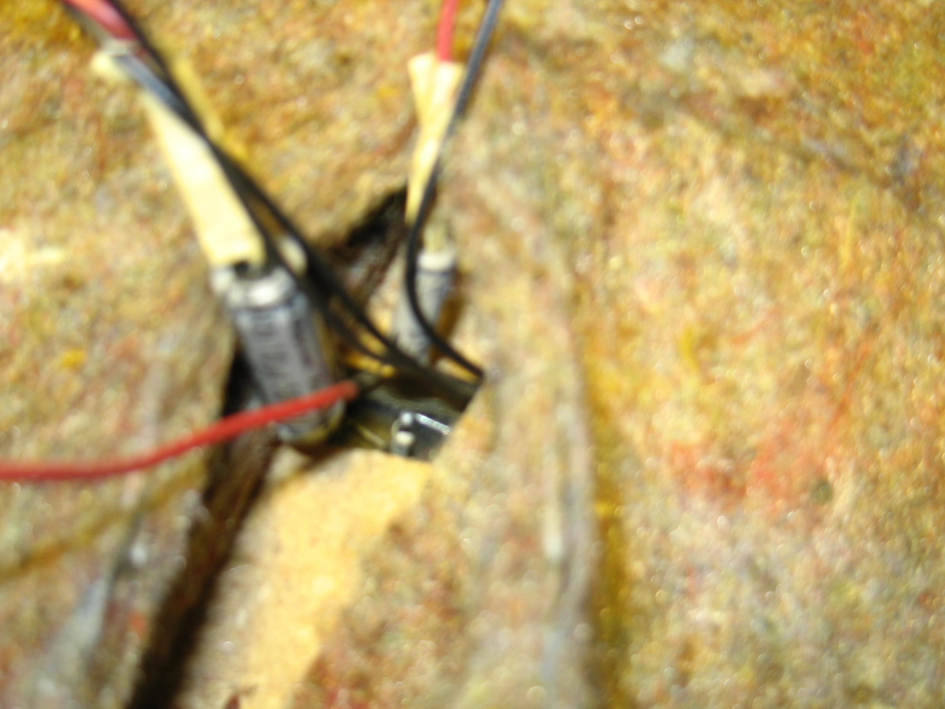

Can we see the crossover filter?

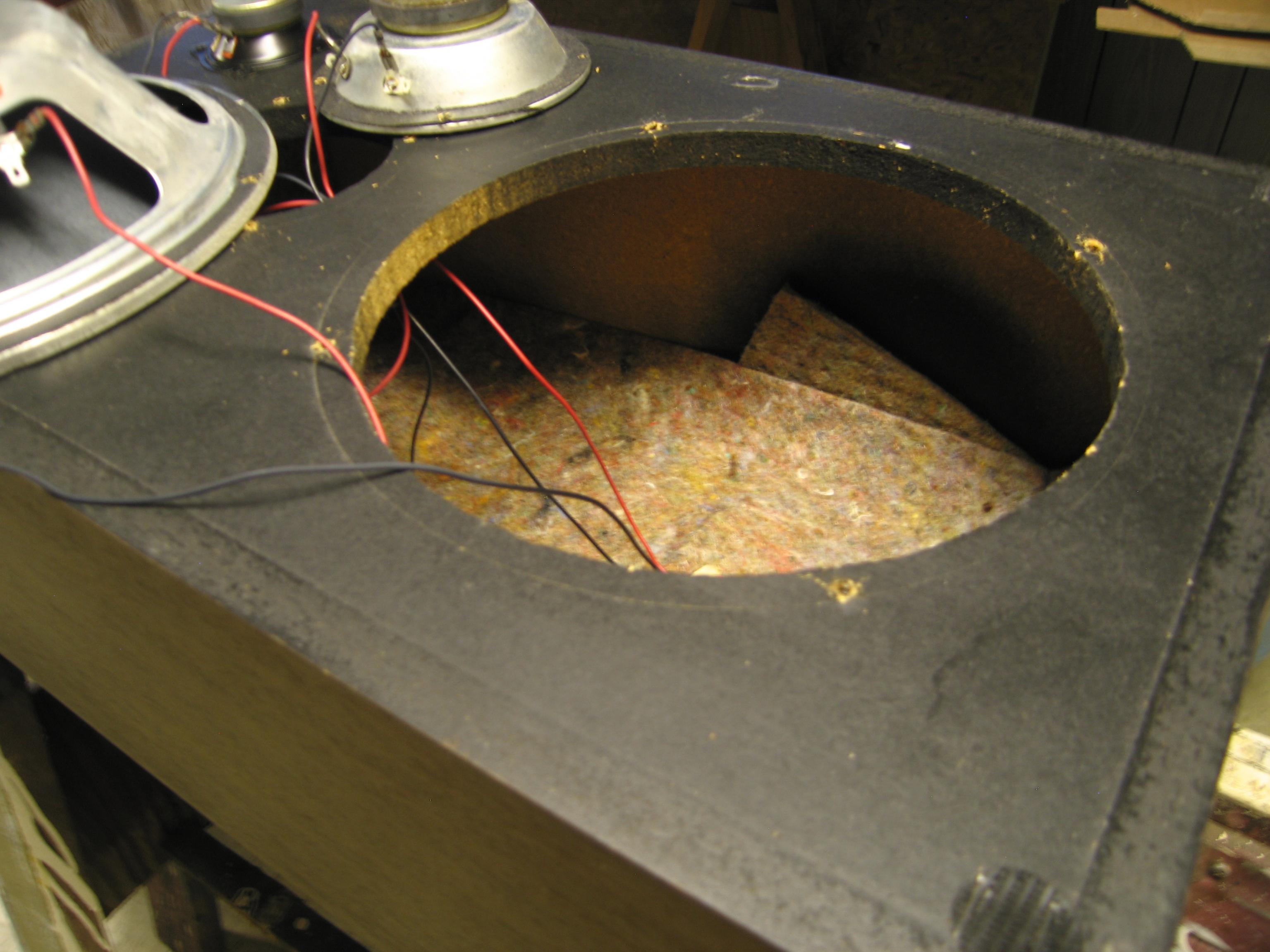

It's not much of a crossover. It's a 2.2uf cap, on the tweeter, and a 10uf cap, on the mid. The woofer, is full range. There's damping, in the enclosure, and they aren't bad. I'll probably buy new drivers, and crossovers.

Yes Bob, the drivers don't look anything special. Acting as a friendly voice, I caution you to make sure you definitely consider that the cabinets are worth repopulating.
Finding new drivers with the parameters to suit an existing cabinet is a major design challenge and not for the fainthearted. 🙂

Nonsense, the cabinets are worth the new pine veneer, some braces, new damping and pretty much stuffed for the woofer's Qts is in the 1.5 range. I would quickly turn this one into a keeper, provided new surround was attached properly. No offense lads!

From glimpses of the boxes and drivers, does look like low quality construction, parts, and materials. Had the surrounds been in good shape, would have been a bargain even if not great sound quality.

So what? I think they're cool, and I'm going to rebuild/update them! I'm going to start reusing, my knowledge in Electronics again. The enclosures, after some wax, and $200 for Parts Express' parts, will make these speakers, wonderful.
Absolutely! The suggestion, for braces, is very good. When I rebuild, and update them, your suggestion, will be used. At the very, very least, I'll keep these Parks Systems speakers working! And if the "experts and audiophiles" think this is heresy, visit the new thread, I'm starting about updating my Infinity speakers! Heresy!
