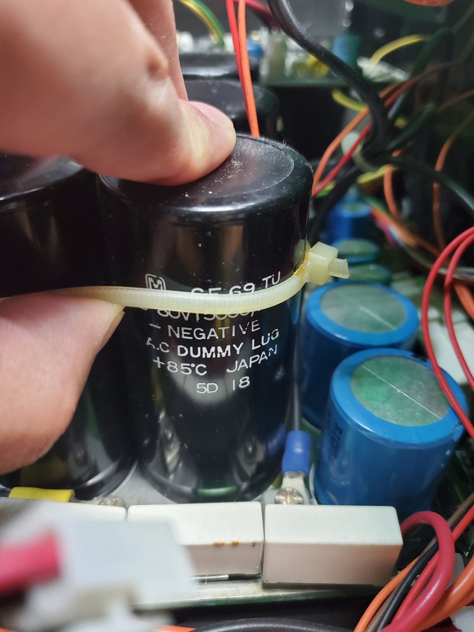

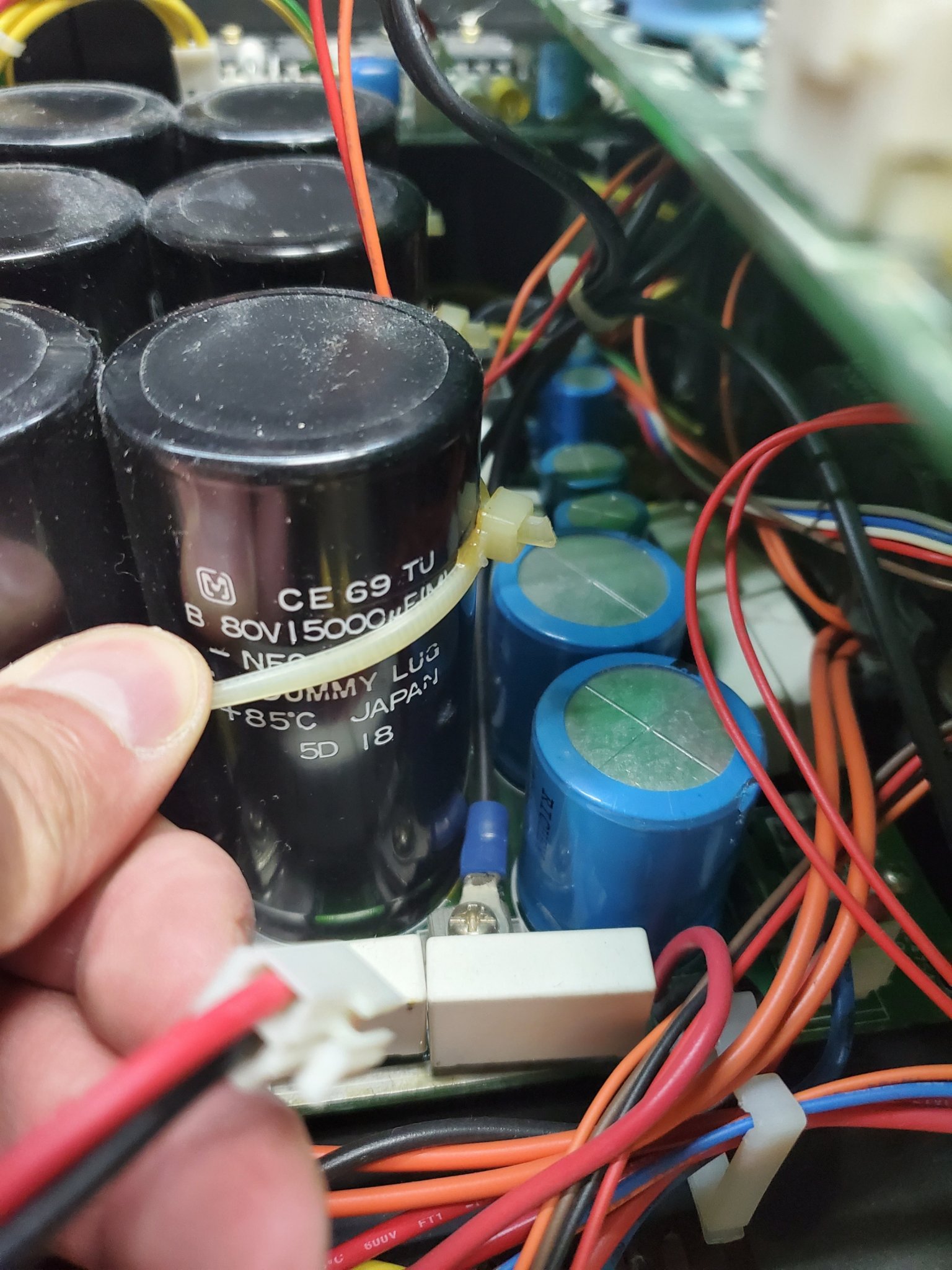

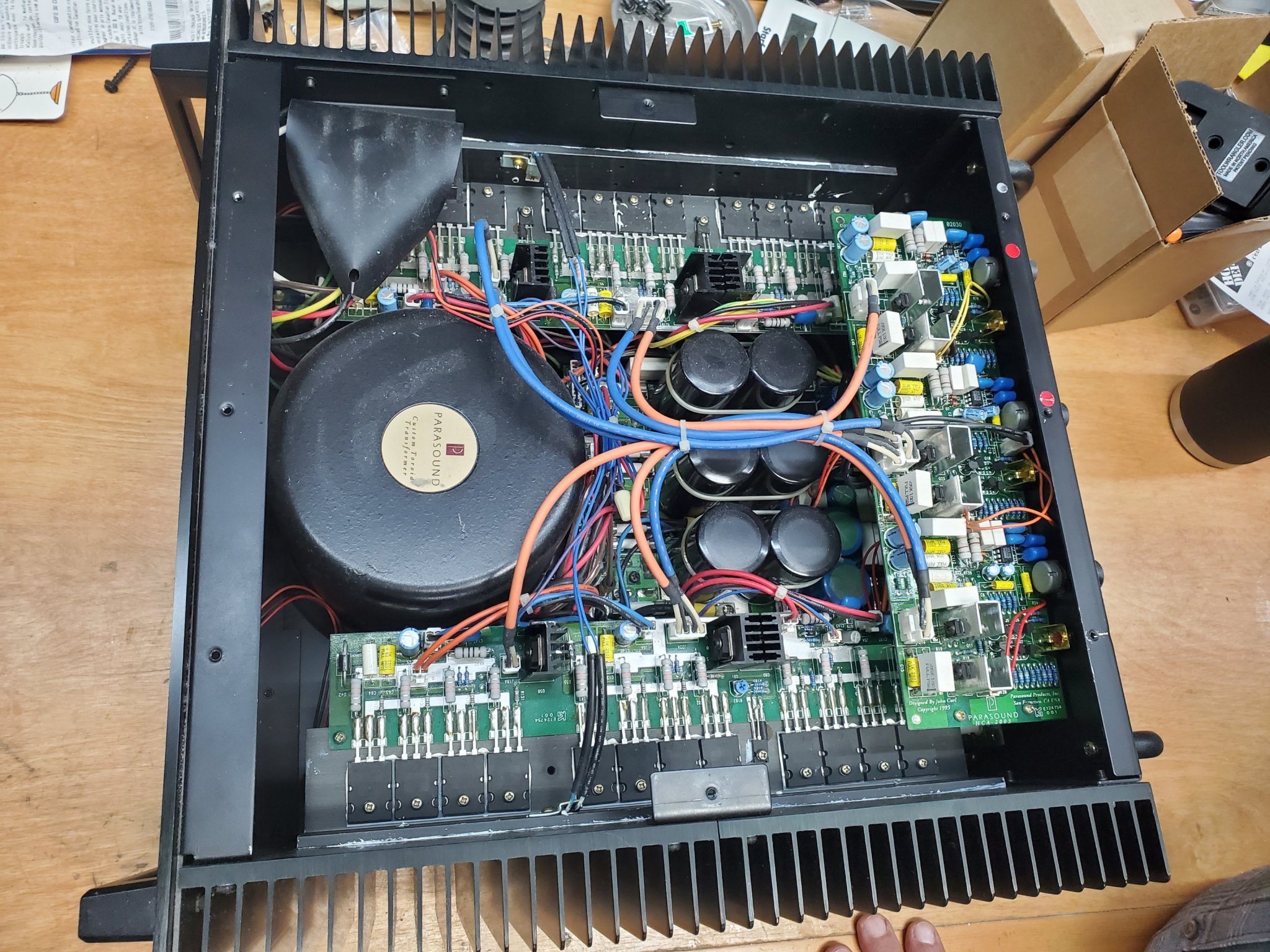

That being said, since I know how to solder, I opened up the amp and looked at the capacitor.
It seems to me they were made by Panasonic but I am not sure.
Which brand would recommend for a 80V 15,000µF?
At that stage, since I am not paying someone to do the job, I will put the money on the Cap, so whatever they cost is not an issue as long they are same or better than OEM.
Give me your recommendation.

Amps deteriorate both because of years on the shelf, and hours service life. Since these have been in storage, the best caps for these may be the caps already installed. Parasound was not a cost cutter brand. I would buy some 8 ohm resistors exceeding the wattage rating per channel of the amp. Hook them up on the speaker terminals with 16 ga wire or thicker. DON"T CAUSE A SHORT ON SPEAKER, THIS DAMAGES THE AMP. Then I would crank up the volume on a typical radio signal in, compressed pop/rock stations tend to run at maximum value all the time. Read the voltage out on the resistors with an Analog AC voltmeter, if you want true numbers. DVM not costing >$150 with an "RMS" rating up tend to lie about voltage on music frequencies. RMS DVmeters typically won't see signals above 7000 hz and thus are useless for detecting ultrasonic oscillation, so I never bought one.
P=(V^2)/Z where P is rated per channel power and Z is speaker impedance (or resistor in this case). I've found $25-30 analog VOM to be adequate for this test. You can check dc volts calibration with a zener diode purchased from a major parts house.
If amp performs to the specification, I would leave it alone. If caps are dried up, the amp tends to sound polite, with no peaks as are common in romantic era classical music. Pop/rock, you can't tell till the amp goes silent.
I rebuild geriatric amps & electric organs. I use Panasonic, rubicon, nichicon, vishay, or kemet brand caps. All these brands make a 500 hour or 1000 hour service life cap for those that wish to repair a unit as cheaply as possible. These are widely stocked and come up on the selector table first since they are cheapest. An amp can accrue 1000 hours in less than a year. Yes, lower temperatures will extend the actual life versus the rating, but I start out with the cap with the longest service life I can buy in a package that will fit in the space available. I had to re-e-cap one amp 4 times in 50 years when the only caps I could buy were the ones in the bins out front of the local TV parts store. Now that pro warehouses will sell to individuals with a debit card and no stupid questions, I typically buy 3000 hours up caps, although I have installed some 12000 hour caps. Extended temperature rating multiplies the quoted number by some unknown value. Don't expect a pro warehouse to answer a lot of newby questions on the phone. Look up your parts on-line.
Beware the selector function on hours service life, some software count a 300 hour cap as longer life than a 1000 hour cap. I inspect the life category individually. Size dimensions & rated voltage & value, the tables get those right.
If I couldn't get the big 5 cap brands, I have used CDE & united Chemicon. These brands typically come from a country known for lying on QA paperwork, and if you look at the datasheet, their numbers tend to have a higher ripple value at end of life than the reliable 5. None of the caps I've bought from them has caused problems. But my 14 hour a day amp (FM radio) has caps from the big 5.
Reactions: Manyakus
This is a good read. Without testing and just replacing parts just because someone else said to is a waste of time. Parasound used great components, and I would think that if you want to tweak or freshen up the amplifier the first investment should be some good test instruments. DMM, oscilloscope. Good luck with your project. I always liked the Parasound HCA series.
Just having a look at your pics, concur, they didn't cheap out. Replacing the large filter caps, unsure that would be worth it, and almost everything else are film caps which look great and don't deteriorate. Tweak, that's another subject; I see a few electrolytics I might swap out if I had to satisify an urge to do something, may add a marginal improvement overall but not night and day. I'm a big wire guy, one of the things I'd look for is replacing internal wiring with silver - but at that point you're in the tweak end of the spectrum, not maintenance. Repair shops most likely don't tweak anything and probably charge you way too much to replace the few electrolytics you have - there is a case to be made to just leave it..
