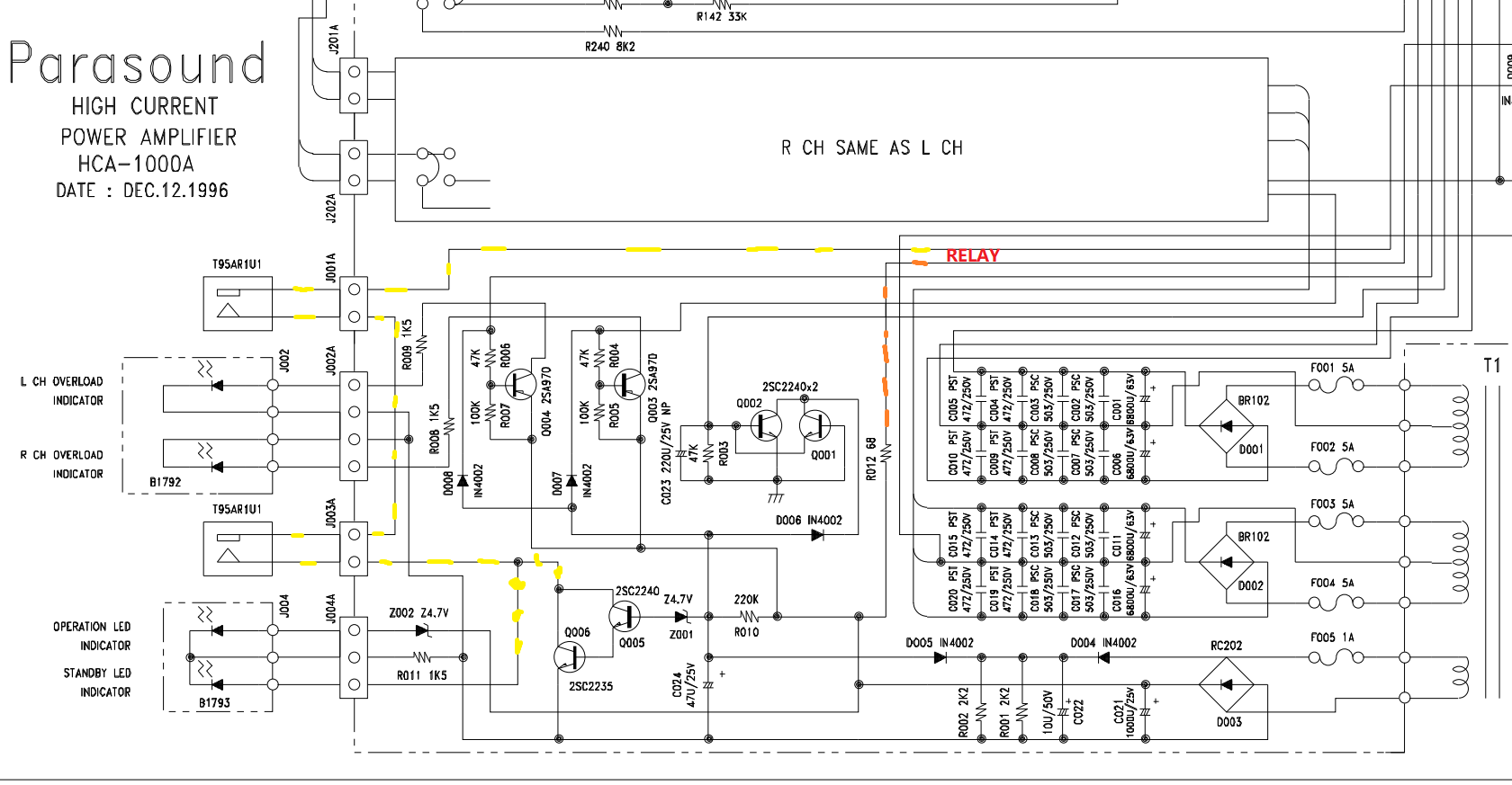

The manual is right. HCA1000A is a DC coupled power amp. It does have DC servo circuit capable of nulling the input DC offset, but only to a certain level. Beyond that level, the standby LED would light up. Further beyond and the speaker relay would disengage to protect the speakers.
First keep the pre-amp connected and sweep the volume knobs in the back of the amp between all the way up and all the way down and see if that would make difference to the stand-by indicator. Doing that would confirm/rule-out DC offset at the input, in other words a faulty pre-amp. If you have a multimeter, measure between the speaker terminals for DC voltage. Should read within a few mV.
If that doesn't fly the next best place to dig would be the speaker protection relay circuit. The relay is driven by the compound transistor(Q005/Q006). When the compound transistor turns hard on (normal operation mode) it shunts the cold side of relay coil to GND to close the relay driving circuit, and by doing that, it also turns off the stand-by LED.
When somehow the compound transistor turns on but not quite hard on, you'd get a illuminated stand-by LED AND a speaker relay that remains engaged. A marginal DC offset at the amp output could do that, a half-way faulty/degraded capacitor C022 could do that too.

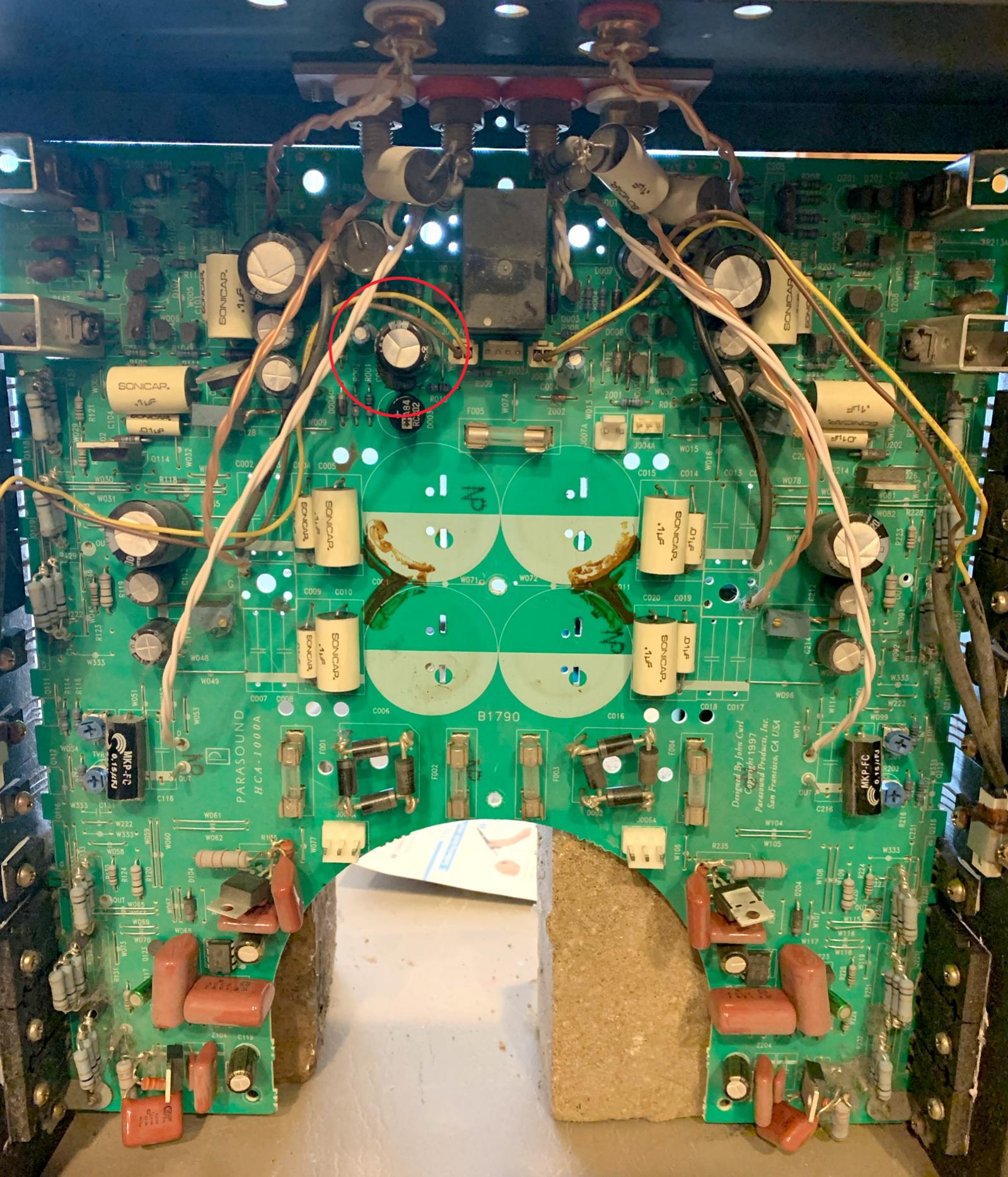

Thanks, nattawa for your reply, I really appreciate it. This amp was modified about 10 years ago by a guy named Steve Sank and it's worked flawlessly since. The mod included removing the volume pots, loop out and bridge mode/switch, so it's now just a standard power amp. So I will try measuring between the speaker terminals for DC voltage.
In regard to your second thought, Attached is a photo of this amp taken when I was replacing the four large 63v/10,000uf filter caps earlier this year. I don't have the amp open at the moment, but I believe the cap circled in red is CO22, isn't it? Are you able to tell by referring to the schematic?

There are two capacitors in that red circle, a big black shiny one in the middle and a small blueish dusty one to the north-west-west. The small blueish dusty one appears to be C022. And yes, do take a DC voltage reading at output, with and without the preamp interconnected.

I really appreciate you taking the time to help. I pulled the amp and opened it up and verified that CO22 is in fact the little blueish cap.

C022 is one of the plausible causes independent of DC offset at the amp output, but given the known conditions of the amp as far it seems a lot less likely to be the problem. To answer your question, no, C022 will not fix the DC offset. C022 is part of the power loss detection circuit that serves to quickly disengage the speaker relay before the main power supply rails collapse, by the way.
