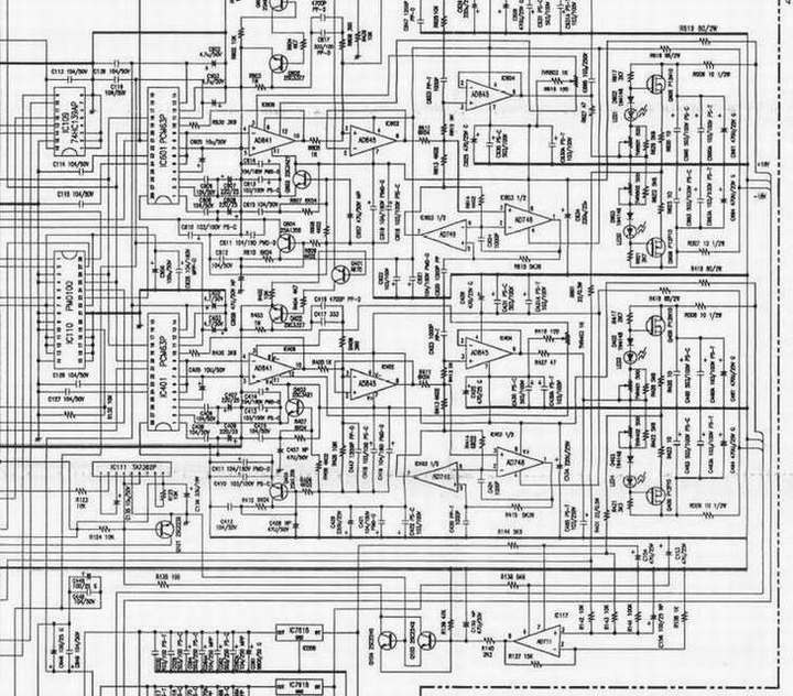

broken DAC1600
maybe there are some experts of the DAC 1600 out there who have the schematic.
I have the schematic, but I think it is impossible to load iut here.
I have a proplem in the output section of one channel. The LED doesn't light up (it is LED3 in the schematic) And there is no voltage on one of the output fet's (Q405). I think Q405 is broken.
My question is: Can I change Q405 (it is a P12N10) or do I then have a missmatch with the complymentary one so there would be an dc offset on the output. And is it possible to to trimm the dc with one of the trimmpoti's around Q405 and the complymentary one ore do I have to change the complemantary one to?
I know some stupid question, but answers will help a lot.
I asked because I want to know if it is worth trying to get an P12N10.
Thanks,
Dirk

thumb said:this is what I have
🙂 thank You very much! I have full sheme DAC 1500, if need.... 🙄
