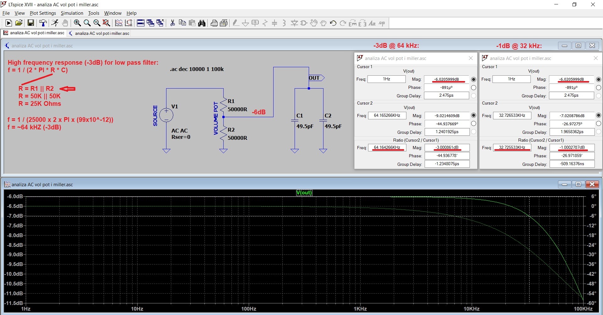

Thank you very much for expert advices 🙂
I have analyzed this point and I get different results :/ (see the picture below...)
High frequency response (-3dB) formula for low pass filter is: f = 1 / (2 * PI * R *C)
But... R is like a parallel combination of the volume pot voltage divider resistors, so:
R = R1 || R2
R = 50 kOhm || 50 kOhm
R = 25 kOhm
Both the simulation in LTSpice and the calculation shows the result:
-1dB @ 32kHz
-3dB @ 64kHz
Did i miss something? :/
- I assume that the source impedance is low (~100 Ohms), which I will ignore in further calculations
- I assume one triode Miller effect is 49.5pF
- I set the volume pot to -6dB, dividing 100 kOhms into 50 kOhms and 50 kOhms
R = R1 || R2
R = 25 kOhm
-1dB @ 32kHz
-3dB @ 64kHz

Ideally, the grid stopper should be as close to the tube as possible. Tie them to the tube socket is common practice. The volume pot is not a substitute for an actual grid stopper resistor. Use a high quality volume pot because if the wiper lifts off the conductive element you will have problems as your tube is no longer referenced to ground! You can always put a 1 Meg resistor in parallel with the pot as cheap insurance.
tuberabbit,
Correct. 25k driving the Parallel E88CC Grids. (I mistakenly said 50K).
Parallel connection of two E88CC RF triodes:
You have an RF path from one cathode, to a wire, to a capacitor, to a ground wire, to another capacitor, to the 2nd cathode.
Keep the wiring short, all of that wiring and capacitors is an RF inductor.
You have a wire from one grid to the other grid. Keep it short, it is an RF inductor.
You have a wire from one plate to the other plate. Keep it short, it is an RF inductor.
Each of the grids, cathodes, and plates have capacitance to each other (Which is why some of those dual triodes have a shield between the triodes).
But in each triode, all 3 elements have capacitance to each other.
Parasitic inductance and parasitic capacitance sometimes makes an otherwise simple tube circuit oscillate.
I study various forms of RF oscillators, including the Butler oscillator, and the Colpitts oscillator.
Your parallel E88CC might just want to oscillate.
I used a 12AY7 in parallel, each cathode had its own bias resistor and bypass capacitor, each grid had its own grid stopper, and the plates were tied together.
It oscillated.
Even though each grid had its own individual grid stopper, I had to put a 1k resistor from each plate, and connect the other end of the 1k resistors together to the plate load.
That fixed the problem.
your mileage may vary
Thank you for the very detailed explanation.
So, I'll put the grid stoppers, as close as possible to the socket pins of the tubes and use a high quality volume pot.
