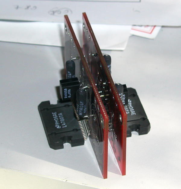

I am paralleling 2 LM4780 chips per channel fo my amp.
I have the power wired, but I am unsure of how to wire the signal paths. Both IN AND OUT.
I have ideas but thought I better ask before I see that magic black smoke!!LOL
Do I just run the + signal to one chip and the - to the other and then the corresponding polarity to the output jack?
*A diagram would be nice*
I am using the kits from audiosector.com.
Thanks a ton,
Dominick

In order to parallel two parallel configured LM4780 chips, the best way it to position the boards back to back. This will simplify ground connections.
For both boards, you connect together: OG, SG, //OUT and IN. It's better to use two R4 resistors (one per board), however they will be in parallel and this will lower input impedance to 10K (this will also produce much less DC offset). Alternatively, you can substitude 22K resistors with 40K resistors, for 20K total shunt input impedance.
Everything else is configured the same as per schematic for parallel setup here: http://www.audiosector.com/lm4780 amp.pdf
PS wires cannot be connected with short jumpers (between two boards) as their access pads are not symetrical , you need to use longer pieces of wire. Both grounds connections (for two boards) can be as short as space between the boards ( as the pads are symetrical here).

I just tested each board seperatly and they are producing an audio signal to the speaker although with a very slight hum.
The wierd thing is that on one board, the chip never even warms up??
But both boards play?? The other chip gets warm regardless of the board with the audi signal??
Wierd huh?
IDEAS?
Dominick
