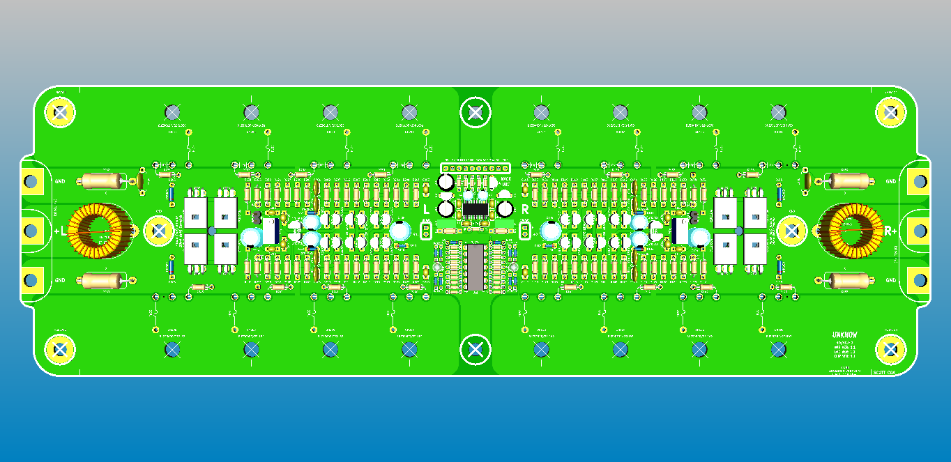

I should clarify that I am now planning on using 4 pairs of single die per channel. I hadn't mentioned that I was referring per channel.
There is the potential to mount the devices directly to the heatsink, however I usually mount it well to the chassis.
Schematic and board files attached.

I've updated the components in the OPS schematic, yet, I know in some designs like Rod Elliot, he uses no gate capacitance compensation on the P channel. Is negligible? Omit-able? Perhaps I'll just test and experiment with the gate stopper resistor. Trying to keep it clean. In my PCB design, i've about maximized and minimized each lead and trace, minimizing any possible errors or need for compensations.
For the gate protection, I've used diode and zener diode values based on some other schematics found, are these trivial? I've never used this strategy before.
The fuses on each device are not for protection beyond individual device failure. I've considered leaving those out as well.
