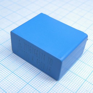

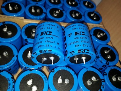

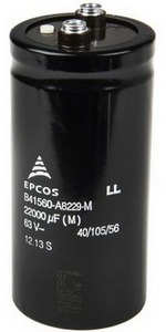

I'm building an amplifier. Dual mono. Separate transformers (500VA, 8A) per channel, output stage supply voltage - 40V.
I want to organize the capacitors in the power supply as follows:
First (one channel) there are four 22000uF capacitors next to the transformer, then on the printed circuit board five centimeters from the output transistors there will be two low-impedance ones at 4700uF, and at the very collectors of the output transistors - 10uF per transistor (6 pieces in total - 60uF) - polypropylene .
Tell me, how successful will such a bunch be?
