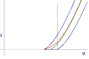

There is more, Casey. And there is a precise physical reason.
Whether you have multiple tubes in parallel in a single envelope,
or in multiple envelops, you still end up with a single set of
average chatacteristics,
It is not so. Paralleling tubes does not give us tubes with averaged
characteristics but a different animal. I'll try to explain why.
Suppose to have two tubes (triodes) which perfectly adhere to the Child's law
but with different gain, for instance.
Now, immagine the tubes being completely paralleled. Suppose one tube
has a gain of 3 and the other a gain of 4, for example, and suppose
that the currents of the two triodes are the same for vg= 0 Volt.
Then, for a given value of grid voltage, say -20 Volt, the tubes
will have different currents and, if we change the anode to cathode
voltage, different anodic curves.
If we make an orizzontal average of the curves we end with a
curve with average characteristic, that is average gain in
this case.
But the action of paralleling tubes make a vertical average, since
the total current is the sum of the current of each tube.
so we end with a curve with the following equation
i=k[V+m1*vg]^1.5+ k[V+m2*vg]^1.5
and this is not the Child law.
But..., maybe it is a better one..not so.
It will result clear from the following graph.
You can see the curve corresponding to
m=3 and m=4 ( in blue)
the orizzontal average (green) that has m=3.5
and the the vertical average (red)
which appears very distorted in the small current region.
in this region, in fact, the mean is done betweeen only
one curve and the zero line (because one tube is OFF).
So, paralleled tubes have anodic curves different from
single tube. In particular, the curves result more
distorted in the region of small currents.
Note that it is a geometrical effect, it is not important
that the law is the Child's one. Only in case of
a linear device the orizzontal and vertical average will coincide,
and only at high currents.
I don't know if it is the cause of sound difference nor if this is a good explanation. surely, it is a possible explanation.
bye
Federico

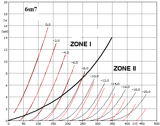

You are completely right, Dave. And no, I do not miss
that idea. I left it for this post...
Have you never asked to yourself why, in the small current
region, the anodic curves of the triode diverge from the
child law? The cause is, for the main part, the
phenomenon described by you.
Many are the reasons, for the most technological, that produce
differences between predicted and actual behavior of a triode:
the not uniform distribution of temperature of the cathode, chiefly in
direct heated tubes, the less than perfectly uniform step of the grid
spiral, in signal triodes, and in general, all those differences
between ideal and real geometry that cause a one-dimensional
idealized structure, like the Child’s one, to diverge from the complex
three-dimensional reality of a triode.
Now, think at the electronic flow (or the current) existing
between anode and cathode as the sum of elementary flows
standing in zones characterized by slightly different values of
the properties (say gain, for instance). The total current will
result from the integral of these contributions.
The effect is of the same kind, but more smoothed, of that
described in my previous post (one can see it in the attached
picture).
The models proposed during the years by some researchers
represent an attempt to mathematically describe the phenomenon.
Unfortunately they (Koren's one, etc.) are not based on physical considerations so often resulting in a great number of parameters.
Bye
Federico
Fitting of Child’s low (6SN7 curves from
http://www.audiomatica.com/tubes/6sn7.htm )
