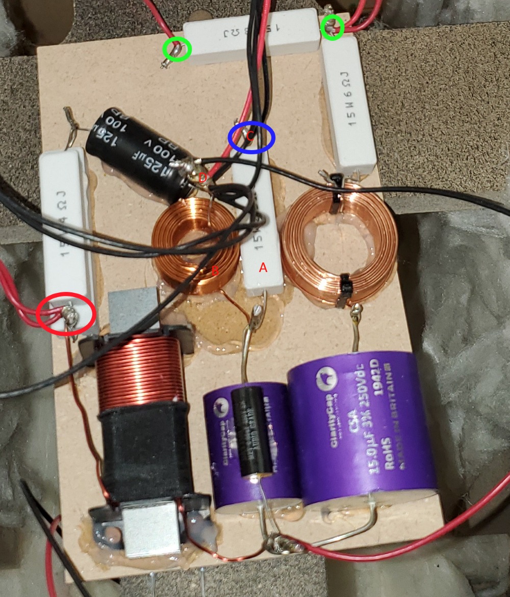

It is easier for me to just show a picture. This is the old crossover, the new one with foil inductors is harder to see/understand.
"A" is the resistor in series with the tweeter, it is 2.5 ohm.
"B" is inductor parallel with the tweeter
"C" is tweeter connection, black because it is wired out of phase
"D" is the ground, connected to main negative speaker term and all speakers.
I know that is likely obvious, especially C & D.
The circles are not relevant here.

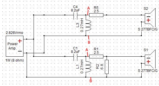

Looking at this further, the inductor is in parallel with the tweeter and the resistor, so moving the 6.8 between the 2 shouldn't change anything. It may not change the tweeter level either though.

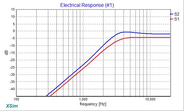

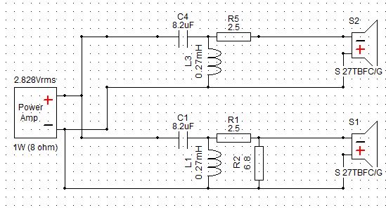

Not easy, but it seems a 3-way crossover, where the tweeter filter consist of a 2nd order electrical network followed by a resistor. In the attached image it is the upper filter. The other is what I think is your proposed mod.
Using the above components values and a Seas tweeter (or to be precise, its impedance), those are the predicted responses of the two filters:

The setup looks right to me, but R5 changes from 2.5 to 3.9 & 6.8 when it becomes R1/R2. R2 is correct at 6.8, R1 should be 3.9.

I tried it, it dropped the tweeter about 4 dB.
But since all I did is move a 6.8 ohm resistor from parallel with a 3.9 (~4) ohm resistor to parallel with a ~4 ohm tweeter, all in the same path, the overall resistance should not have changed between points A and B. And if that value did not change, then the crossover points should not have changed.
Am I missing something?

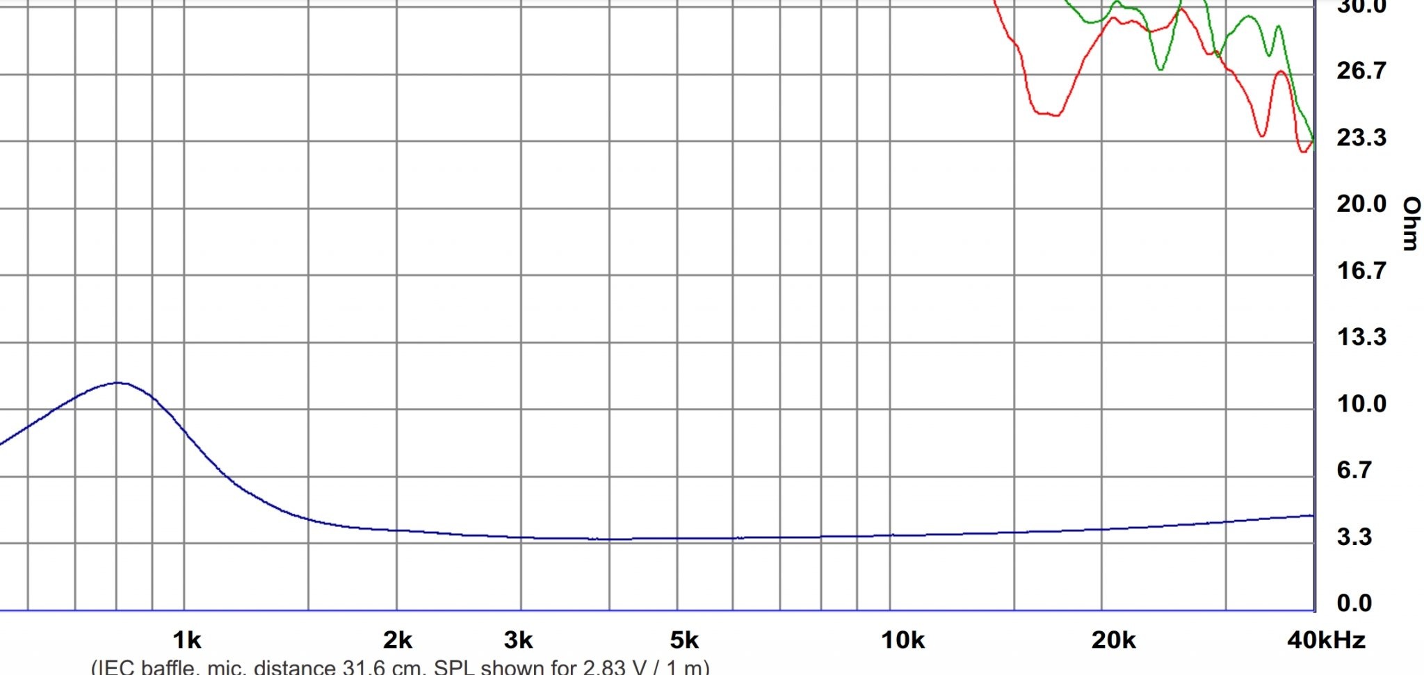

I wouldn't expect much change, but then the tweeter impedance does vary with frequency.
You're not showing the tweeter response separately?
Sorry, not quite sure what you mean.I wouldn't expect much change, but then the tweeter impedance does vary with frequency.
That is a nearfield reading from about 1 meter. Left spk.
This driver is pretty flat in the relevant area. I have to make the change on the other speaker and see how it sounds.I wouldn't expect much change, but then the tweeter impedance does vary with frequency.
This actually fits. The initial change from the default 2.5 ohm to 3.9 ohm resistor, dropped the tweeter about 2 dB. When I made the last change, that resistor (R1) went from 2.5 to 3.9 again, so I lost about 2 dB there and another 2 dB with the 6.8 added in parallel with the tweeter, for 4 dB loss in total.

I think with a 1st order crossover, this could be done without complication (assuming there was a resistor at all in series with the tweeter), and a 2nd order with this design, works also. The tweeter having a flat resistance curve is basically a necessity also. It occurs to me, other combinations other then 3.9 ohm and 6.8 ohm could be used, as long as the total resistance was 6.5 ohms in the end. If I wanted to drop the level less or more.
