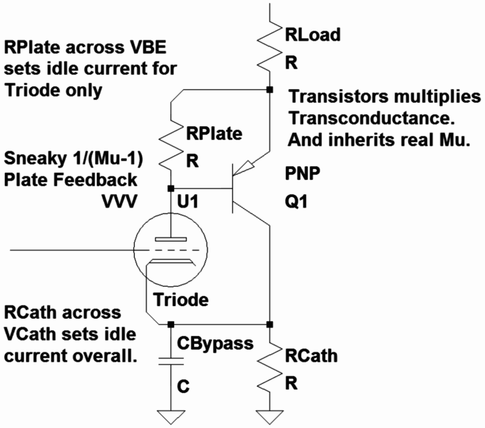

Input capacitance of the stage increases when you parallel the tubes. So, You need to make sure that driver stage can provide enough current to drive output stage.
Well, as Don Smoking Amp once explained it to me:
A triode is any number of parallel triodes internally.
Any one path by itself would have perfect Mu and
parallel curves that never "lean over to the right".
Its the average of those many slightly different
triode paths, each with slightly different cutoff
thats makes for the leaning curve set you would
typically see. And more so, the less truly parallel
and well controlled the internal pathing.
Now your beam power tube dumbed down to a
triode probably has really good internal parallel
sameness, like a high quality triode. But start
pluggin in multiple tubes, you can expect more
and more the leaning over curves of the triode
with sloppier internal construction.
I would look into Triodlington, where a single
high quality triode provides 1/(Mu-1) plate to
cathode feedback path for a power transistor's
collector to base.
Thus loaning the sand: high input impedance,
low output impedance, and proper triode rule
of Mu. Without having to parallel a bunch of
real tubes to get required transconductance.
And avoiding degradation of the triode curve
in the blender.
Like magically duplicating single malt Scotch in
a current mirror. Would it be better than a huge
but blended barrel of the real thing? I don't know
when sandy mirror magic might be the better or
worse than a blended reality?
If you are going into AB2, you can only use
the PNP (Sziklai CFP) version of Triodlington.
Else forward grid current gets multipled too.
But transconductance of such a pairing is so
high, no need or reason to operate into AB2...

I was not suggesting any problem with AB2, except that NPN Darlington arrangement
would multiply grid forward currents. PNP Sziklai would have no such troubles.
Was the only point about AB2 I was trying to make earlier... but I can expand on it...
I'm not against AB2 with music, except it usually takes sand to drive it properly. And
then you might just as well have thrown your sand into a Triodlington, and have more
transconductance than you could ever dream. You can do both of course, but its sort
of pointless. Once you have nearly unlimited current of sand under the firm voltage
control of one really good triode, what reason did we need the added hassle of tryin
to drive AB2 on both sides of the forward current knee?
If your talkin' one of those transmitter triodes thats in AB2 all the time, the knee is
maybe not a problem. But you still need big current to drive it. I think you still end
up throwing sand at the problem of driving a triode act like sand with Mu, so why?
Triodlington operated below the grid current knee is a better deal all ways round...

Hi Ray_Moth,
You said "Another disadvantage is the risk of current hogging but this can be minimized to some extent by adding a resistor of 100 ohms in each plate circuit. "
I've seen the use of plate resistors, eg Ampeg SVT, but never really understood the "Why?" of it.
Can you explain?
Can you explain?
never, ever build a circuit I don't understand 200%.
This should catch you up to the 200% understanding threshold. Or maybe not...
Nothing wrong with real parallel Triodes, except how averaging "cheapens" the
curve exactly like less accurate internal construction would... On the other hand,
the average has lower noise. I doubt that merit matters much for output stage...
This duty screams for current multiplication...
Sorry, an R in the PLATE circuit will only lose power, certainly NOT eliminate current hogging.
To solve that, you need a decent sized R in each CATHODE circuit, but again 100R will lose a lot of power.

But here's basically how I proved to myself that Smoking-Amp's
theory was functionally exact truth....
It started with a triode emulator that was basically a Schaded
IGBT stacked on top of a vacuum diode. It simply duplicated a
real diode curve, parallel, and with forced perfect Mu spacing.
This curve set looks way too ideal, not like a real triode at all.
Curves that do not "lean over to the right". And cut off much
too sharply. Don gave his insight why that might be (multiple
internal paths with slightly different character, especially the
cutoff) in the real thing.
So I plot two sets of ideal (but slightly different) curves, and
average as-if they were operating in parallel. Now it begins to
lean and cutoff more remotely! But took no less than four sets
of curves to average convincing approximation of a real 300B.
Adding more and more curves to this average begin to make
the resulting emulation less like the expensive planar triode,
and more the typical curve set of a cheaper construction.
This proved not to be a practical circuit for a triode emulator,
and I abandoned it in faver of Schaded FETs. But did leave me
with the strong feeling that Don was exactly right about what
makes real triode curves bend away from the ideal parallel Mu
as they do.
The more triodes in parallel that are not exact duplicates, the
more remote the averaged cutoff will become. Mu will bunch
together at the bottom. And curves at the right side of the
graph will be tilted at a more severe angle those at the left.
The noise killing might be useful if all vales were oriented a
bit differently? I think the Mu of all the other triodes fights
against an external noise when it is picked up by only one...
Again, thats maybe not relevant benefit to an output stage.

RLoad can be CCS or Choke no prob. RCath could be LED as long
as RLoad or CCSLoad sets a sensible quiescent current instead.
I think LED on bottom + choke on top would be begging for sand
runaway. Choice of triode boils down to quality, don't have to be
a high current monster.
In the NPN Darlington configuration, the emitter drop could be
a useful cathode bias. Though the emitter voltage drop is not a
constant, you can expect it to color the result somewhat...
In N-CH Darlington configuration, VGS-on gives more practical
Volts with which to bias the cathode. But now you some gate
capacitance phase shift in the Mu feedback loop. I think that
makes the N-CH MOSFET circuit a lot less desirable than use
an LED at the Cathode and PNP at the plate...
You need a bleeder resistor across VBE or VGS in either case...
Fixed resistance across a fixed voltage gives constant current.
There's not really enough working volts here for a complicated
CCS, the resistor alone does just fine.
