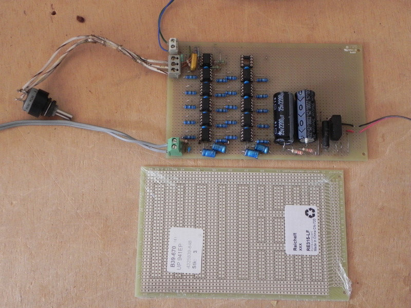

Paralleling op-amps is used for these purposes a lot by Douglas Self.
Last week I finished a (low) power amp inspired by his Elektor article, using one NE5532 for an active volume control and as a driver for the ouput stage where twenty NE5532 voltage followers are in parallel.
