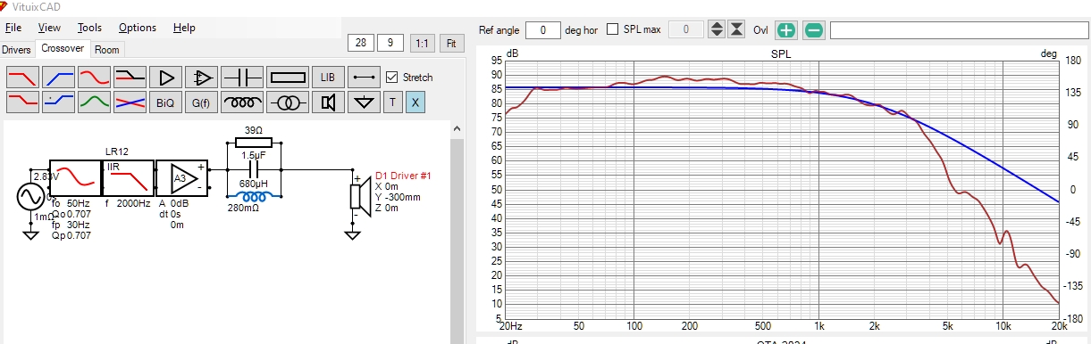

This seems to work as a starting point

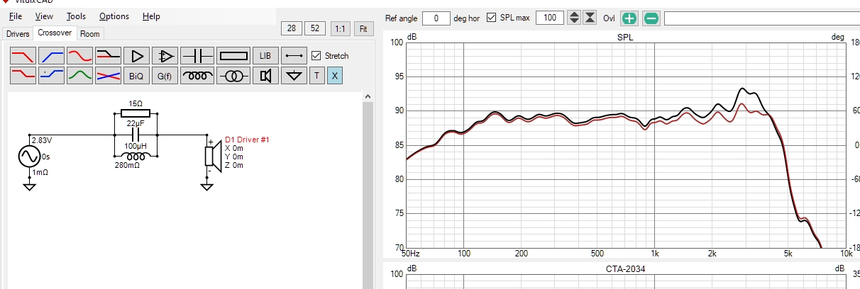

Passive notch component values would need to be entirely recalculated/simulated after your active low-pass filter has been applied; response ideally measured ofc.
Example here after applying a rando 2khz 2nd order filter
Passive parallel notch doesn't seem to be doing the trick for me. Did you use a library block? When I try to either tune it or optimize it, it doesn't seem to do what I want to bring the peak down.
