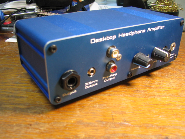

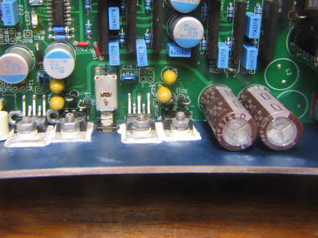

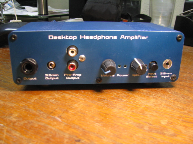

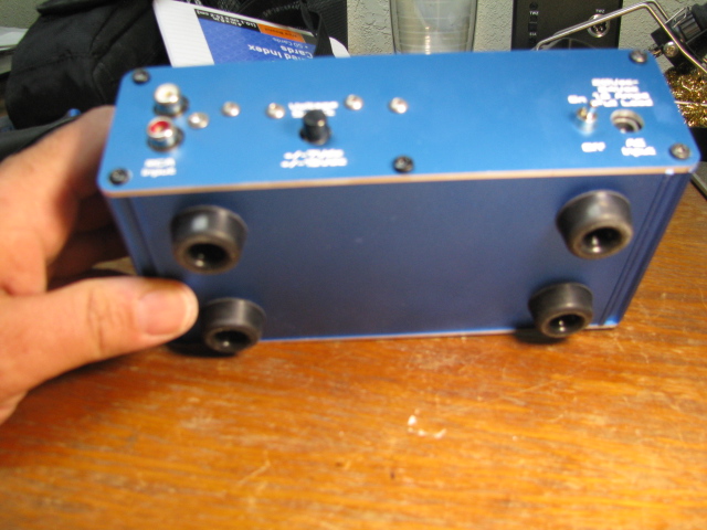

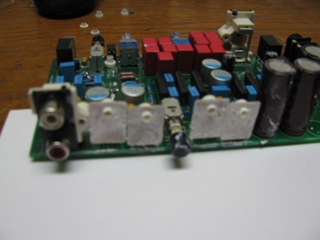

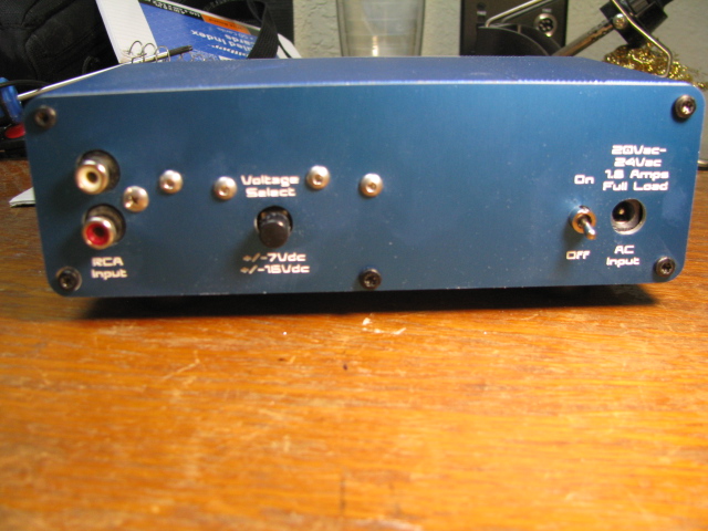

Hardware parts kit now available for this headphone amp
I have a hardware parts kit available for this DIY amp now. The build thread is here:
http://www.diyaudio.com/forums/headphone-systems/229934-version-o2-desktop-amp-oda.html
The kit consists of the parts needed to mount the 4 voltage regulators including heat sink grease, the two hold down screws for the RCA jacks, and adhesive rubber feet for the case. Total price is $10 USD plus shipping via paypal. PM me if interested!
Note that the part numbers for the basic TO-220 mounting kit at Mouser is in the BOM, along with part numbers for the feet. This kit is just a little fancier with stainless steel parts, truss head screws for the RCA hold down (bigger and flatter head), and extra-long TO-220 washers.
I'm including 5 lock washers and 5 nuts instead of 4 since at least one tends to go flying across the room and land in the carpet during assembly, in my experience. 🙂
The kit contains:
* 4 3mm x 0.5mm x 10mm 18-8 stainless steel socket head (2mm metric allen wrench) bolts. BoltDepot #7220
* 5 3mm x 0.5mm 18-8 stainless steel hex nuts. BoltDepot #4773
* 5 3mm 18-8 stainless steel lock washers. BoltDepot #4810
* 2 Phillips truss head #4 x 3/8" screws, 18-8 stainless steel. BoltDepot #4032
* 4 extra long TO-220 nylon insulators.
* 4 mica TO-220 insulators
* 2 packages of thermal silicon + zinc oxide heat sink grease
* 4 adhesive rubber feet. Philmore #10-602.
The correct order to assemble the TO-220 hardware is heat sink grease on both sides of the mica washer first, then apply to the 4 voltage regulators. Then insert the 4 nylon insulators. Then place the rear panel over the regulators and get the nylon insulators inserted into the 4 holes in the panel. The pre-regulator metal tabs are thinner than the LT final regulators so the nylon insulators will extend about 0.25mm past the panel. That is OK.
The socket head bolts go in from the outside of the panel, so the head is visible on the outside. Insert one bolt into a nylon insulator making sure the insulator stays in place, then slide a lockwasher over the threads on the other side, then thread on a nut. Don't tighten the nut down firmly yet.
Then do the same with the other 3 voltage regulators. When all 4 nuts are hand tight go ahead and snug them down. A 2mm allen wrench is needed for the socket head bolt and needle nose pliers to hold the nut. Then as a final step measure the resistance with an ohmmeter from the exposed metal edge of the panel to the tab of each of the 4 voltage regulators. It should be an open circuit or millions of ohms. It doesn't matter if you get a low reading to the bolt itself, just the tab needs to be insulated.
One truss head screw goes into the mounting hole on the rear RCA jack. Once the whole PCB is slid into the case, and the front panel on, the other truss head screw does the same for the front RCA jack.
The adhesive feet just stick to the bottom of the case. Holes could be drilled in the case bottom and #8 screws used with the feet, but that isn't included here. I've found the adhesive works quite well.
Photo #2052 shows the contents of the kit. #2048 is the difference between a standard TO-220 nylon insulator and the extra long insulators in this kit. The standard insulators (as comes with the Mouser TO-220 mounting kit) will work fine, but require a little more care when lining up with the panel hole. #2038 shows the initial step of applying the heat-sink-greased mica insulators to the 4 voltage regulators. Make sure all 4 micas are lined up vertically. The remaining photos show the final assembly with the bolts. Note that since the two pre-regulators have thinner tabs the bolts extend a bit further past the nuts.
