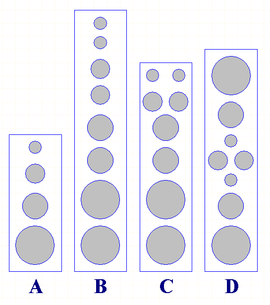

G’day.
In the not too distant future I’m going to have up and running an amplifier that can deliver huge amounts of power into a very low impedance.
I’m going to need a pair of HiFi speakers to go with it. I have elected to build a fully sealed 4-way 12db/ octave system starting with a 12” woofer.
However, in order to handle the power output of my amp, I’m going to need parallel drivers – two in parallel for each frequency band should do just fine and dandy.
My knowledge on speaker building is rather limited and I have yet to pick up and read a good text on the topic, so I’m just throwing around ideas at the moment with respect to cabinet design and driver placement.
Attached below is a pic showing a few ideas. Shown at A is a conventional 4-way, with B,C and D being different layouts for twin parallel drivers. I’m going for D at the moment mostly because it would look really cool and the box isn’t too high.
What I basically want to know at this stage is if I am heading in the right direction or if there are any problems with interaction between parallel drivers, which would make these deviations from the conventional 4-way either a failure or waste of time.
Glen

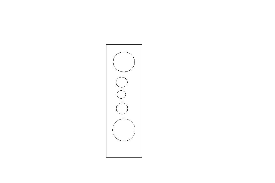

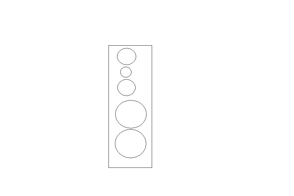

tinitus said:Or like this
Ok, but that's not too far away from my "D". I still want to do a 4 way though. I like a challenge.
Why the offset of the smaller drivers?
Glen

Making a two way behave nice with 1st order is not so easy,
Trying to to a 4 way is going to be rough.
Having even (linear) amplitude response is going do be difficult.
You would need some sophisticated measuring tools, and prediction programs.
You will probably have issues with the Voice coils of the drivers interacting with the capacitors, and causing resonances that, maybe a zoeble, on the driver will help.
Making a good passive xover, requires more than the basic math to make the circuits. There is no 1 size fits all passive xover, technique.
Normally Multiple tweeters is a bad thing, as they will interfere with each other, and cause a lot of comb filtering.
With most decent drivers you should be OK running 2X RMS if you don't clip your amps.

Do 1st order filters actually sound good? Theres so much overlap, I would imagine a lot of smearing, and overworking of smaller drivers.
Anyhow Go for it if you think you got what it takes. I would go all active xovers and use multiple amps.

Oh PS
I think a Diapollito greater than a 2 way is not normally advised.
Too many xover lobes/nulls.

WMTMW is also common and is similar to the Tinitus's design in post #3.
WWMTM is also popular and is similar to the Tinitus's design in post #2.

Thanks for the replies!
OK, this is along the lines of what I wanted to know.
If the 3-way WMTMW arrangement is common and works well in proven designs, then is there any theoretical reason why a W-M1-M2-T-M2-M1-W would not also work well in an appropriately engineered 4-way system?
Since two tweeters are bad due to interaction, I guess I can use a high power / high sensitivity horn tweeter to compensate???

Major Polar issues, depending on where you cross over, as well as inherent polar issues from Xover lobes in a (Hyper Di Apolito?).
Ok, but how "major" are these polar issues and how "major" are they in a 3-way version, which seems to have some degree of popularity?
BTW, I'm not in the least bit fazed at attempting a 4-way. If in the end it doesn't work to satisfaction, I'll just scrap the cheap MDF prototype box, either flog the excess drivers off on ebay or keep them for a future project, and then attempt a 3 way. 🙂

As to your question, it is possible to do this, but is complex.
I'm assuming by -
W-M1-M2-T-M2-M1-W
you are referring to your drawings labeled 'C' and 'D', of which I think 'D' is the more workable design because the tweeters are in a vertical line.
What is your purpose in these proposed designs?
Is it to have a certain final impedance in each section?
Is it simply to move a lot of air?
Or, do you just think they look cool?
There are a few elaborate design similar to this, but they take a great deal of engineering. When you start modifying an already complex design like an WWMTM, and make it more complex, it becomes ...well, you know...very complex.
I'm assuming by -
W-M1-M2-T-M2-M1-W

never heard a good four way yet.
not sure why you're so set on it, esp if it's your first build. (I mean by all means do what takes your fancy, but don't discount some of the excellent advise given so far)
Out of your designs above, the only possible one that could work would be one, I'd forget about the rest.
I simply cannot see any advantage of a four way over a properly designed three way, and a heck of a lot more potential problems.
not least using first order x-overs. if you're gonna do a four way surely you'd better start getting some decent slopes on them?
(not a first order guy...and not really an mtm guy either!

Download EVI array show, and make your w m1 m2 t m2 m1 w array.
Figure out what the spacing between your drivers.
You will have to try and simulate driver attenuation in relationship to Xover points and you' will see very quickly what happens.
Driver spacing will start causing polar beaming if the drivers are spaced greater than 1/4 wavelength from center to center.
Di Apolitos (Don't know if a 3 way can still be called that) Have polar issues at xover, with just a 2 way. You are going to have bad lobes. And a really narrow "sweet spot".

BlueWizard said:I modified my post above and added a new link to a final WWMTM design.
I'm assuming by -
W-M1-M2-T-M2-M1-W

Well of course I don't want to build these speaker just because "they look cool". I did state the objectives in my opening post and nothing is set in concrete.
If any of these designs with parallel drivers are just too much of an elaboration over the WMTMW (for example), break too many design rules and are likely to be more show than go, then I'll drop 'em like a hot potato.

Have a look at the Wilson front panel layouts.
Why are they so complicated.?
I suggest to get a physical time alignment of the various drivers.
I further suggest he has gone this route because the resulting sound from physical alignment is better than electrically compensating (time delay) for physical non alignment.
I would look at WWMlowMhTMhMlow, with the possibility that the WW could be side mounted to allow a very narrow front face. And offset the drivers from centre line, bringing the treble and Mh towards the central mono image.
I would also consider using 16ohm, or higher, driver impedances for all except the WW.
Finally,
spend much time deciding on whether the sound between single pole and two pole filters is audible and which is preferable, even to the extent of building a prototype MhTMh to test how each filter type works.
Finally,
