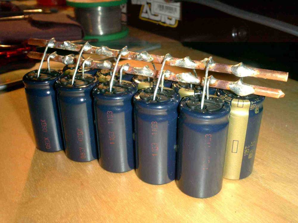

I recently bought 60 (that's right, sixty) Panasonic FC 2200uF 50V for 14 Euros, which equals 10 (ja, that's right, ten) Dollars.
I'll use them in the power supply of the Mini Aleph I'm about to build. The psu will be a CLC type with positive and negative rails. 22000uF of C, 2,2mH of L and 44000uF of C.
So each rail will have ten caps in parallel, one 2.2mH inductor in series and another 20 caps in parallel. The capacitors will be paralleled in bundles of ten (see picture) and each bundle will be grounded separately. In power supplies with many caps I like to use a combination of star-grounding and ground-follows-signal.
Aber Achtung, there might/will be some problems. As the ESR will get lower by paralleling caps (which basically is good), the leakage current will rise (which is bad).
The wires' inductance might also be a problem. See this excellent thread for reference:
http://www.diyaudio.com/forums/showthread.php?postid=548002#post548002
Jean Hiraga's "Le Monstre" has loads of capacitors in it's power supply:
http://www.bonavolta.ch/hobby/fr/audio/monster.htm
Why people bypass (parallel) large capacitors with "a small value high quality" cap?
Because the impedance of a capacitor goes down with increasing frequency. So the smaller capacitor, mostly a non-polar film-type, has to compensate for the larger cap's inability to filter/decouple/supply the high-frequency current pulses. A lot of voodoo going on here.
