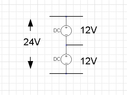

I have a dual 12V linear power supply. Each side is rated at 5A and has a trimmer pot for fine adjustment.
With a meter I see 12V on either output and 24V when I measure from neg. on one side to pos. on the other side. (see attached graph)
Can I wire it for 12V at 10A?
The reason I'm asking is, I bought a 4 channel Tripath car amplifier on ebay that is rated at 100W per channel @ 4 Ohm. I wanted to use it for my home speakers. I know that 120W power supply is small, but a 60W is even worse. Not looking for a lot of SPL- just trying a Tripath.
I also bought two 12V, 100W SMPS for possible use with the amp (too cheap to pass up).
Is it safe to parallel those for double the current?

Given the 85% or better efficiency figures of class D amplifiers and the inherently low power content of music signals due to their high peak to average ratio, a single 100W PSU may suffice to power a 4x100W amplifier as long as it's used for listening plain full-range music.
Also, you can parallel independent 12V switching power supplies, but due to their regulated nature and their very low output impedance, the one producing a slightly higher output voltage will supply all the current until it folds back, then the following unit will start providing current also (if the PSUs shut down instead of folding back in case of overcurrent, then they are not suitable at all for paralleling). There is no general rule about paralleling two 12V outputs from the same PSU, some designs allow to do that while others doesn't, so you will have to study the circuit and find out.

Thanks. That is a very concise answer.
I thought that a single 100W PS would do OK as well, but bought two just in case.
I will try to parallel them if I notice distortion in peaks. If not, I'll stick to one.

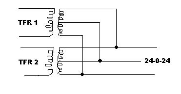

On similar lines, I am planning to parallel two transformers (24-0-24 V, 5A ), both same type, same manufacturer, same specs to increase the current . Attached is the possible schematic. I did not find a transformer greater than 5A. This would feed a 6 (5.1) channel gainclone amp (with preamps etc).
Any suggestions, pitfalls , precautions would be appreciated.

Same problem. They will never be EXACTLY the same. If one gives out only a fraction of a volt more than the other, this will set up a high current through the very low resistance windings of the other. Not a good idea.
What you CAN do is put a rectifier on each transformer and feed a common reservoir cap. The load will then balance out.
Another option is (if you need dual +/- supply) to use each transformer for a supply and connect them in series, midpoint to gnd.

The rectifier at each transformer and into the reservoir cap looks suitable. Any idea what value of caps would be suitable for such a purpose. Currently I am having 4700 uF at each output. Perhaps add another 4700 uF or more or do I leave it as it is?
Also, I have a 5A fuse at the mains. I should increase this too perhaps. Would this be 10A now?

I recommend a low value power resistor in the feed line from each transformer. 0r1 to 0r22 should be large enough.
This will help to balance currents from each winding. The resistors also reduce the peak currents which is a slight advantage.
