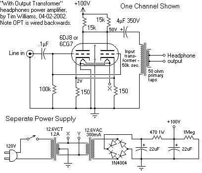

I wouldn't recommend trying this approach as the voltages will be massively large to get any useful output. If you are looking for linear then using one of Gary Pimms Pentode Constant Current Sources is likely to produce much more usable results. Even so a Tube CCS will require something like 700V to get about 15Watts output.
Shoog
6B4 resistor loaded parafeed amp

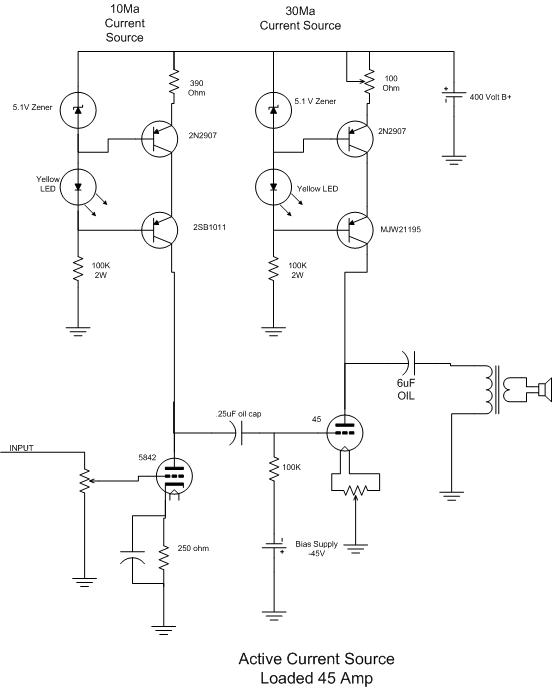

I tried this approach several years ago just to see what would happen. I don't remember the exact details, but I used an old 6B4 tube and a large (50 watt) resistor. I don't remember the value. It needed a lot of B+ voltage, something like 600 to 700 volts, most of which is used up making the resistor hot. I believe I got almost a watt of power. The resistor is effectively in parallel (for AC anyway) with the primary of the output transformer, so some of your signal power is also used to make the resistor hot. On the other hand it did sound pretty good.
If you want to make a parafeed amp without a choke the Constant Current Source is the way to go. These can be made with mosfets, bipolar transistors, or vacuum tubes. For small (up to 4 or 5 Watts) amps nothing beats the IXYS 10M45 integrated circuit CCS. I have used them in every SE amp that I have made for the last year or so for loading small signal triodes. They work well as the plate load for a 45 DHT. I couldn't find the exact schematic, however I have included a schematic of a 45 SET amp that I built using CCS's made with bipolar transistors. The same design can be used with the CCS IC's. Look at the SE amp and the 845SE design on my web site for amp schematics that use these chips.
I noticed in your schematics that you have a 1kohm resistor going from CCS(IXYS) ground to tube plate, bypassing the current set resistor. What funtion does this serve? Is this for stability?
CCS chip conections
Exactly! The data sheet for this chip does not have a resistor here. I added it to solve a problem with high frequency oscillation (50 MHz) that often resulted in blown parts. The 1K resistor works like a gate (grid) stopper resistor.
When these chips do fail they tend to short out. This will put the full power supply across your output tube. Do not use rare or expensive tubes until your circuit is working good.
If you are using one of these (or any solid state current source) to power an output tube, it will need a good heat sink. The tab on the case is connected to B+, be careful.
