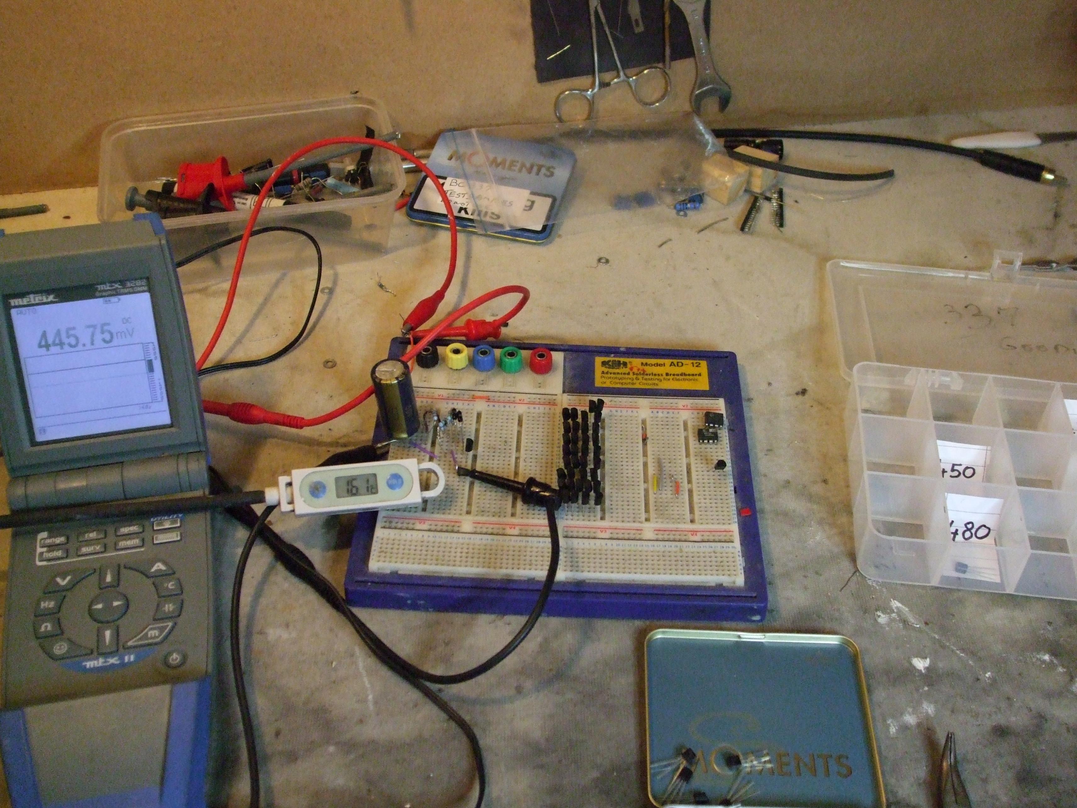

I tried the Atlas unit again and first test on a sample measure first test Hfe 477 a second test few seconds later measure Hfe 481 is not a big difference considering the 10% tolerance recommended

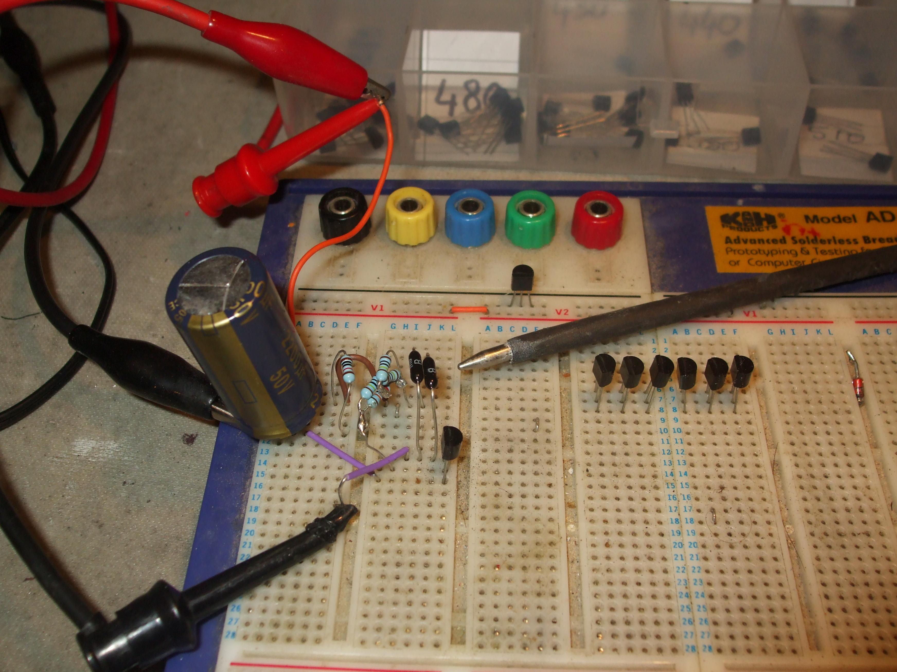

Measuring with the circuit published by Hesener give me an Hfe of 493 and repeating this give me exactly the same results (for same ambient temperature)
I like to test using Hesener circuit as I can see what is happening especially with the problems arising from touching the transistors
Considering that to build this circuit is really inexpensive I am going to stick with it and

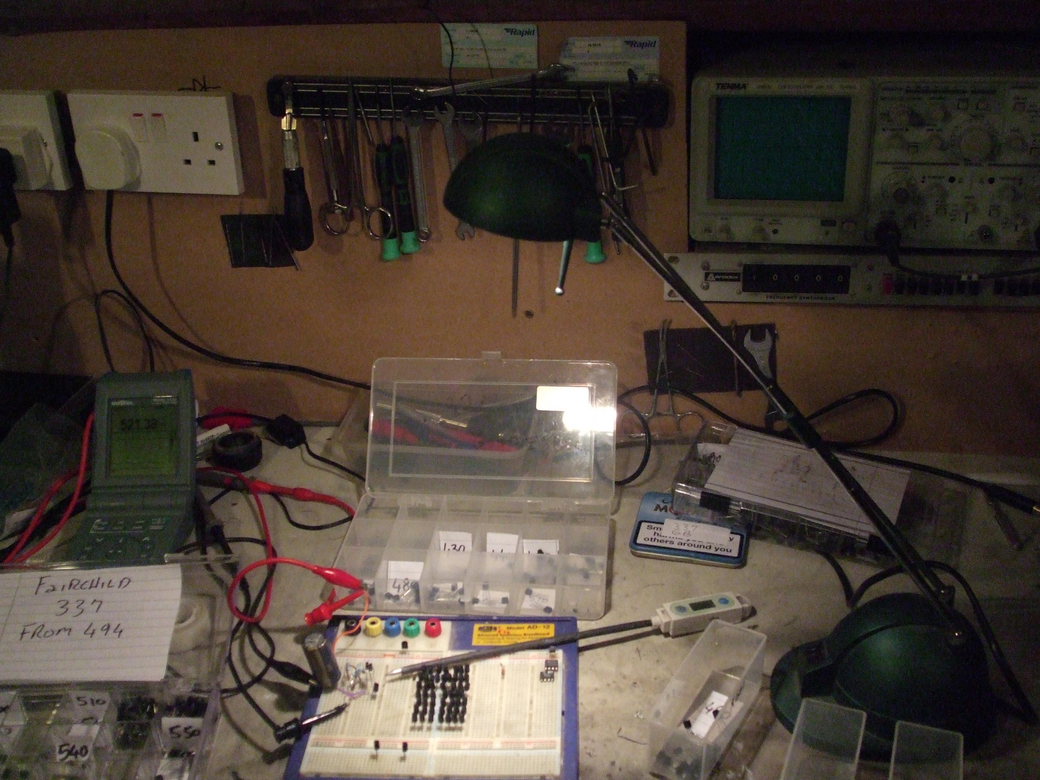

If you have the Atlas you know how often it needs new batteries (I run mine from a dedicated PSU)
In the picture my set up Voltage is 5.0012 Volts (Yes that meter cost more than an Oscilloscope I have)
Temperature at 16 C today (this effect measurement as in video)
BCxxx 40 004 - YouTube
So before I start a new batch I line the transistor up on the spare space on the breadboard and then I only use a set of pliers to place the transistors on the test position
No need to do that if you got time Just wait for the transistor Hfe to stop drifting 😀

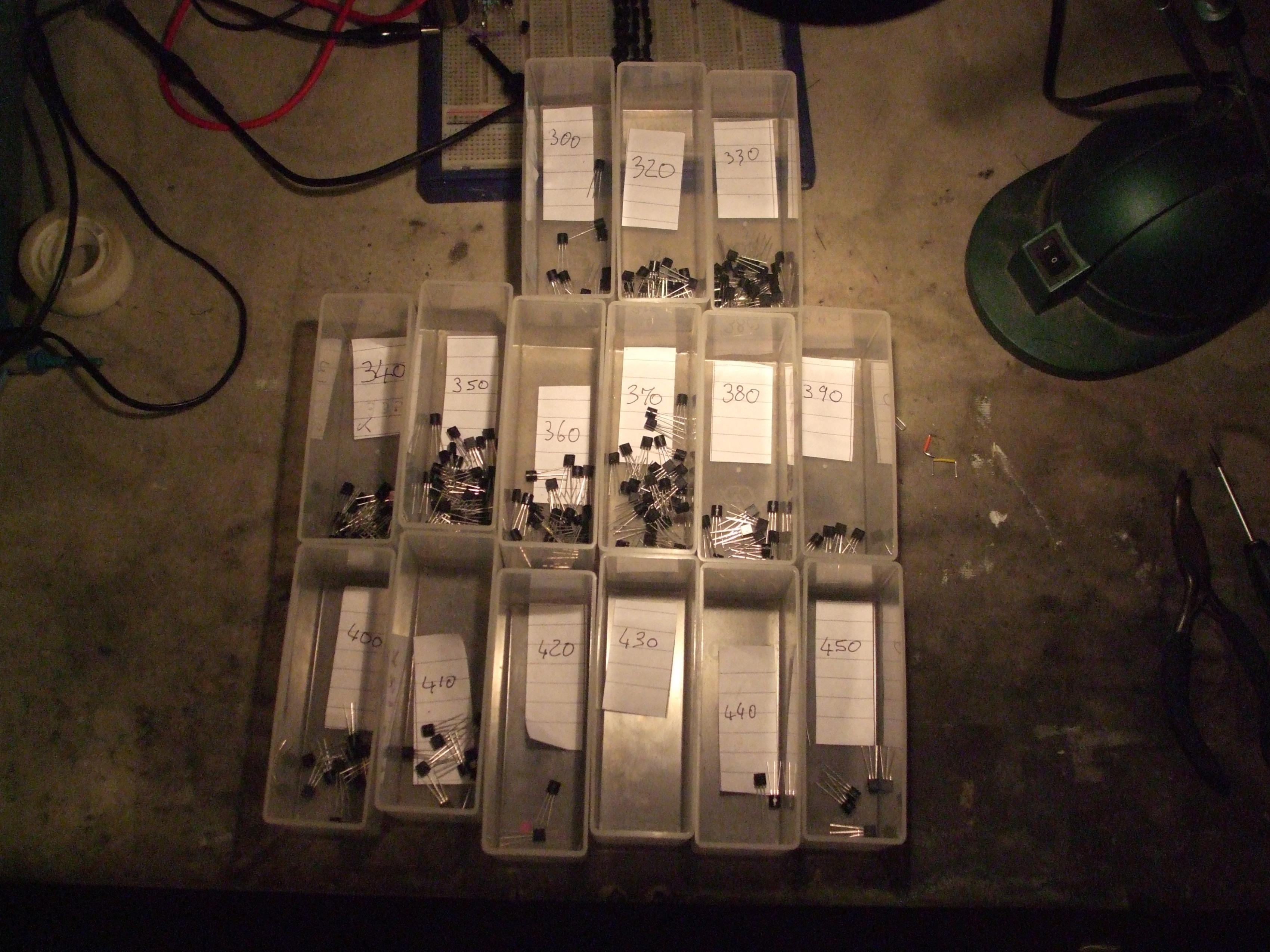

This is what I have
1000 each of BC337-40 and BC327-40
the 337 are in the 480 to 540 range
the 327 are in the 510 to 600 range
let me know what you need and we take it from there

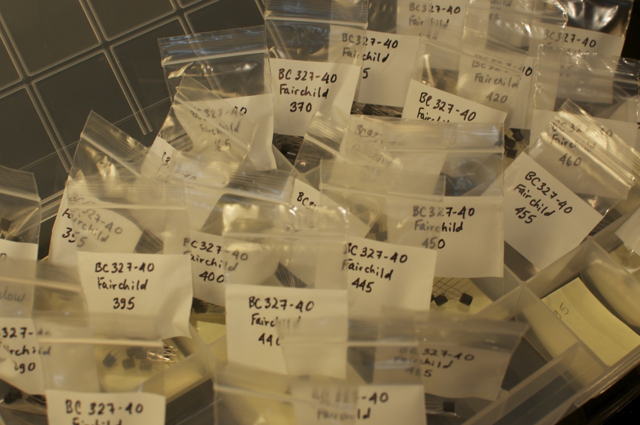

Any way mesured the 327 I got with group buy and I got 13 with Hfe around 400 9 with 410
The center of the batch is about 350 so somebody there got my lot 0f 400 Hfe NPN😀
Only 4 or 5 PNP transistors from GB are between 420 and 450 Hfe
I just scrape troug making 2 set of boards
The GB NPN are centered at about 450
From Fairchild I got loads of 327 40 around 560
Loads of 337 around 500
Let me know if any of those are of any use

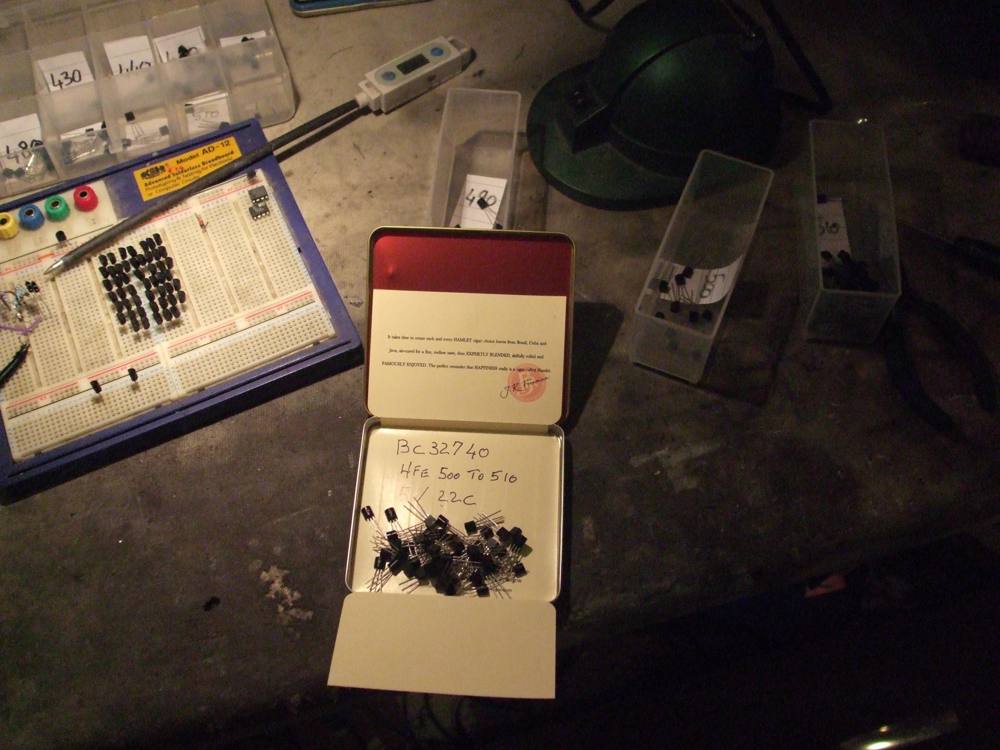

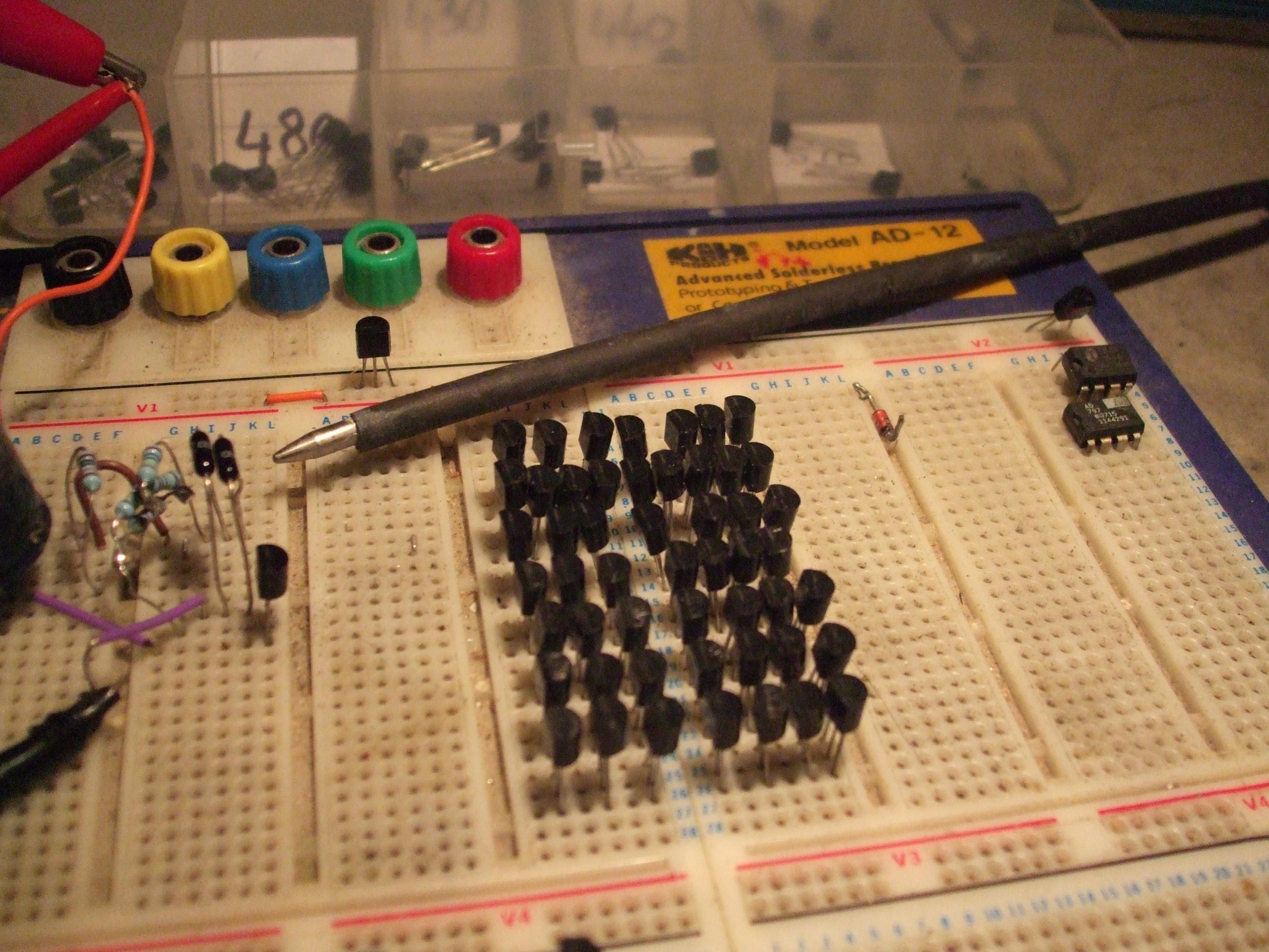

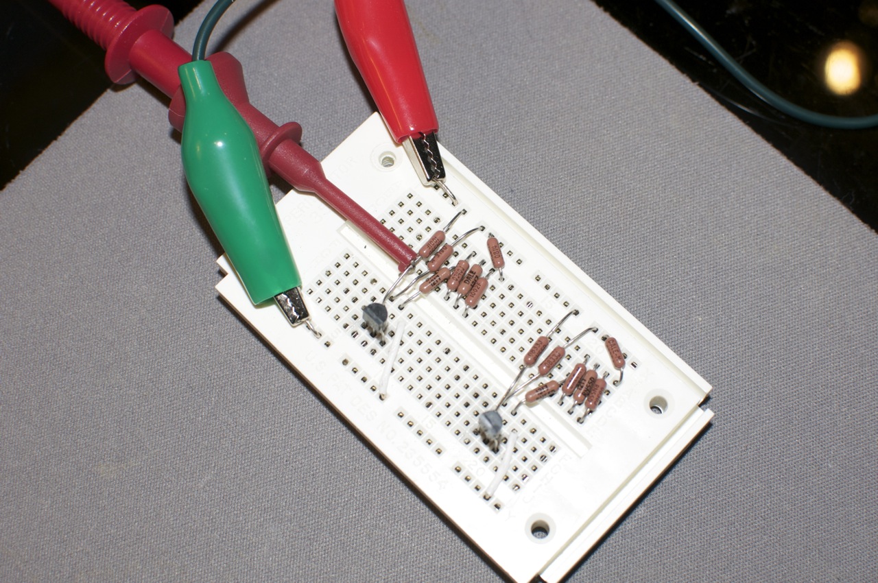

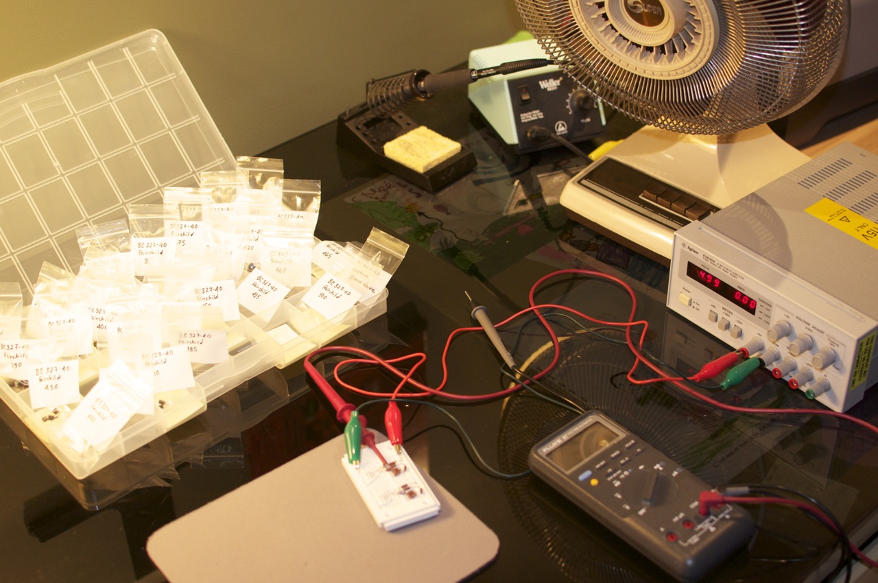

1)set up for testing Just a 317 at 5 V (5.0022 today) and a few resistors
There is going to be same tollerance there but is consistant so good enoug
2) Line up the litle soldiers so they go up to temperature on the bread board.
3)over view of meterand thermometer.

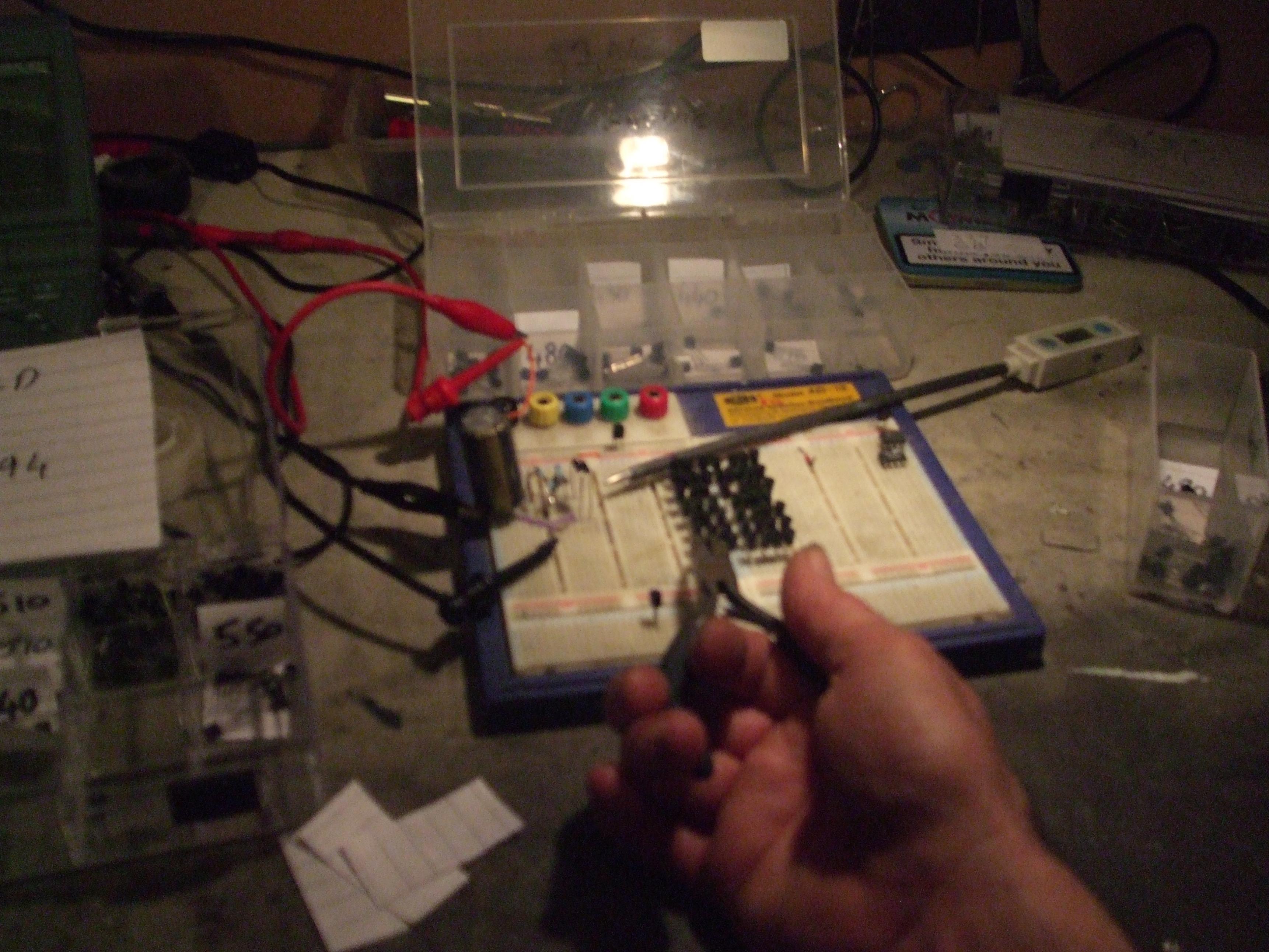

4)from now on use pliers to handle the transistors and place them on test point this save loads of time
5)batch ready is going out tomorow.
6)that lamp in there is to keep the lot at a steady temperature (22 C today)
Just move the lamp in out in out to set decent working conditions for the transistors in the mean time I got frost bite on my toes as I work in a cold loft😀
