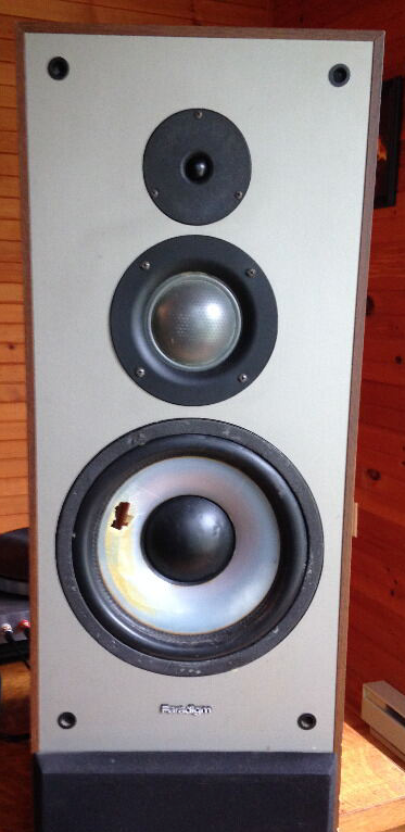

I recently acquired a set of Paradigm 11se Mk-1s from a friends dad. I've read a lot of great things about them but I think they suck. Of course everyone's opinion is going to be different but I think something is wrong with them but I don't know what. Let me explain....
These Paradigms are the ones with the Vifa DT19 tweeter, the Vifa D75 dome mid (the original gray dome) and the milky clear plastic 10" woofer (I'm assuming an Energy driver). Now I know these are often considered forward sounding, and I agree, but in every other respect they are worse then every other speaker I have. The largest of the issues is the dull, lifeless, anemic bass. And yes, they very likely have the original crossovers. I know these are early Paradigms, but a custom spec'd woofer in this big box, with three big ports? Even Chris Roemer's Nano Neo MT speakers have deeper and more powerful bass. [It sounds like I am talking about blown woofers maybe, but they do work and there is no distortion...]

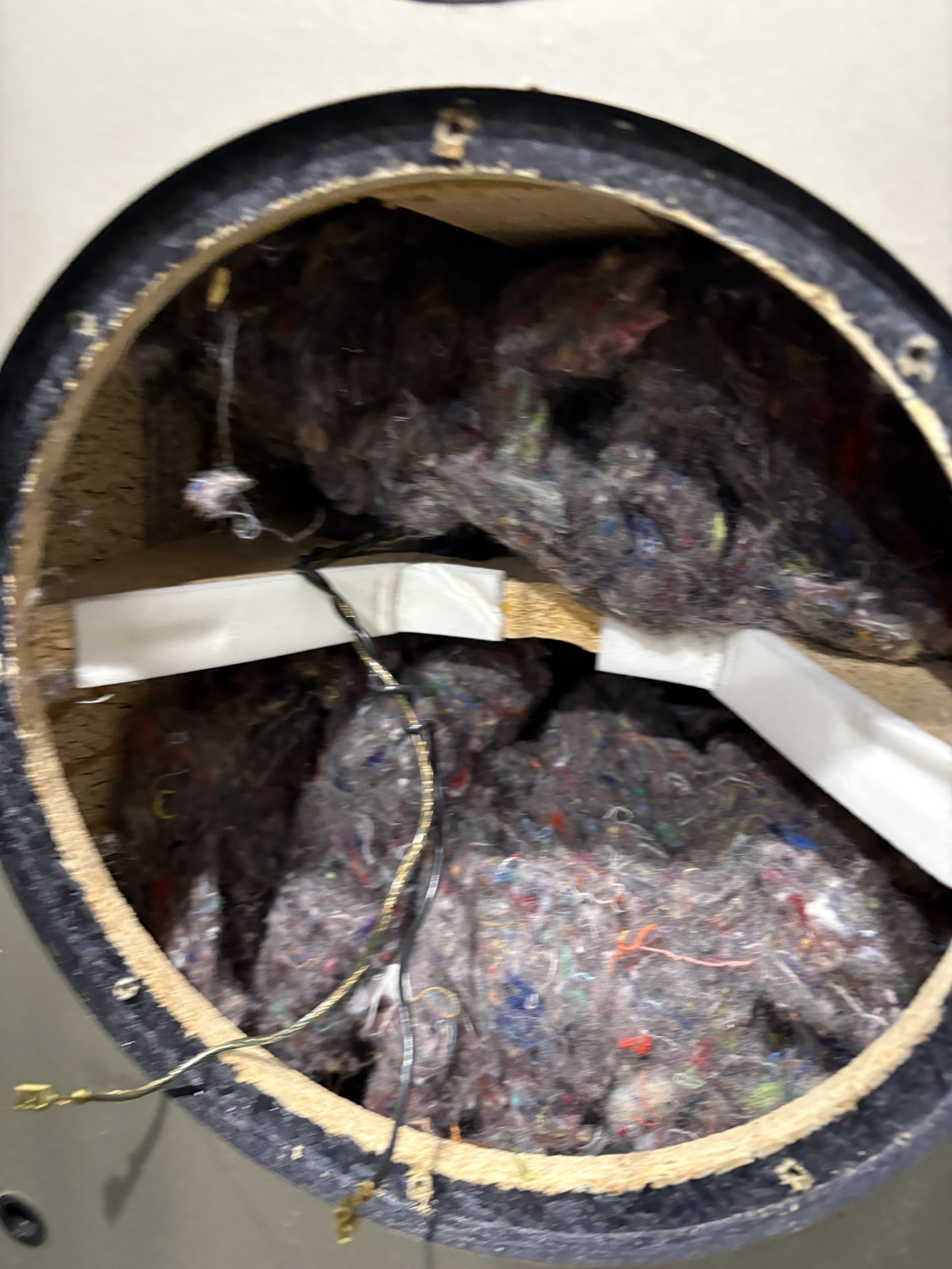

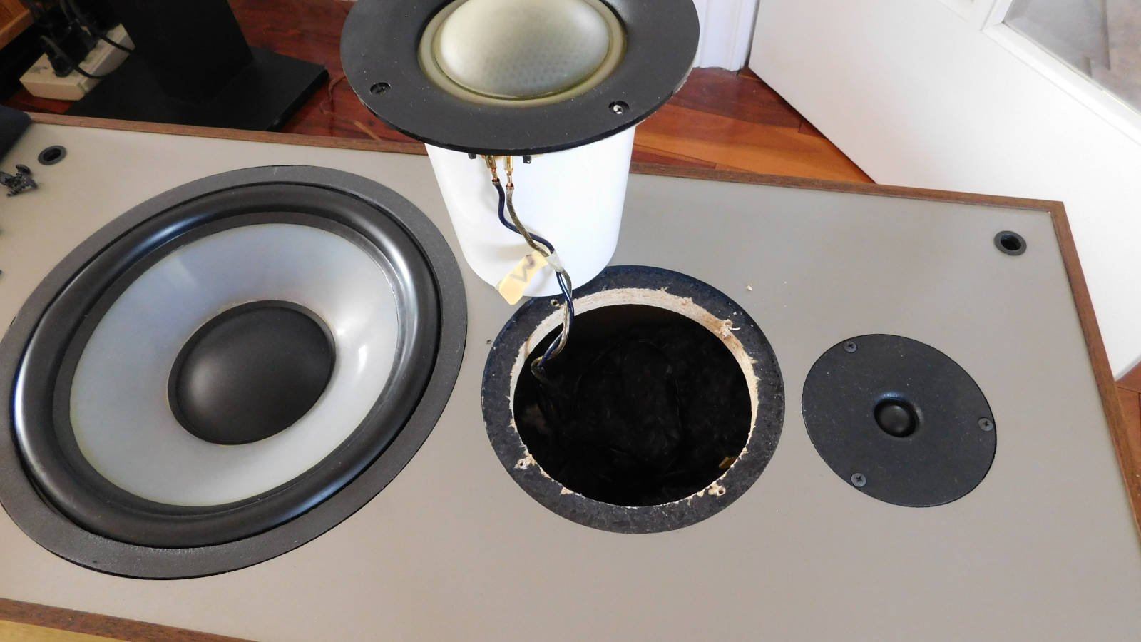

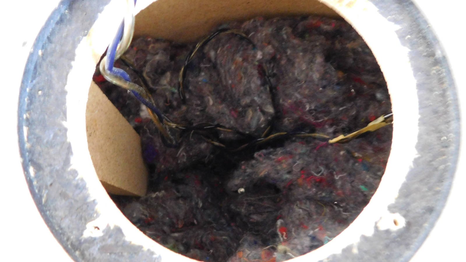

I finally got around to pulling the woofers to look inside.

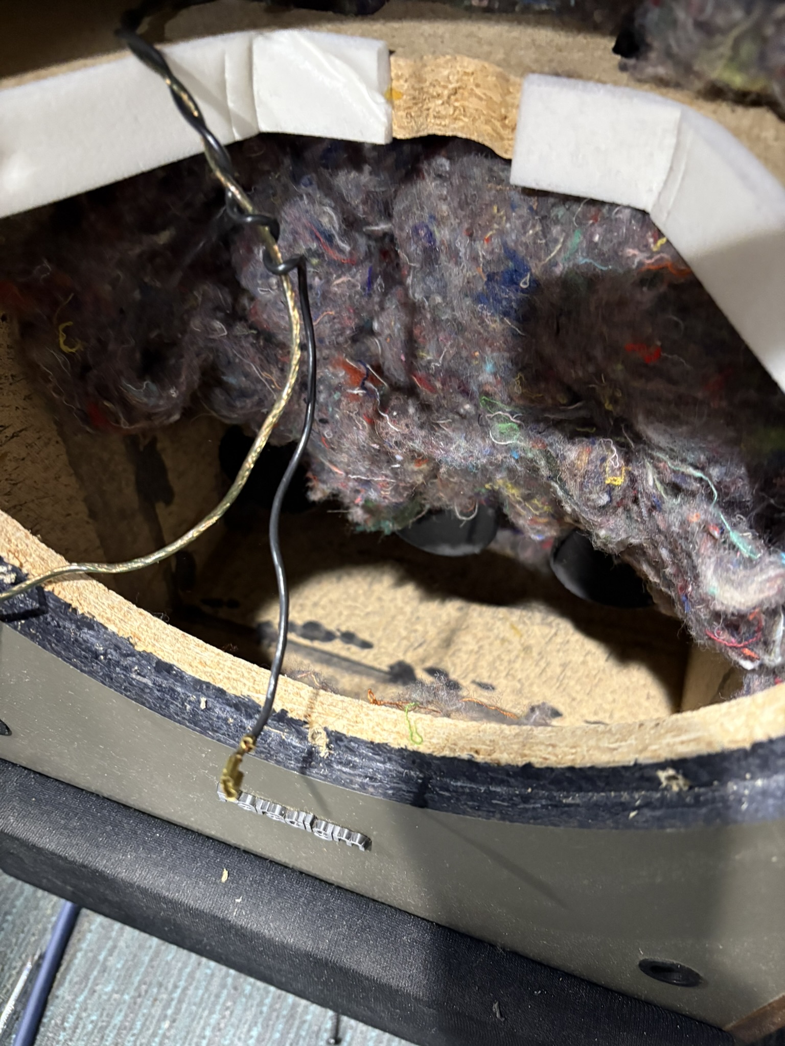

They look pretty stuffed - the port area looks clear on both - the angle is slightly higher on the second pic but there is just as much space around the ports as the first pic. I thought there was yellow fiberglass in there from my earlier post, but it was just a little chunk of yellow fibers.
Interesting, thanks for posting the pics. How did you get the woofer trim off?
I just used a MagLight to light up the interior of mine (via the poly cone), and checked the ports. There is no insulation visible, just slightly yellowed wood. Yours look like they have some type of denim insulation.

I just peeled the foam trim back just around the screw holes (8 of them) with a pick. Took my time, no damage. You can definitely see the insulation in mine through the cones with a flash light.
Hmm...interesting.....the presence of the insulation could definitely cause the sound I am experiencing. I wonder if someone in the past thought they had too much bass and tried to tame it...?

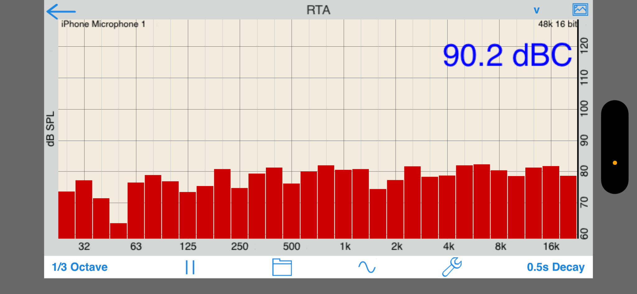

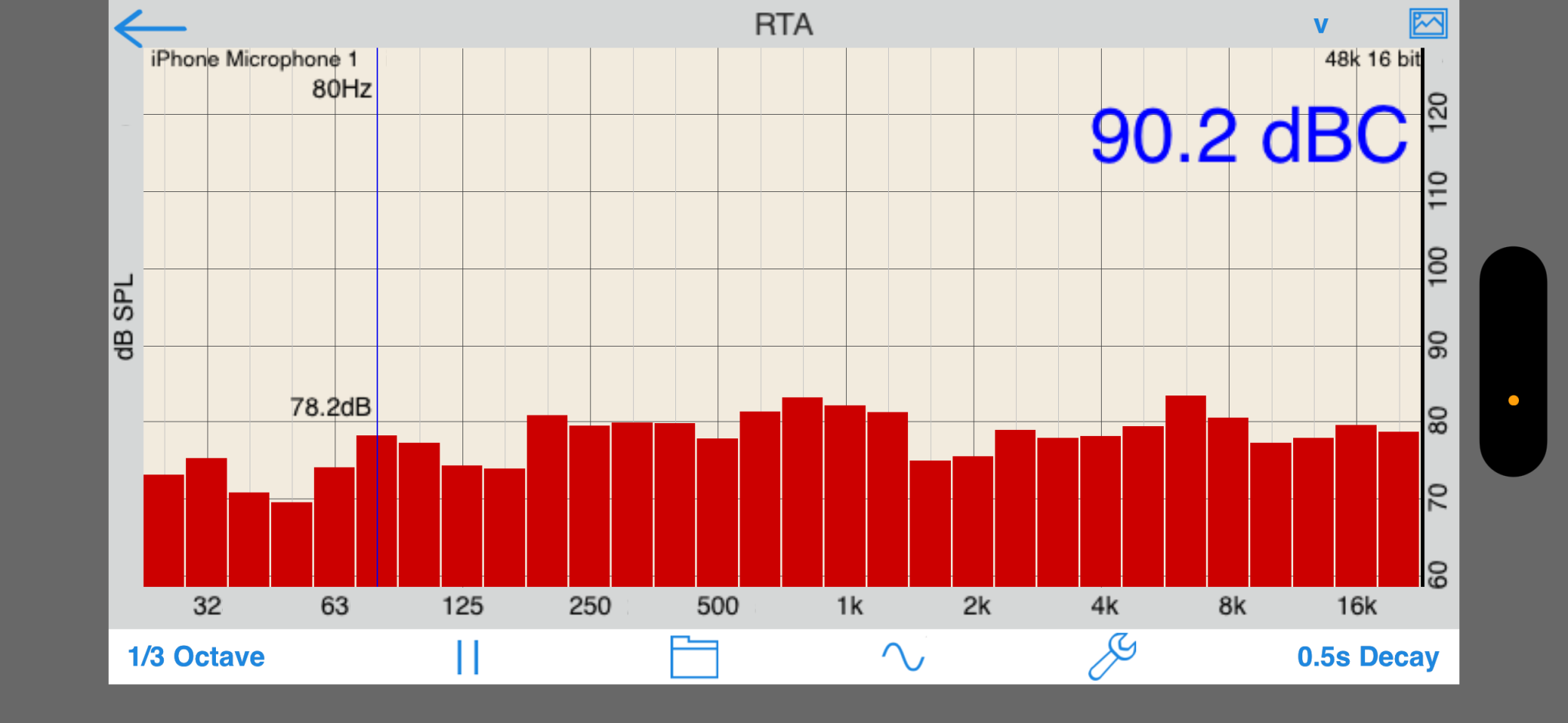

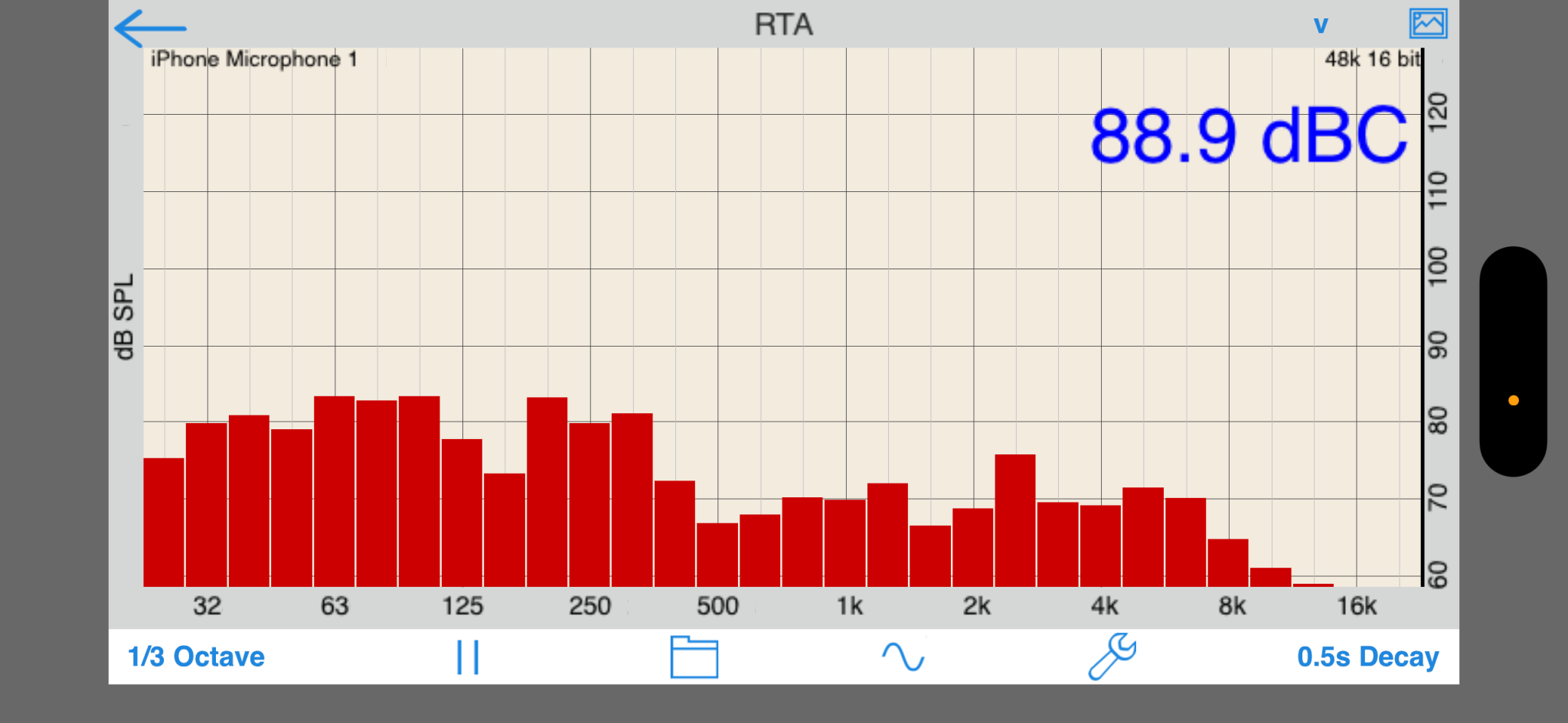

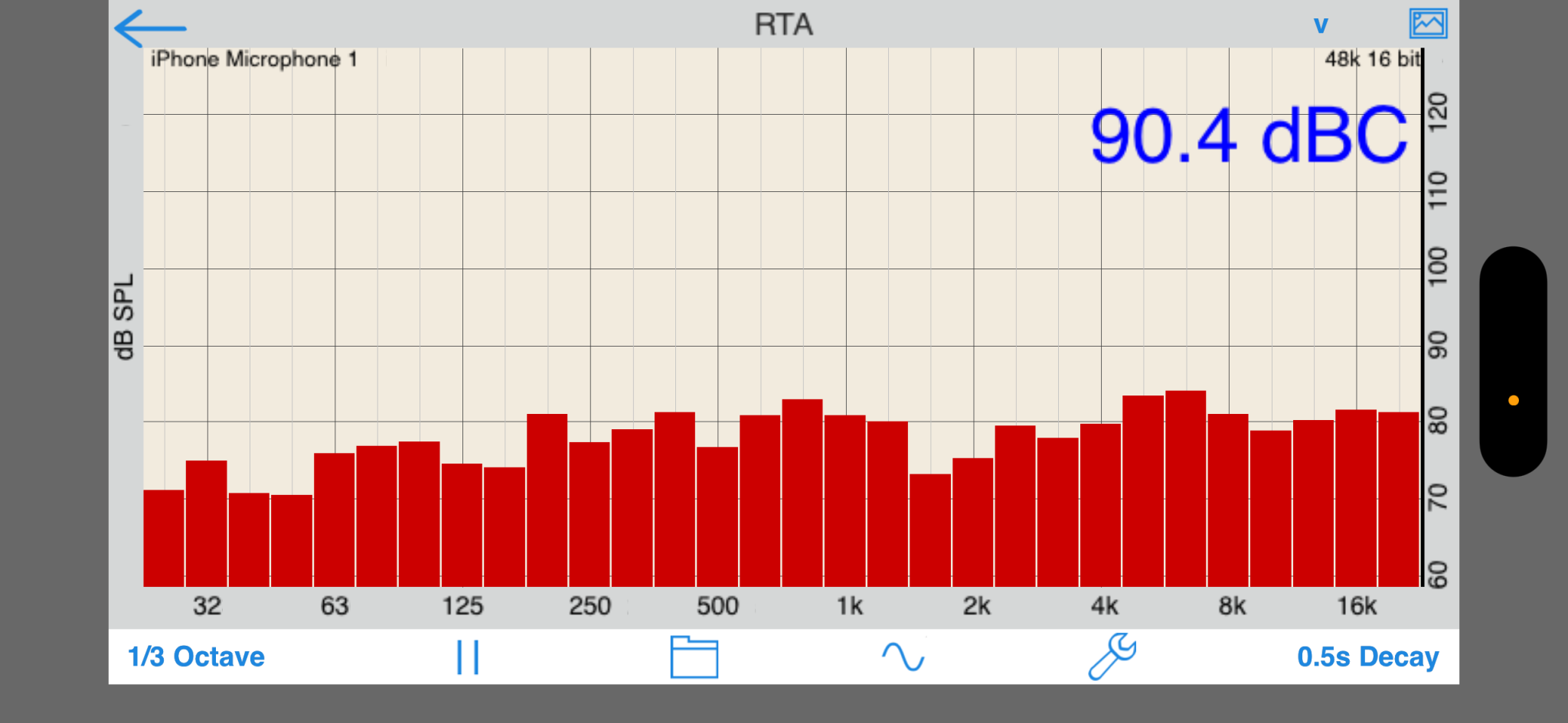

I hooked the Paradigms up last night and still feel the same. Something weird about them. Here are some screenshots from my phone of pink noise - taken via the Audiotools app on an iPhone 15 at 1 meter on tweeter axis. A FirstWatt Burning Amp 3 driving them.
You can clearly see the bass is shelved below 200hz. I contacted Paradigm to see if they had any documentation on these, especially regarding the type and amount of dampening inside, but they responded with no notes available. They offered of course it shouldn't be any problem to remove the stuffing until it sounds 'right' to me.
What mic?
dave
The one in the iPhone....the Audiotools app was calibrated for it. I know for sure it can register at least up to 114db in the deep bass....according to Batman Dark Knight anyway...hehe....

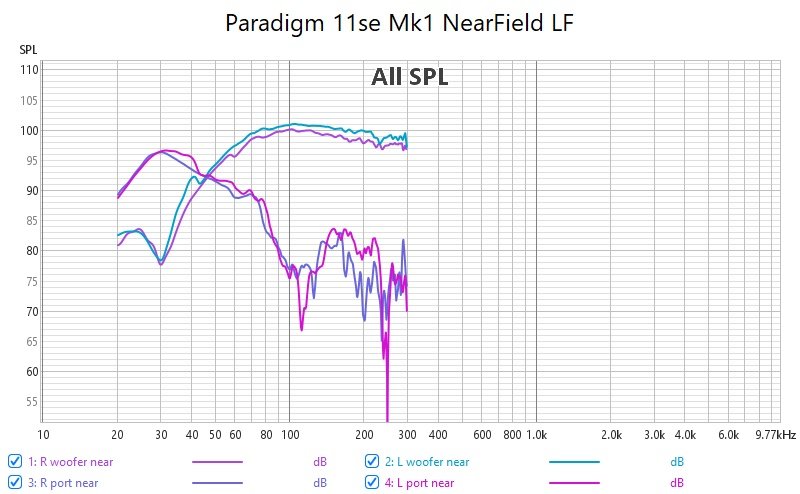

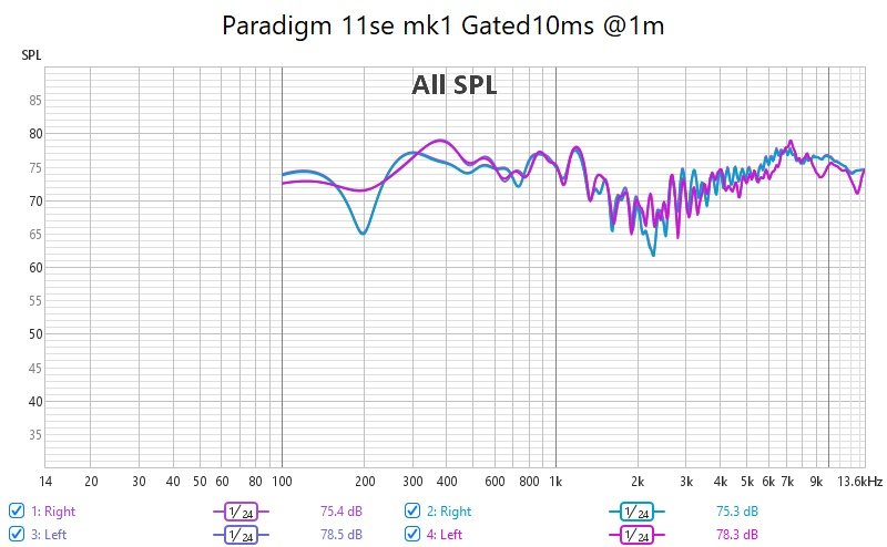

I'll post measurements of my speakers for comparison to yours. I can't find my older measurements so I'll have to redo them. I use REW with UMIK-1 mic.
Two measurements. The LF is measured nearfield to minimize room mode effects and the full range measurement is gated 10ms at 1m.
The nearfield LF is probably the one more applicable measurement as it shows the port tuning freq. The full range measurement is showing an MF dip (1.5K-3KHz) that I don't remember seeing before. I should look into it.

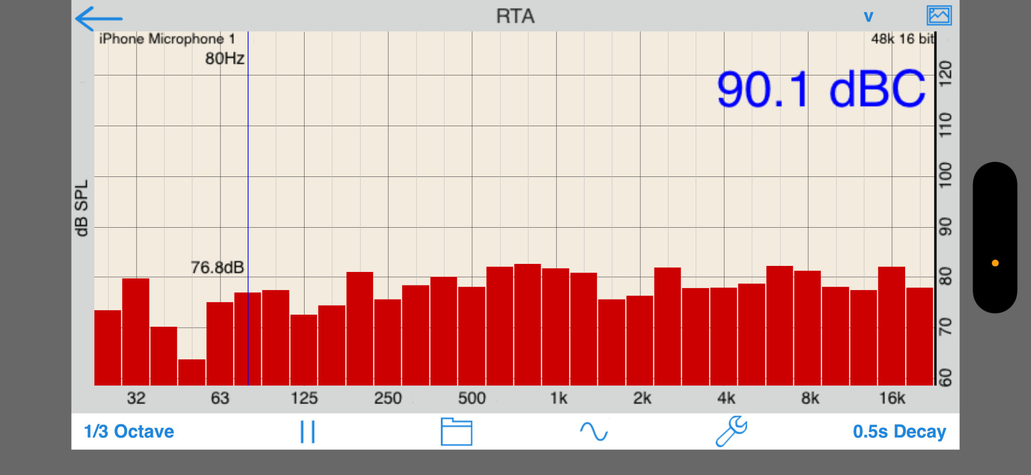

I'll have to post measurements later, but I completely opened up one side and removed half of the insulation to see what effect it had. There is, obviously, an increase in bass. I took measurements using my phone again and could see about 4db improvement overall in bass level above 32hz up to around 250hz. It looked nice but it's hard to tell listening side by side with no balance knob.

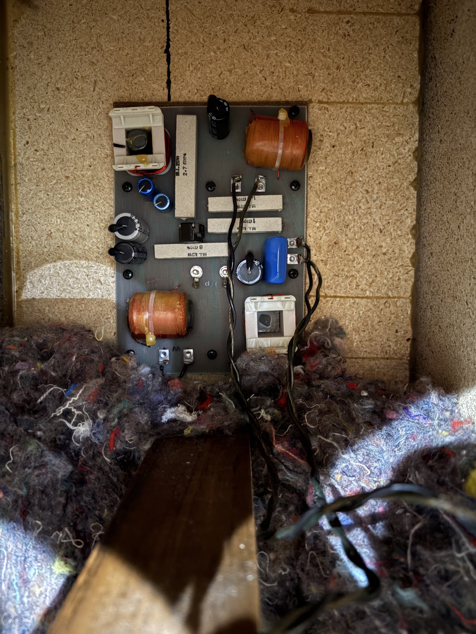

The insulation in my pics above goes all the way to the top. The whole cabinet is as dense as it looks. It definitely does not look like it had anything glued to the walls. I have original crossovers, which I took a pic of as well.
@DonVK - would you be willing to remove one midrange and peek inside yours and see what, if any, insulation there is? The mid is the easiest to remove and big enough hole to look around in.

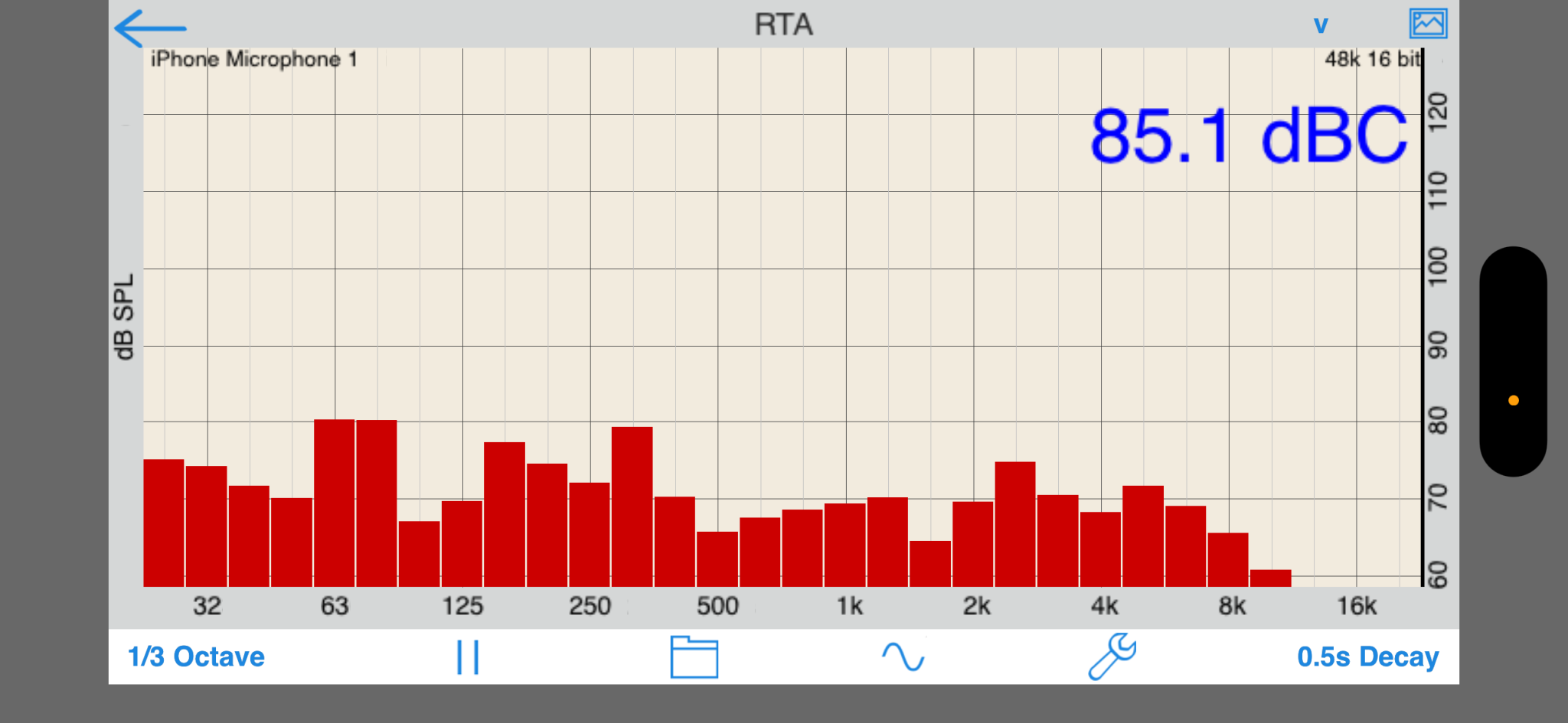

First two photos are left/right speakers, same conditions and measurement systems. Left speaker full insulation, right speaker now has half insulation.
Next two photos are 12” from rear ports, same left then right. Here the reduced insulation has a greater change.
This is the crossover from the right speaker.
With speakers as they are, with right side having half the insulation, the bass quality and quantity still not equal to the 7” units in my Energy Pro 22 Ref Connoisseurs. (Components and room locations being equal). Stable imaging, clear, and clean otherwise.
