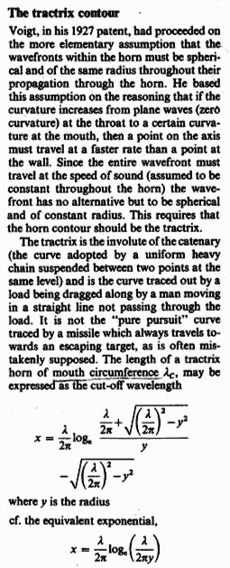

A tractrix is the shape defined by a hanging rope, chain. Fix one end, and have the other end moveable, and be able to vary the length. TO my mind, easier to well define in a SS thou.
dave
I'm not very mathematically minded, but it seems a catenary curve would only approximate a tractrix curve under the very specific condition of the ends approaching their asymptote... a hung string would almost never assume a tractrix curve.

attachment is an extract from Dinsdale.
Tractrix is the involute of the catenary
dave
Just so none of the readers get confused by this discussion ot tractrix...
Tractrix is NOT the shape or the contour of the horn or its sides or its profile.
The term tractrix (or exponential etc) refer to the rate of the expansion of the horn's cross-sectional area. It is very difficult to visually inspect a horn and guess its rate of expansion.

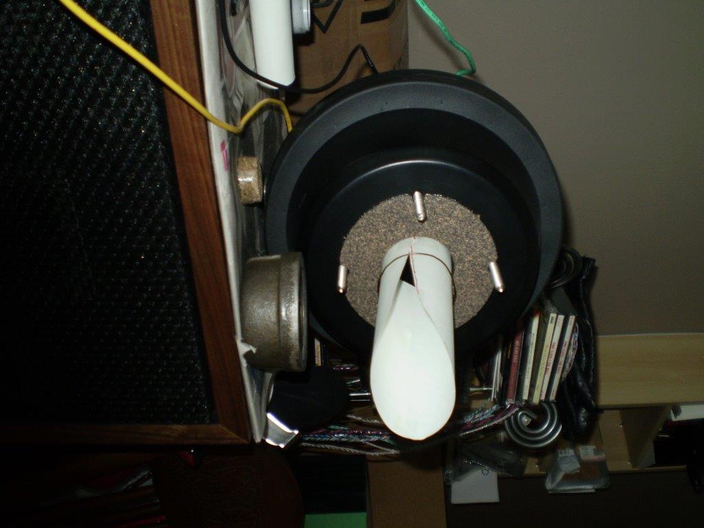

PPS: here is a picture of my fancy paper Karlson K-Tube two inch id six inches long on an EV DH1A stupid simple amazingly fine sound.
paper is a good and super-quick way to sample a Karlson open end waveguide tube - I've used K-tubes for well over a decade and for the most part as long as used in an appropriate range, prefer the tubes over a CD waveguide or horn.
