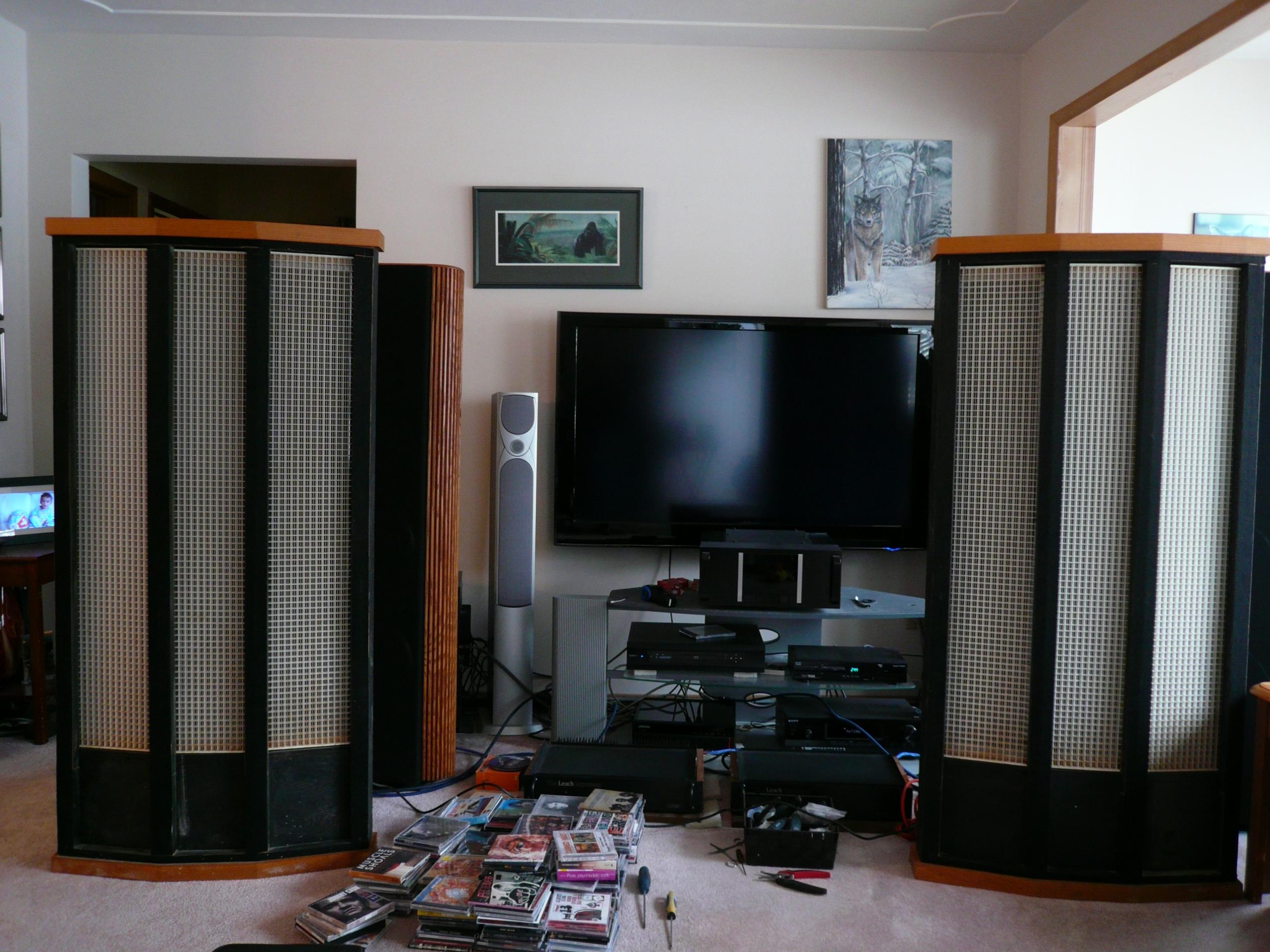

Check this out: So as you can see, the far speaker is toed out while the near one is toed in significantly more than the other is toed out. My point is this is where they have to be to project a perfectly coherent sound stage where they disappear and only the music remains. 1/8" deviation by either and the image disappears. Very strange. I stumbled on this positioning while incrementally toeing them further out. I was not paying attention to symmetry but rather that they faced my listening chair at the same trajectory which is a bit off to the left of center. I knew this. When I adjusted them to zero toe in/out since they were so close and moved my listening position to center, it ruined the image. Is it possible my listening position is coincidentally exactly where the room acoustics place the sweet spot relative to where the speakers are located? These are Acoustat Monitor 3 ESLs. Both are exactly the same geometrically with no defect. I suppose my question is..can the room dictate speaker positioning regardless of symmetry?
You may achieve symmetry of the ESLs in the room, but what about the symmetry of the distribution of the other objects in the room?
They must affect the sound field. Too many reflective/diffracting surfaces influencing the imaging perhaps?
I can understand channel balance being affected by other objects but I find it odd that they produce a correct sound stage when asymmetrically placed. Mind you they do both point exactly to my listening chair which as I mentioned is slightly to the left of center. It's just really strange that this is the only arrangement where they sound correct in this space. Hence my query. In any case a very pleasant surprise. A moment of discovery. Like hearing them for the first time. I thought perhaps someone may have a technical explanation.

Dipoles inherently have reduced output to their sides, so room interactions tend to be less important.
Additionally, large speakers playing full range are very directional at high frequencies. This also decreases room contribution. Roger Sanders intentionally keeps his electrostatic designs directional because of the potential for improved imaging. But, it also gives you the "head in a vise" problem where the sweet spot is extremely small.
Though your speakers employ a faceted approach to widen the sweet spot, practically they are still very directional with a complex lobing pattern. That makes minor changes in speaker toe-in produce larger results than those seen in a less directional design.
A few thoughts on what may be going on in your particular setup:
1) By trial and error you found the precise spot where you're on axis with the central panel
2) You found a lobe between panels where the frequency response on that axis matches that of the reflected sound in your room. A laser aiming tool is helpful if you're looking for precise toe-in or out. If you want to be precisely on axis, looking at your reflection in the diaphragm works on most electrostatic speakers (flashlight over your head can help), though the Acoustat coating may be too matte to use that method (don't remember if their coating is on the front or back). You can also tape a mirror to the panel temporarily.
3) You have an asymmetrical setup in the room/rooms, so a symmetrical speaker arrangement doesn't work as well. The precise angles involved may be minimizing less desirable reflected sound that makes it back to your ears.

Thank you Galu and mattsat. Although there is great synergy with this set up, I don't think it explains the phenomenon.
mattsat, your points are well taken. The speakers are zero toed in relative to my listening position orienting the center panels straight forward. The inner ones are focused right at my ears. I use the frames on the near side of each to visually line them up. If I move my listening position and follow with speaker alignment, the effect disappears. Tolerance is within 1/8", just a nudge will throw it off. It's like you know they are 'there' when they meld together as one which is what happens. I have been adjusting them using a laser and distancing them from front/back wall for years never being really satisfied they are correct. Something has always been lacking I knew was a matter of adjustment. I've made absolutely sure they are vertically aligned which was a revelation in itself. I settled down to compromise due to my off center listening position. Until now. So the discovery here is: for best performance they need zero toe in with listening distance such that inner panels be focused at my ears at the distance they are apart from each other, in this case 8', making my position 11' away. But the perplexing factor is, all needs to be shifted to the left about 4". That's why in the first pic the far speaker is toed out a bit less than the near one. Weird
I forgot to mention that being 'sonically' perfectly aligned, there's virtually no "head in a vice" condition. The sweet spot is much bigger as they seem to meld together as one large speaker. Very similar to dynamic drivers when set up correctly. Have I stumbled across something no one else is aware of? Ime, I've always considered dynamic drivers to be far more critical in placement than the status quo and when finding the sweet spot with them, it's been more difficult to pinpoint within the ballpark it appears, because of the wider tolerance commensurate with the nature of their design. Although there's no "head in a vice" situation with them, I've always felt the actual sweet spot is much narrower than consensus dictates. In fact, I think the better the gear, the smaller the 'actual' sweet spot. IOW, capitalizing on the attributes of progressively better components by nature requires progressively greater attention to set up.
