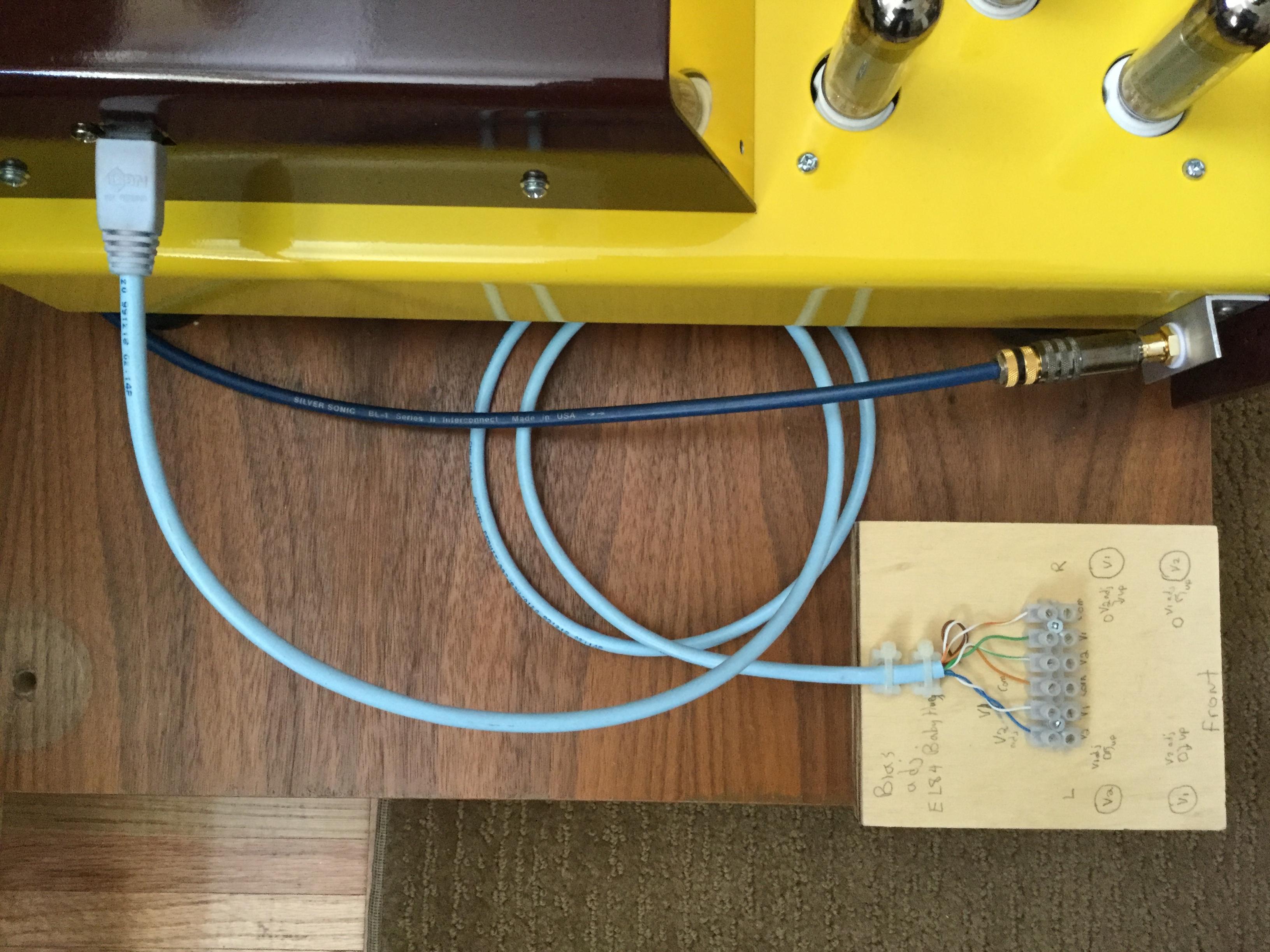

Bias adjustment was another issue. I did not have room to mount a switch and meter like on the EL34. So I came up with using the 8 pin RJ45 internet connector to bring up to 8 wires to the side of the top cover. I then connect a network cable with the other end connected to a terminal strip and can easily measure the low voltage bias voltages. I still have 2 wires of 8 which could be used to monitor a divided down HV and -bias voltage. I will post again about the tubes and operating points etc used.

The HV regulator is mounted on the heatsink at the rear of the top section where the output transformers are mounted. Attached is a photo of the bias adjustment cable and terminal strip. This works well.
