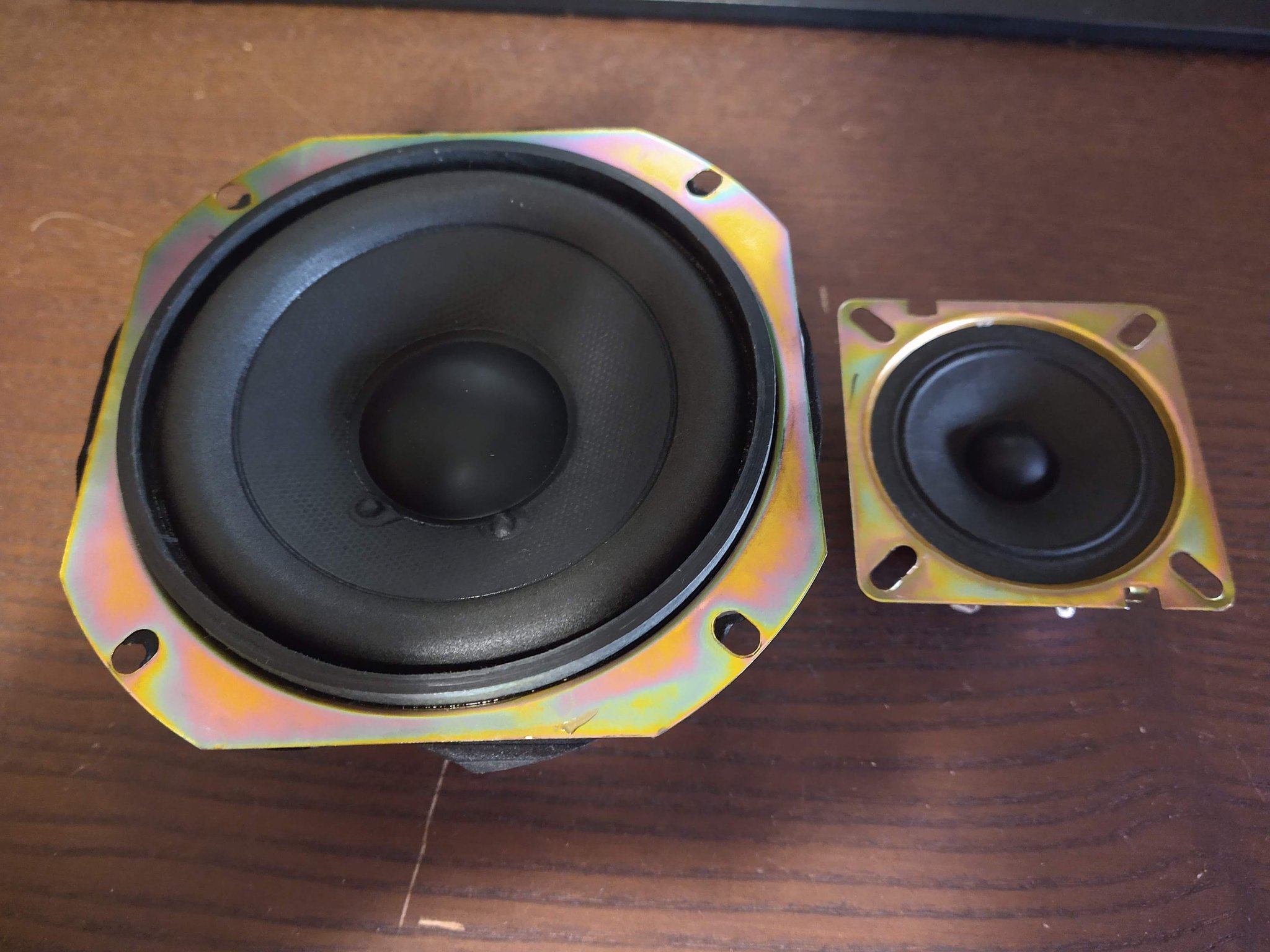

However, I have a measurement microphone and made myself a DIY impedance measurement rig, so this time I had a way to measure the drivers that are part of the Panasonic SB-PM01. It's a 2-way bass reflex mini speaker with a 4" midwoofer and a 2" cone tweeter.
I want to improve this very basic pair of speakers for a fun project.

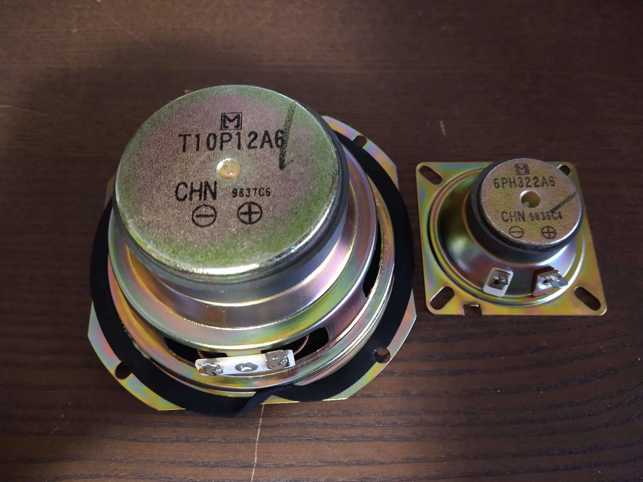

The speakers and the drivers themselves look pretty nice, the box is also very sturdy, the bass reflex pipe is tapered both ways. There's no sound deadener in it.
The drivers have an "M" logo stamped on them and the part numbers, which is T10P12A6 for the 4" woofer and 6PH322A6 for the 2" cone tweeter.

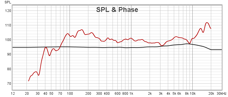

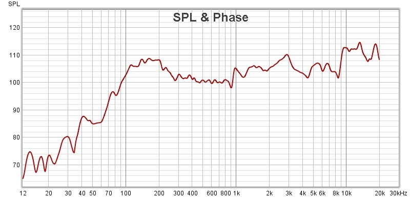

The original measured response doesn't look great, it's tilted up by quite a lot and there are a lot of peaks and dips especially in the midrange. My explanation is that because the midwoofer has no crossover, and the tweeter only has the typical 2,2uF NP protection cap, they overlap by quite a lot in the midrange causing all sorts of phase issues. This is confirmed by the fact that the off-axis response is much worse.

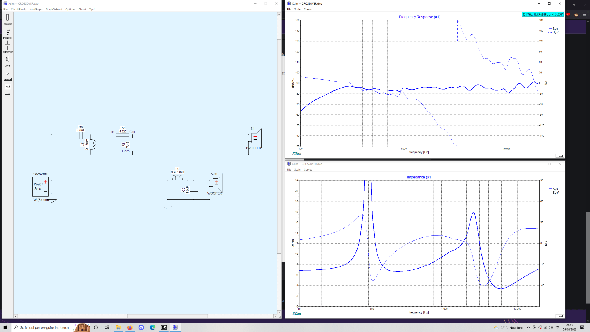

So, my plan for these speakers is to use them to make a decent sounding pair of speakers, starting by a new crossover which will improve the midrange and the soundstage and then adding some deadener which will take care of that 150Hz peak.
I measured the woofer, then the tweeter, and then both of them in parallel to get the z-axis offset right.

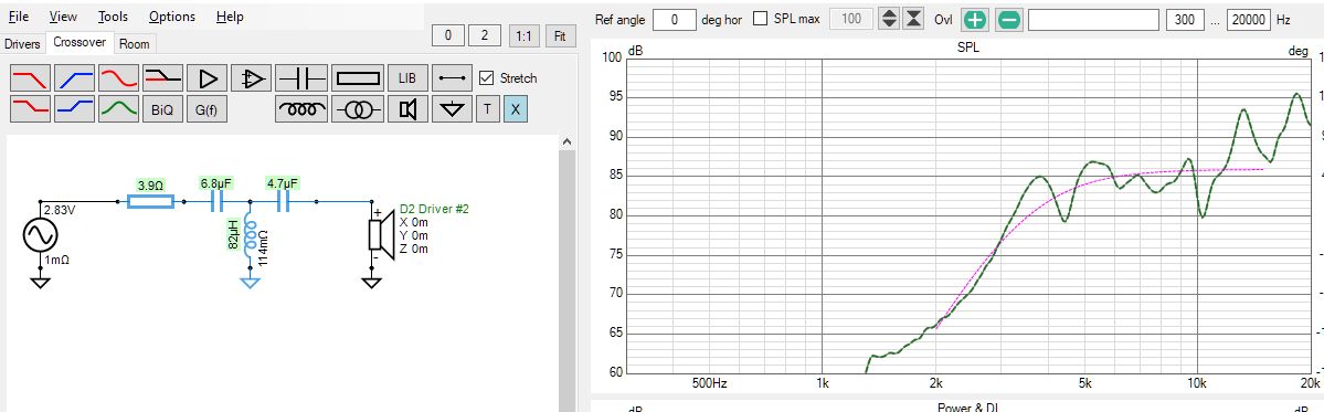

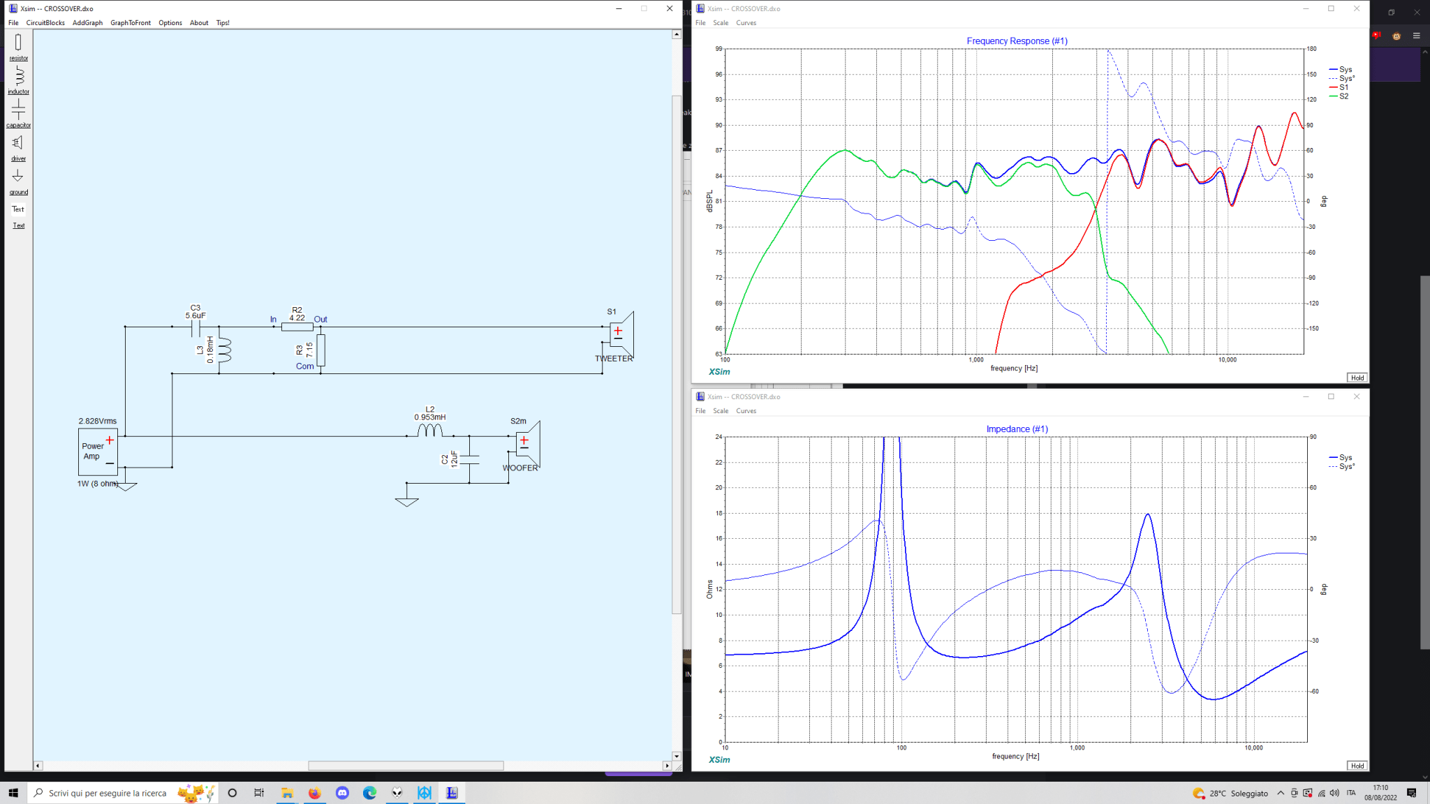

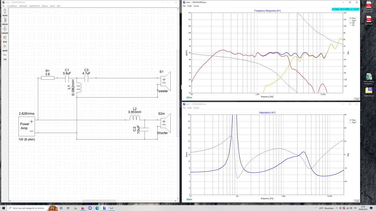

I think I made a pretty decent crossover in X-sim. The response graph looks pretty nice and the impedance graph drops down to about 3,34 ohms at 5,5kHz. This shouldn't be an issue with most modern amplifiers.
Here are some pictures of the drivers and the measured response of the speakers as they came from the factory (scale is 10db/div):
IMG_20220808_183005125.jpgIMG_20220808_183015313.jpgIMG_20220808_164419995.jpgIMG_20220808_164409975.jpg
This is a screenshot of the crossover project so you don't have to download it in order to see it (the scale is 3db/div):
What do you guys think of it? Do you think it can be improved?
I'm attaching the project files.

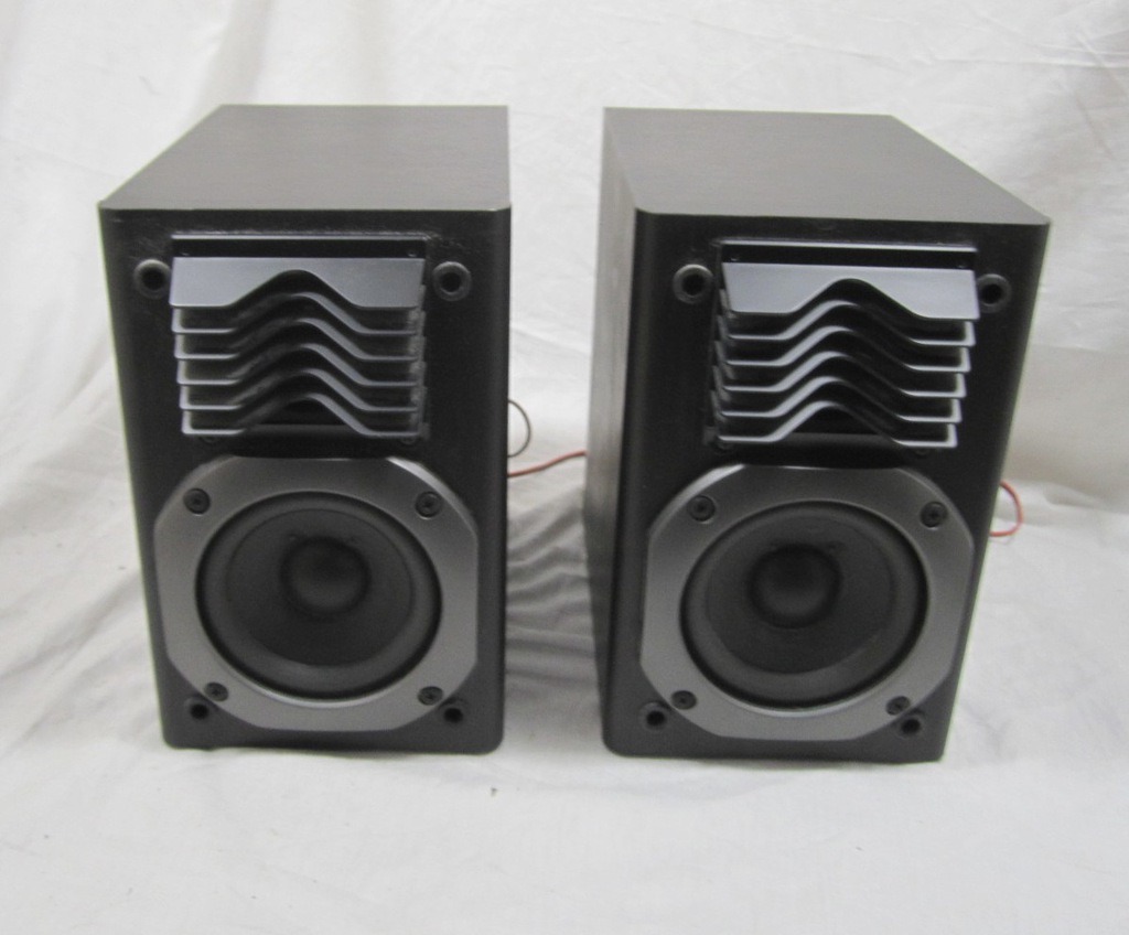

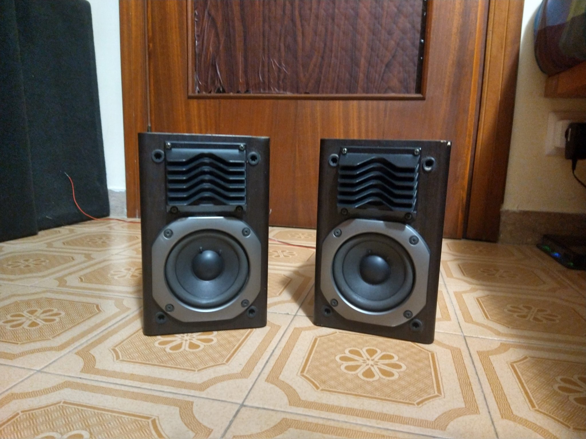

It's surprising that Panasonic did not line the internal walls of the enclosure with absorbent material.
Photos on the net show the tweeter fitted with an acoustic lens - which you have not mentioned.

Hmm, kind of tough to quickly compare 3 dB Vs 10 dB plots, but obviously a lot flatter, though without an audition, not sure I'd want that in a mini-system, i.e. like all DIY efforts, all that matters is 'does it subjectively or otherwise make a worthwhile improvement to you in your intended app'. 😉

WTH does that tweeter cover do? 😆 Were your responses taken with the cover in place?
I don't see any project files.
Those speakers have an acoustic lens on them, but one of them has a broken mounting tab and I'll have to fix it.
To my knowledge its purpose is to make the cone tweeter beam less at high frequency. However it didn't make a big difference on the on-axis measured response whether I had it installed or not, so it will stay because it also looks rather nice!
The measurement were taken with the lens installed.

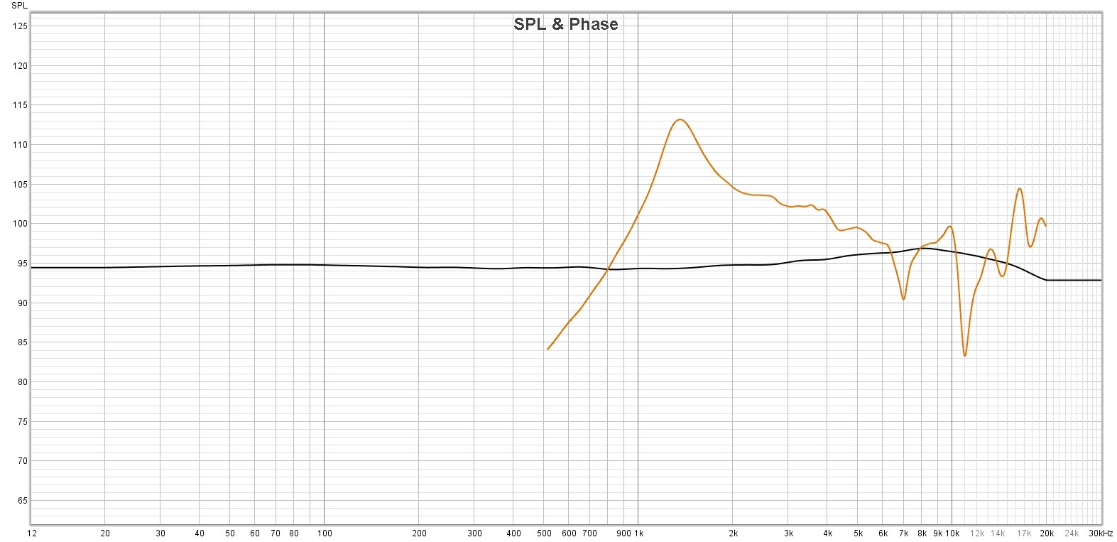

Also, here's the same graph using a 10db/div scale! Do not check the response under 300 hertz because my measurement started there. I didn't want to start the sweep at 20hz in fear I may toast the tweeter. Also I don't really care for what happens there because the crossover frequency is much higher.
I had a quick look but stopped cause of the tweeter. Based on your files, there's a 10db peaking from 10khz that I can't flatten.
I wonder if it's related to that "acoustic lens" - can it be removed?
I believe that is due to the tweeter paper cone breaking up. that sort of response is typical of most 2" cone tweeters. I've taken some more measurements with the mic 5mm (or 1/5") from the tweeter without the lens on. I wouldn't worry about that too much as it's very high up in frequency tho.

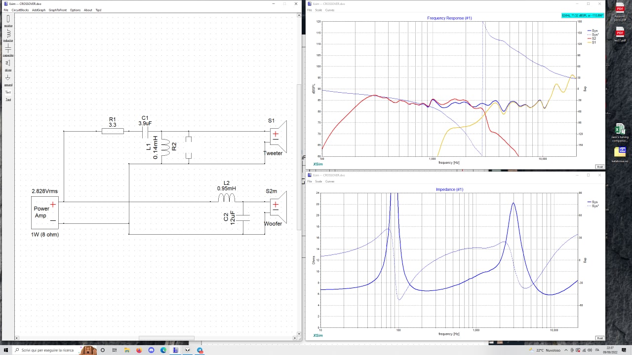

I think I somehow improved with the crossover after following motokok's scheme (third order and a single resistor). There's almost no overlap in the midrange compared to the second order crossover. I think it might also help with the tweeter distortion and power handling. The impedance also never goes under 5.9 ohms.
This is another try I made with a second order crossover on the tweeter. The impedance now looks very good!
It's the "overlap" in the 1/2kHz region that worries me. I don't think that may cause problems off-axis because the speakers are way closer than the wavelenght of 2kHz, however I am worried that the tweeter might distort because it's crossed close to the Fs with a shallow filter.
On the upside, the frequency response looks a bit more linear in the midrange because there's a some subtraction and I also need to buy one less part.
What do you guys think? Which kind of design is better?

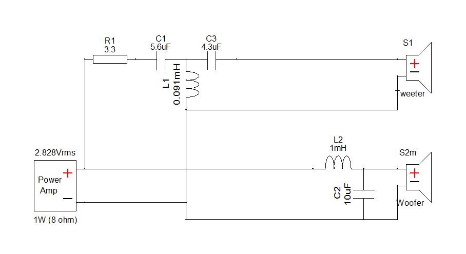

I assembled the new crossover! I've decided to make the third order crossover because I already had very similar components to the ones required.
This is the "final" circuit schematic:

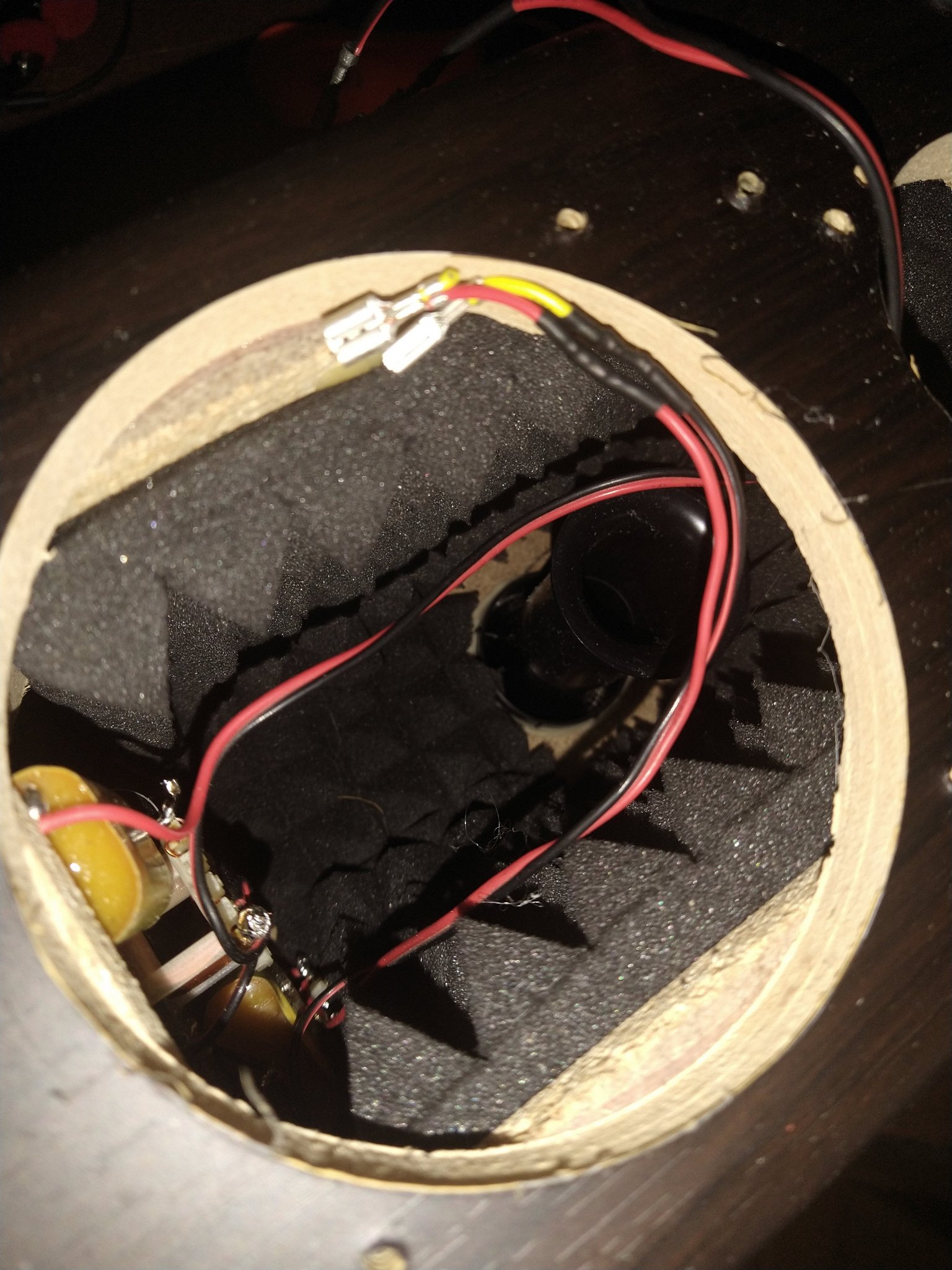

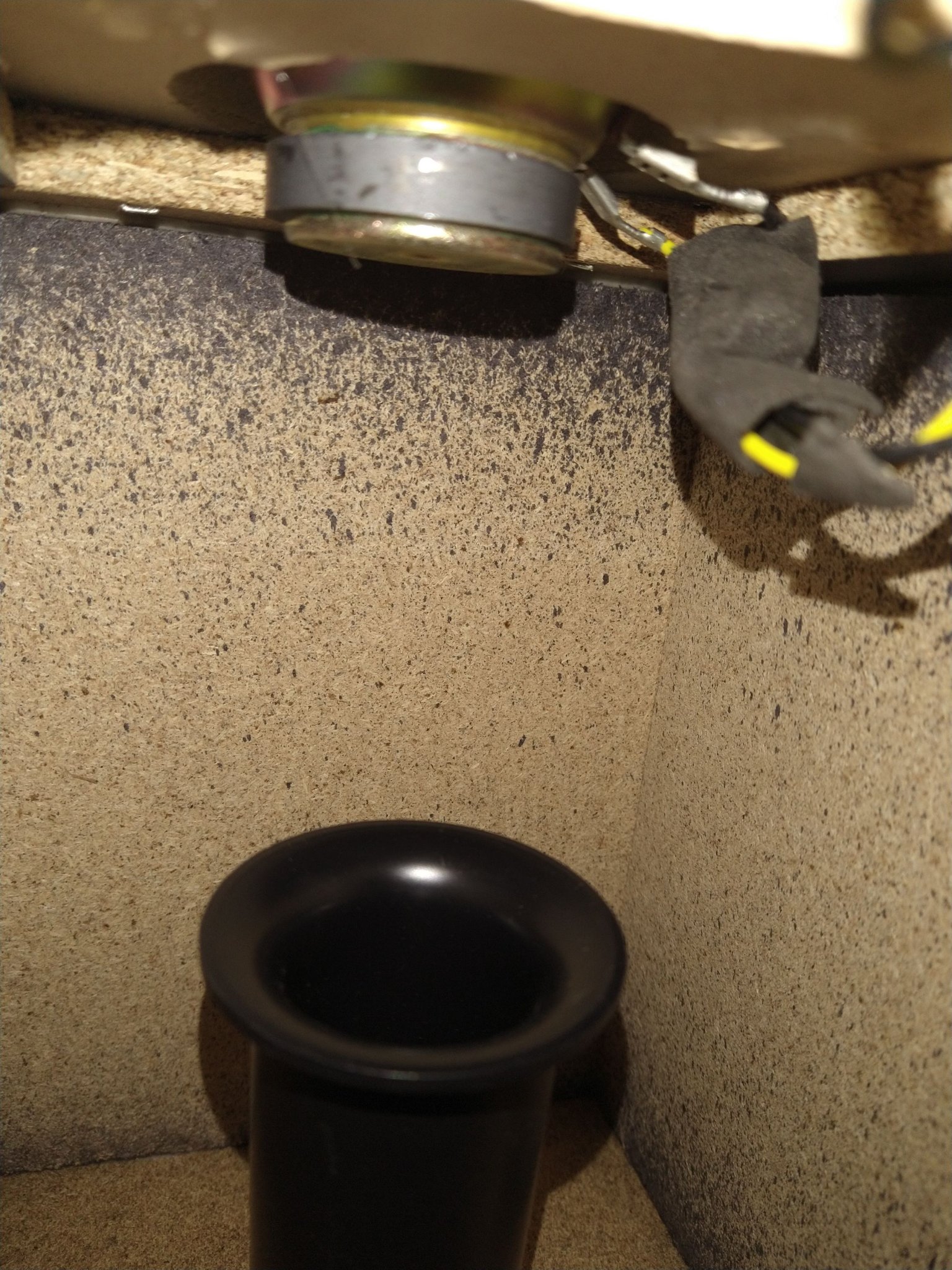

This is how I mounted the crossoverin the enclosure. I used hot glue to stick it to the box in case I ever needed to take it out. If I had used wood glue it would've been impossible, and I couldn't screw it in place because of how cramped it was in there.
I also added some sound dampening, but after I took the picture I had to add more because I noticed some nasty resonances in the 2kHz region and the midbass was still too loud.

If we compare with the old one (below), it is much better:
