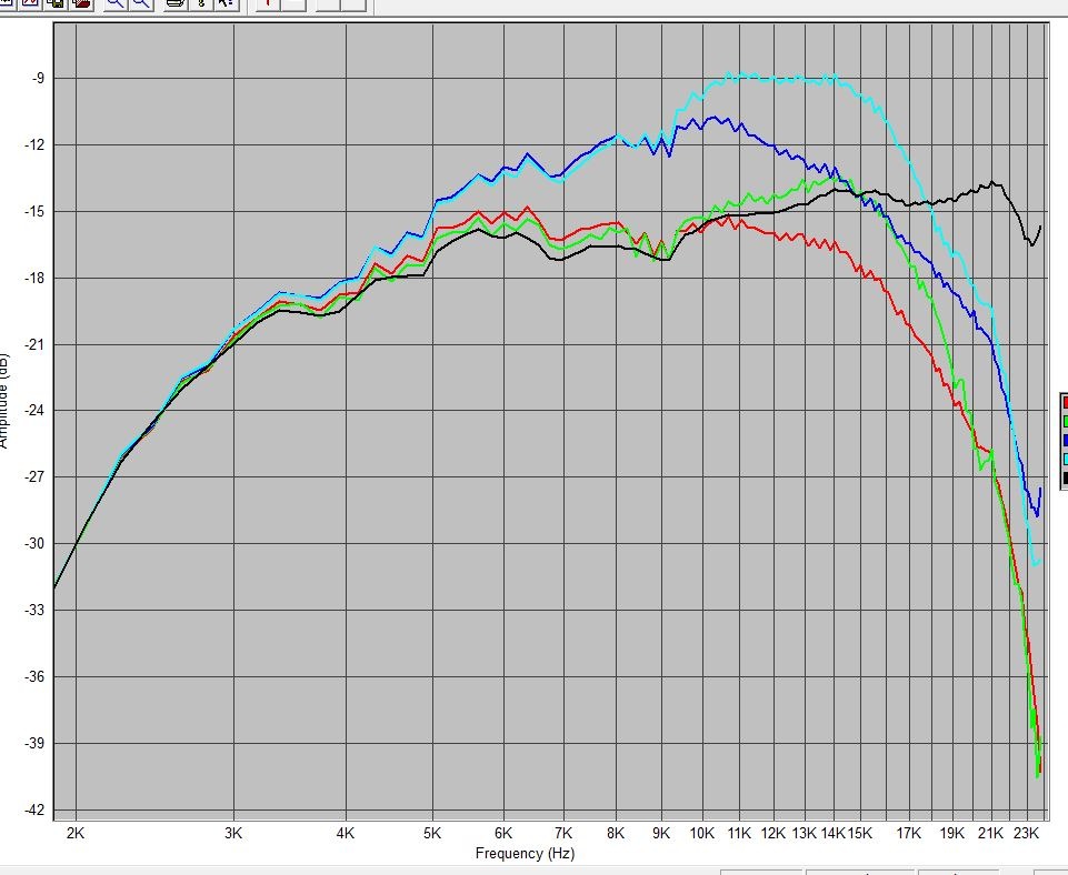

i bought 10 cheap 5mm dia mic caps recently, there is a wide spread in response, but one is flat till 11k and another till 15k
(black is ref flat response)
