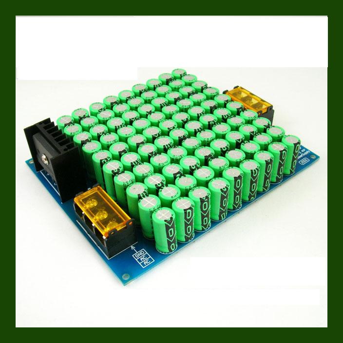

I would like to know if I can use successful Panasonic FC capacitors for a Class A amplifier power supply.
I want to use (multiple) about 30-40PC 3300uF 25V capacitor like on the attachment. Rail voltage around 16 -17VDC... (Picture only for ref)
I see on Ebay these methods getting more and more popular. Another reason the Panasonic FC not bad caps, all do I only know them from P. Daniel Gain clone.
Until now always I used large can caps in power supply (min. 10 000uF and up),
I would like to know if there is any disadvantage or advantage using these type PS..
Any advise, comment welcome.
Thank you very much🙂
Greetings Gabor

It all depends on space and component availability. With a gazillion smaller caps you can fill an area much better without taking up much height, which is definitely advantageous if you intend to build a very flat piece of equipment. I would also assume better high-frequency properties.
If you do have the height but PCB real estate is critical, conventional "big can" types are more suited for audio work - besides you don't get a million solder joints. This option seems to be quite a bit cheaper, too.
I don't know if it's needed for Class-A, but multiple caps in parallel like this nets a stupid high ripple current rating. You usually see this sort of thing in high current motor drive circuits.
I've done this before for Class-D simply because I already had a bazillion smaller caps and didn't want to buy new larger ones.

I purchased already 30PC 3300uF FC capacitors. I taught I ask for opinion before I start to solder them...
I want to bias the amp 1A each side.
If they work nice may be I buy 10PC 4700uF more. A Dollar each including shipping from Ebay.

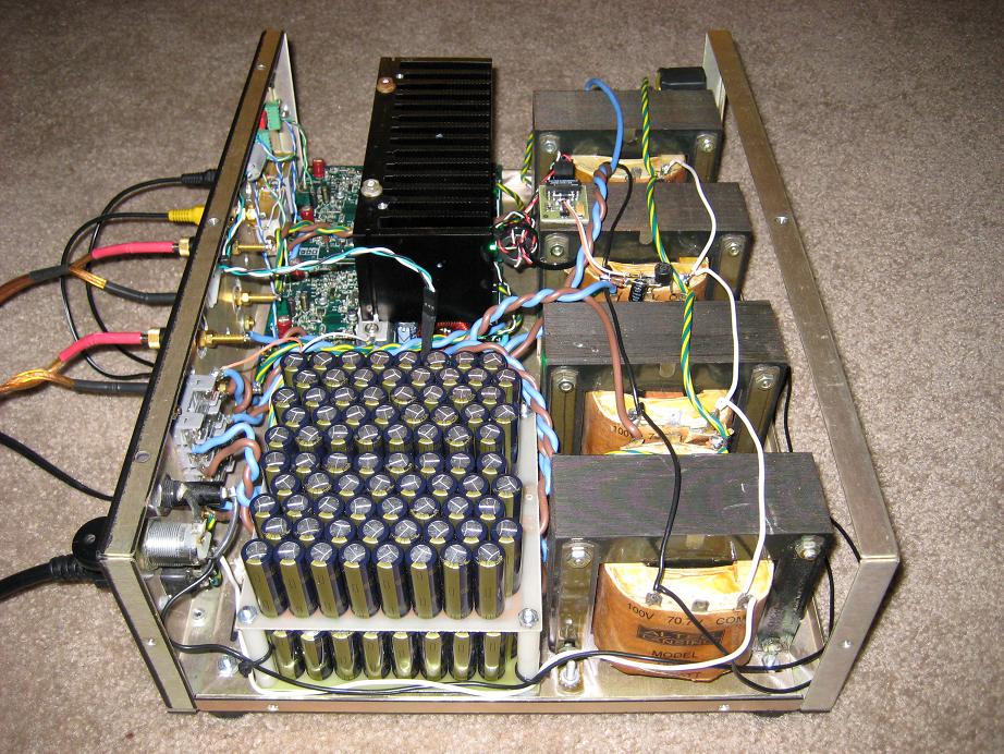

Here's mine, using Pan FM with total 56pcs 2700uF/25Volt (CRC) for F5
work flawless till now 🙂
