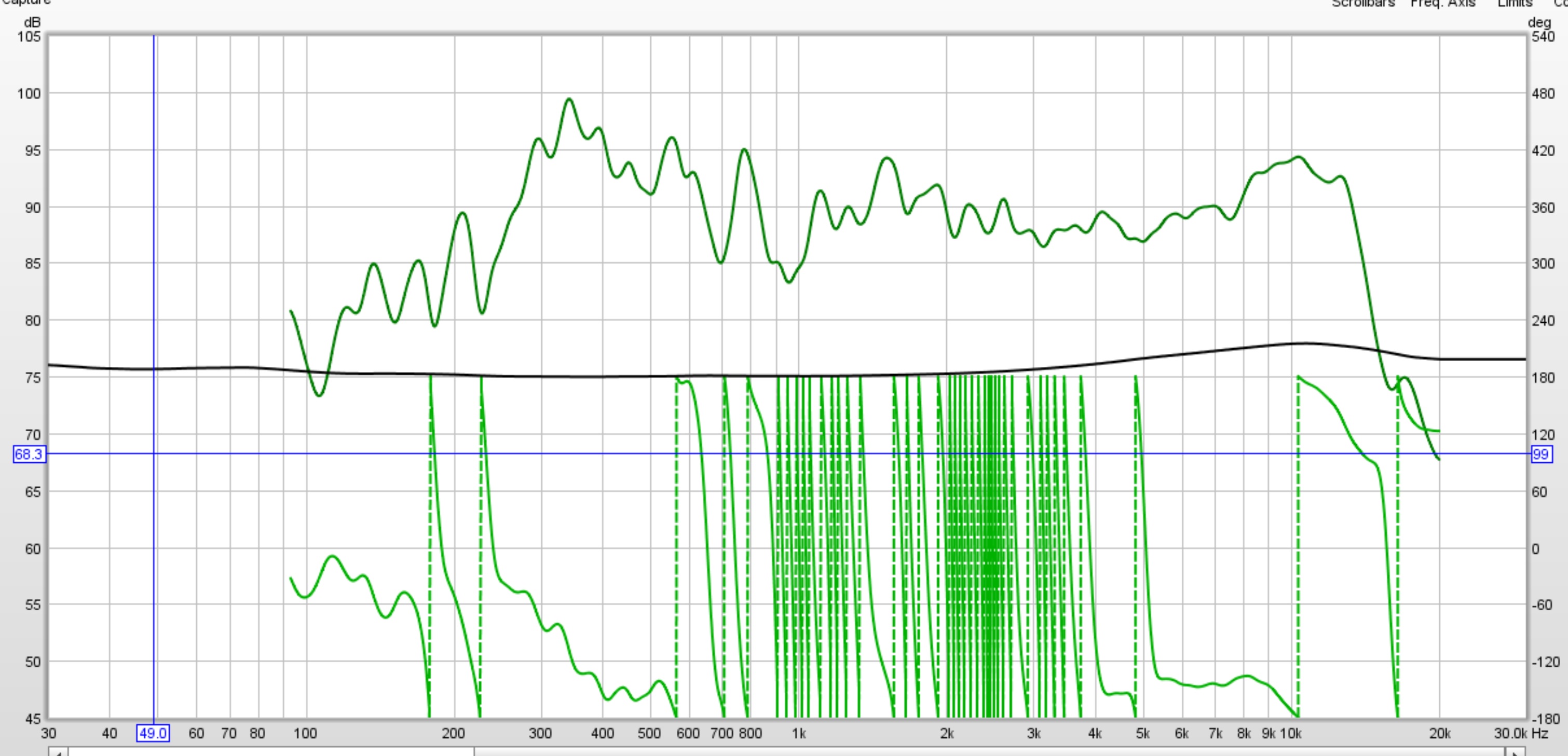

I just tested the driver at 300Hz (Volt Meter rated <400Hz) , baffle width 500mm, sine wave, 2.75V RMS across the speaker terminals, calibrated mic pickup positioned 0 deg 1m in front of baffle and the reading was 93.2dB. Higher than the Faital Pro response graph which shows approx 88bB at 300Hz. Not sure what's up with the result I generated, but it looks like there must be an error. When I set the amp gain so there was 2.75V RMS (closest I could get to 2.83V as my amp gain is in 0.5dB increments) across the speaker terminals, and then lowered the frequency the voltage increased, and when the frequency increased the voltage decreased. Is this normal? Any ideas for tracking down the error?
Agreed, the voltmeter does find AC sine waves tricky. One quirk I discovered with my meter is that if the frequency changes during a read the value fluctuates. If the signal is stopped and then a fresh read is taken it seems to be consistent. The voltmeter spec is to read AC voltage 40-400Hz with 0.8% accuracy at the level tested. I got tightly groups reads from 50-400Hz, and then generated a sweep in REW from 90Hz-20kHz and recorded the attached. When I ironed out the result with 1/1 smoothing the average was approx 90dB. Although the response is all over the place (probably contributed to by room and furniture effects), the average sensitivity isn't far off the manufacturers spec.
The 3 inch driver should be beaming above about 5k, so it's easier to compare the response in that range. Assuming you were driving it at 1W (seems like you should have been pretty close) your measurements are slightly lower at 3k (87-88dB versus 90dB) but rise up to similar levels at 10k (94-95dB) before really rolling off from 13k-20k (is your source or amp causing that?). Without using the same baffle you will obviously get different results at lower frequencies, but it still does look like a very sensitive driver. Should give you some decent SPL from the small drivers and the limited power output of the PAM8403.

I would take the claimed frequency response with massive doses of salt. A 3" at 91db/1w/1m can have a flat Power Response from 2KHz down to around 250Hz sealed box, ~~120Hz with a precisely designed vent box. Above 2KHz it will, as BWRX says, be beamy (declining off-axis, but flattish on-axis). I'm not sure it is "easier to compare" in the beam zone, but it will be less and less room response mucking your measurements. Unless deliberately limited, I'd expect flat or slightly rising to 15KHz.
On a half-meter baffle I'd expect disturbance and bass-cut around 340Hz (half wave) which is seen in your plot.
It's certainly not the best way to do it, but for a simple sensitivity sanity check it's easy, quick, and better than no measurement at all.
