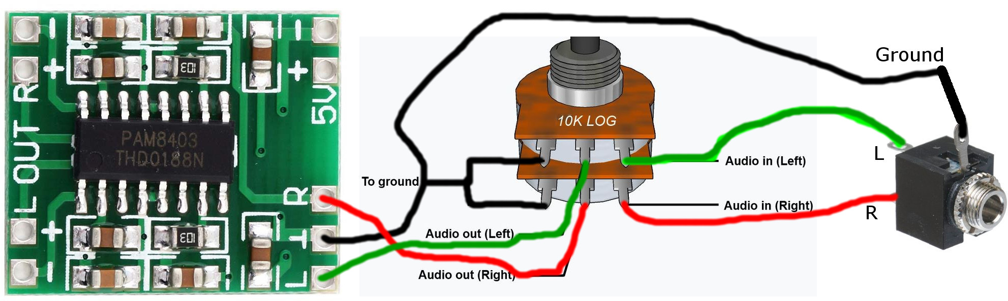

Ok. So I understood a lot of it.
I need to connect it in Dual gang for stereo audio.
I'm attaching an image. Correct me if I'm wrong.
There are 4 grounds: 2 on the pot, one on the jack, one on the amp.
All the 4 grounds would be connected together.
The left out of pot would go to R of amp
The right out of pot would go to L of amp
I only dont know what the dashed line is.

Ok. So considering just one channel. Let's say left channel.
Pin 3 recieves the hot wire from the left channel
Pin 2 is sent to L of the amp.
Pin 1 is the cold wire and it goes back to L input and also to L of amp?
Ground of 3.5 mm socket and ground of amp are connected.
I'd this correct?
I'd this correct?

I guess there was a confusion.
I'm attaching a picture with the parts I'll be using and probably the connects are correct this time.
The amplifier is a stereo amp. The input is also stereo.

don't use the 3.5mm TRS
take two signal returns from the PAM Source. One signal return gets twisted with the signal flow for a channel.
The green wire NEEDS a balck. The red wire NEEDS a black. The other signal return gets twisted with the signal flow for the other channel. These must be made up as twisted pairs or coaxials. DO NOT separate the returns from the flows. That increases LOOP AREA and big LOOP AREA increases interference.
You now have two sets of two wires fromPAM to vol pot. and two sets of wires from vol pot to amplifier. Keep those electrically separated all the way to the power amplifier.
BUT !!!!!!
the PAM has a commoned signal return. This will create a loop in your signal wiring.
You can reduce the interference on this loop by keeping the two sets of wires close together. And invoking the HBRR & HBRL from the D.Joffe article linked many times in this Forum.
Your cartoon pic looks like it is showng metal cases around the vol pots. These are the metal cases that need to be connected to chassis.
