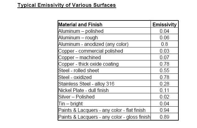

I read the application note by IR that cpemma linked to (table attached), and according to them, paint is more effective than anodizing 😱

that table in post8 is worth reading.
Heat gets out of the sink in two ways:
radiation and conduction.
Conduction to the laminar layer of air in direct contact with the surface accounts for the majority of the dissipation capacity of a heatsink.
The faster the air travels past the sink the thinner the laminar layer. A passive cooler has slow air flowing past the surfaces (that's why it's important to have the major dimension of the sink fins in a vertical direction) resulting in a thick layer and we all know that air is a poor conductor of heat. Blow the sink and dissipation improves markedly, even a slow blower or a strong draught makes a significant difference.
Radiation accounts for less than 10% of the dissipation capacity of a passive heatsink that has been designed to expose a large surface area to the cooling air. A fan blown sink relies on only a tiny proportion of it's dissipation capacity from radiation (probably less than 2% or 3%).
Radiation can be improved by choosing a high emissivity surface.
The gains in emissivity from 0.7 to 0.94 are significant PROVIDED that the conduction is not compromised. Adding a thick layer of insulating coating will reduce conduction and since this should account for at least 10 times the radiation then take care with any added insulation.
A gain of 2.7% in radiation [(0.94/0.7-1)*8%] and risking the loss of 10s of percent in conduction should be approached cautiously. Plastic coatings (dipped or electrostatic) can be very thick, undercoat adds to thickness, brushed on coatings are usually thicker, etc.

All true, the question would seem to be, how much does anodizing compromise conduction? It is basicaly a ceramic (aluminum oxide) that is "grown" on the surface through a electro/chemical process. The thickness is the issue with both, but I would think that if the thickness were equal, paint would have the edge over ceramic..it would be hard getting paint as thin as an anodized layer though.

P.S. It was post 6, not 8 😉

The usual rule for fairly even temperature spread is the radius from the device should be <=10*thickness.
The other de-rating factor to take account of is the deltaT reduction. DeltaT is the difference between the contact face temperature and ambient temperature of the cooling air.
Taking the thin backplate and the deltaT in account I suspect 0.21C/W may go up to about 0.4 to 0.5C/W.
Increasing the height will not gain much since the remoteness of the extra fins from the heat source means the fins run very cool and as a result don't dissipate much in comparison to the fins directly behind the chipamp contact face.
Sorry to have to disappoint.
Good sinks cost good money.
Now, if you were to build a discrete amplifier and distribute the devices to maximise the effective heat distribution, then you would be back in business.
you have a bigger problem than choosing between paint or bare aluminium.
The backplate of those sinks is thin.
A single device bolted near the optmum position (40% up from the bottom) will not heat the whole back plate evenly.
The sink will not get near the manufacturer's disspation which allows for the whole back plate at the same contact face temperature.
