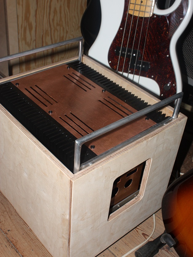

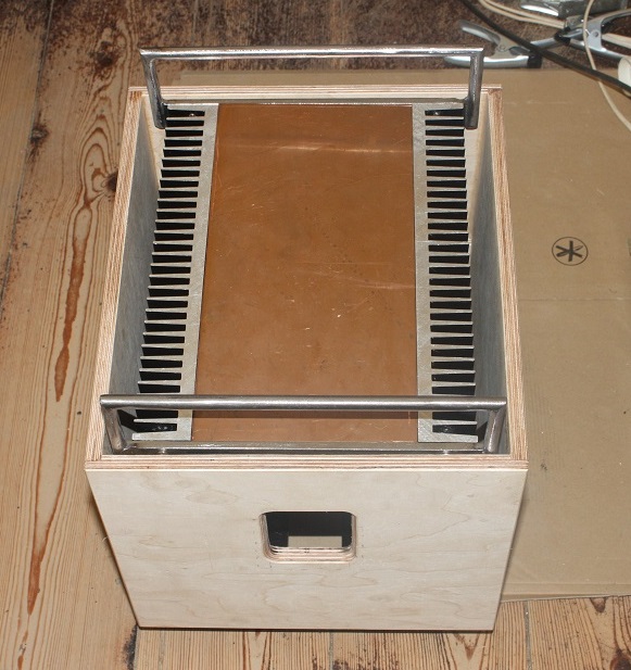

Conrad heatsinks, a part mentioned and used by a number of DIY audio members, use a powder coated paint finish and they seem to work just fine.
I use fast drying flat black laquer from a spray can.
