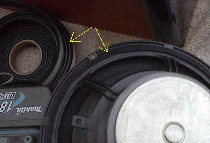

I need some advise on a suitable material for sealing drivers to a MDF cabinet, because using silicon turned out to be a nightmare.
After a lot of work sanding etc I painted my MDF cabinets with several layers of black spray paint (www.plasti-kote.com), turned out really well. Then I put strings of black silicon to seal my flush mounted drivers to the cabinet. I let the silicon dry/harden for about two days, then mounted the drivers. Everything looked great for about a week or more, then weird 'stains' started to appear on the baffle near the drivers, seams to me like the silicon have reacted with the paint somehow. Even though the silicon was dry when I mounted the drivers, when I took the drivers out the silicon was partly semi liquid.
I cannot find rubber gasket material the size I need, silicon is obviously out, what else can I use to seal my drivers that will not react badly with the paint?
The speaker is a two-way bass reflex design, I take it I cannot mount the drivers directly onto the MDF.

You can just make a rubber gasket of any size you like.
Take a door sealer rubber strip. This should be self-adhesive, make a ring around the speaker cut-out with it. Cut of excess. Done.

Mortite aka Rope Caulk might work...

Weather seal.. that double sided adhesive foam stuff. Another alternative. It's a pain to form in to a circle, but no more than rubber.
I cut my gaskets from 2 mil craft foam; seems to work OK.

I like to use the Madisound "Foamtape" for speaker gasketing. You can attach the adhesive side to either the speaker or the cabinet mounting surface. It's 1/2" wide and only 1/8" thick which is perfect for this application, IMO.
Thanks for all of your replys, I just have to hit the local hardware stores again to have a look and see which of the suggested materials I can find. Removed the silicon and sanded down the speakers somewhat last night, hoping that the silicon won't give me more trouble ...
Unfortunately I don't have much in the way of margin when it comes to the flush mounting, so the sealer shouldn't be more than say 1 mm thick.

Compression of madisound foam tape
thoriated:
Do you (or anyone else for that matter) know how much the madisound foam tape will compress when the drivers are firmly screwed into the cabinet? The tape is 1/8-inch thick which is a little too much for me, but I guess it will compress quite a bit?

I've used clear GE RTV with success for many years. Use a small bead around the driver flange. I usually let cure for 20 min or so before mounting to baffle No problem with removal. Peels off driver with a little work.
Might be the paint u used. Some paints need to harden up over longer periods... normal latex enamels need about 2 weeks or so in warm dry conditions.

From my experience, it will compress up to 75% or so (to about 1/4 the original thickness) when the speaker mounting hardware is tightened.

In my experience with black RTV silicone it often does not cure properly, or it takes much longer as in weeks than the overnight you get reliably with the clear stuff. I stay away from black RTV now as the cure is unreliable IME.
The "correct answer" is: "rope caulk". Often found in the USA under the brand name "Mortite".

I have found a local distributor that sell an oil and heat proof rubberlike gasket material for the motor/engine industry. It is available to consumers from rolls 1 meters wide, 0.25mm, 0.5mm and 1 mm in thickness.
I think I'm going to attempt making driver gaskets from this material. Though, I wonder what kind of livespan this material has in a speaker application, I know rubber tends to dry up over time ...?
