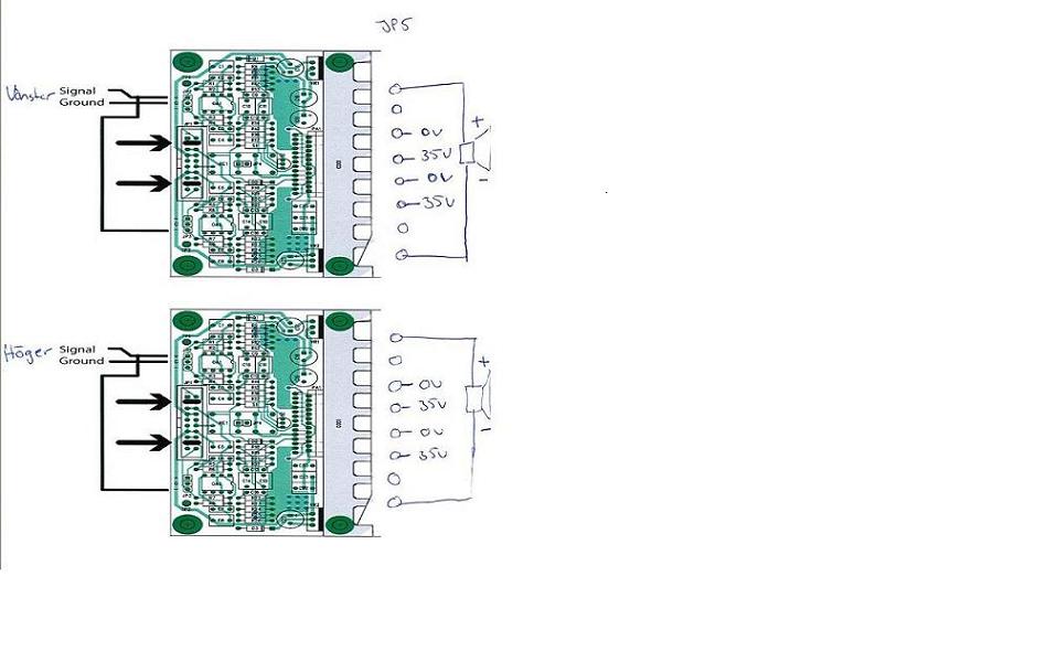

Me and my friend are building these amps from the groupbuy last year.
Almost done with the first chanel and have some questions.
If you look at tha attached file we wonder is this correct way to connect signal, transformer and loudspeaker ???
We are newbies in the diy building
We don't understand the instructions in the buildin guide
Please help us to finnish these amps.

If you can to use bridge configuration, speaker termination is correct. Wrong is at your pic connection of transformer - correct is 0 - 35 - 35 - 0 connection. Try to ask Per- Anders, I hope he will explain it to you... 😎

Thanxs for your answer.
Yes we will use the bridged configuration on our amps.
So i guess that the signal is correct and now we know how to connect speaker and transformer also
Thanxs again for your answer
