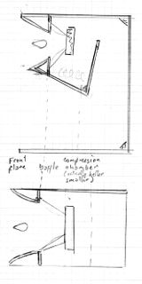

I've tried to add a drawing; I can't get my CAD program to export anything I can upload so I did a pencil sketch and scanned it, and I'm no graphist.
With a transmission line the energy from the rear of the cone is absorbed, thrown away. With a ported enclosure a small percentage is let out, to add energy in the frequencies below the driver's resonant frequency. But with a horn like this the space behind the speaker works as a compression chamber (I should have drawn that smaller, but this isn't a scale drawing or anything precise), and the expansion of the path works to match it to the air; the speaker stays e relatively high impedance, because it's pressure loaded, and most of the lows come from the horn mouth.
Yes, without very careful calculation there's going to be antiphase signal, and wobbles in the frequency response, but we're not aiming for super HiFi. And for 60Hz they're not enormous; only the expansion rather than taper makes them bigger than a transmission line.
I drew a single 12 cabinet, because that means you can aim them; one of the problems about using largish cones up to 2.5 kHz is that they get very directive. Perhaps I should have drawn it trapezoid, though that makes visualising the horn flare a lot more difficult.

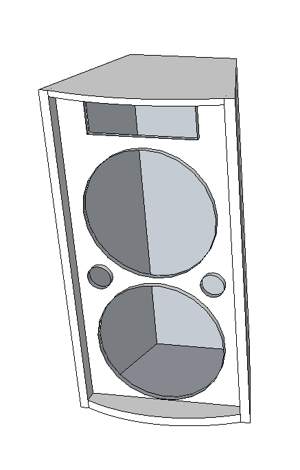

I think i've come to the solution that i will just build regular bass-reflex cabinets. Horn loading would be cool, and definitely give us a higher efficiency, but the extra volume and weight will make them too unhandy i fear. Afterall its not a PA system meant for professional use, but just for festivals/parties. I've included a sketch of the system as im planning it to look like, not with completely right dimensions. By the way, would you recommend to put the tweeter between the woofers or on the top? Im thinking on the top atm, because that will take it closer to listening heights if the speakers aren't elevated that is, ofc.

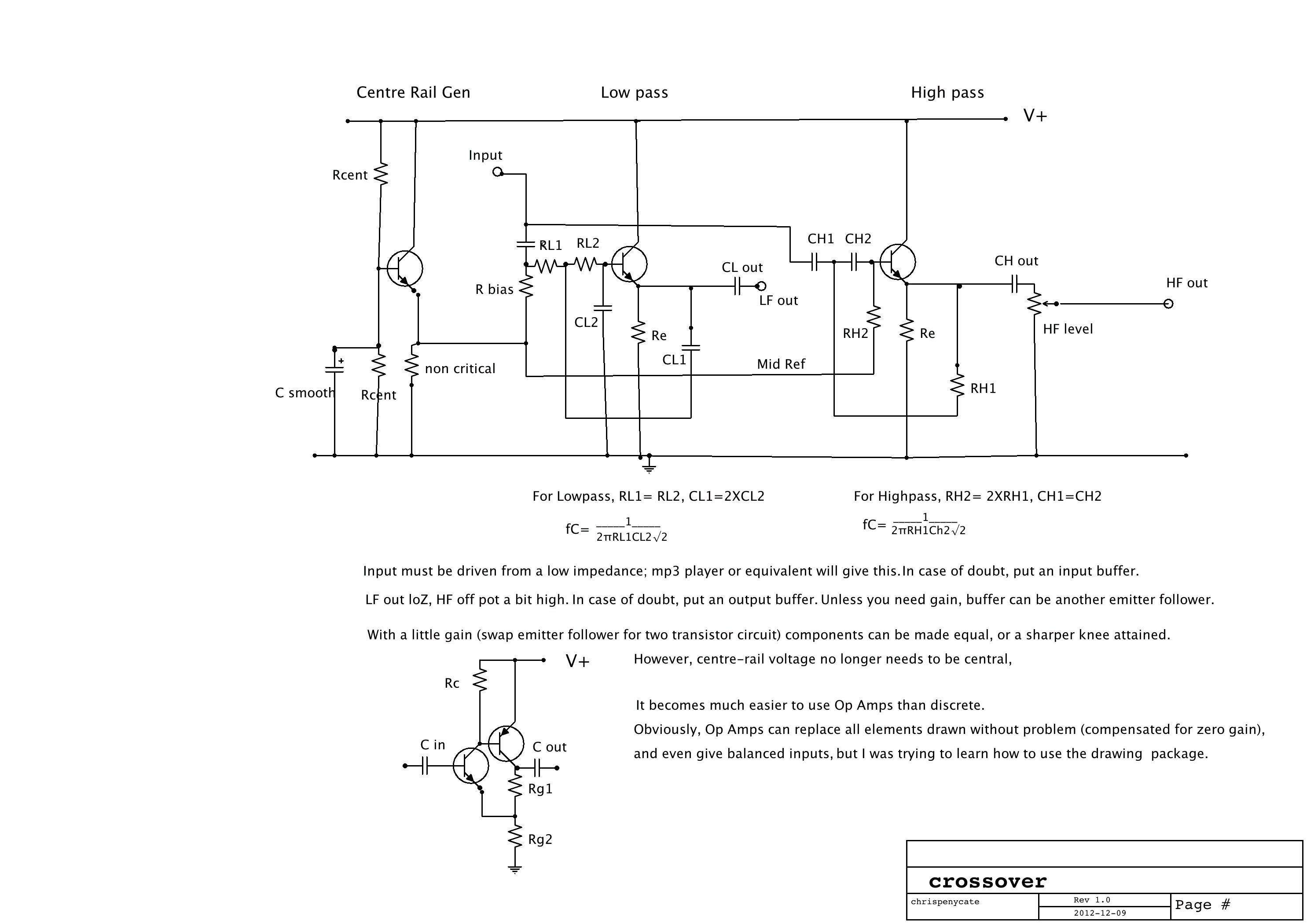

Bi-amping sounds like a cool thought, and an extra d-class amp isn't a big expense. What would it take to make a simple 2nd order active filter (crossover freq. around 2½-3 khz i imagine)? The filter would have to be run off the batteries as well.

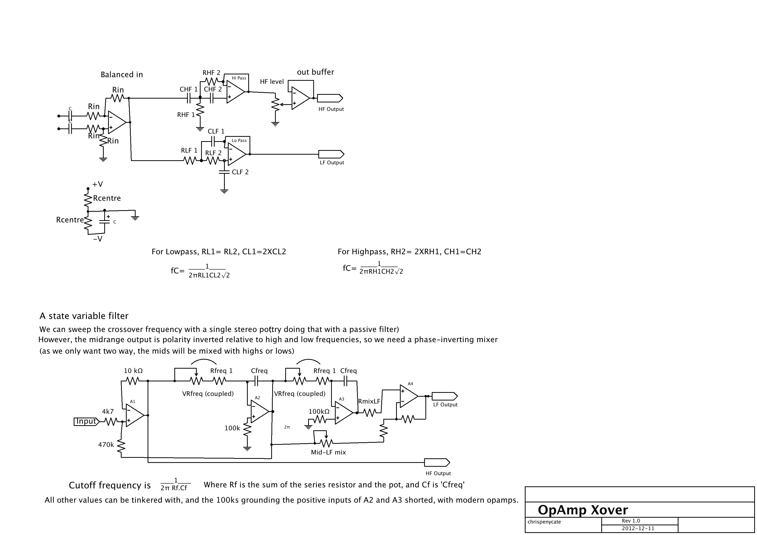

Cheaper and easier to do it with resistors and caps than muck around with inductors. My web access has died, so I can't easily do diagrams, but with a transistor you can put a second (or even third) order filter round an emitter follower (zero voltage gain, impedance converter) or an op amp with the negative input shorted to the output, which does the same thing without the voltage shift. Either can work from your battery, or take little enough current that you could put them on a tiny battery alongside. One high pass, one low pass, and the values can be got from any active filters book (I'll try and draw a diagram and post it next time I've got net access).
Nice drawing. You're not going to get a transmission line into that, so go for reasonable ported enclosure. The tweeter in the middle is theoretically better for phase matching, at the end, as you've drawn it much more practically useful; you want to get the high frequencies well above the heads of those nasty moving absorbers we call the 'audience'. Make a (sealed) hole in the bottom so you can stick them up on poles – um, 'speaker stands'. And put handles on them so you can fly them, or tie them to trees.
Yes, I'm double posting, and yes, it's probably too late for this project, (oh, and yes, it's not the most HiFi I could manage, but easily high enough quality for this use) but I might as well see if I can upload files like this.
And who knows? Somebody else might need something like this (although they'd better have a bit of an idea about electronics; I left out values of an awful lot of non-critical components.)😉
