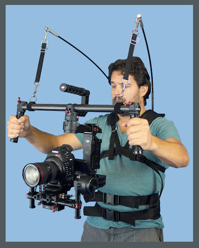

and i may be going way over the top on this one but think it's a way better idea in terms of allowing a speaker to project unobstructed would be to adapt something like a camera support

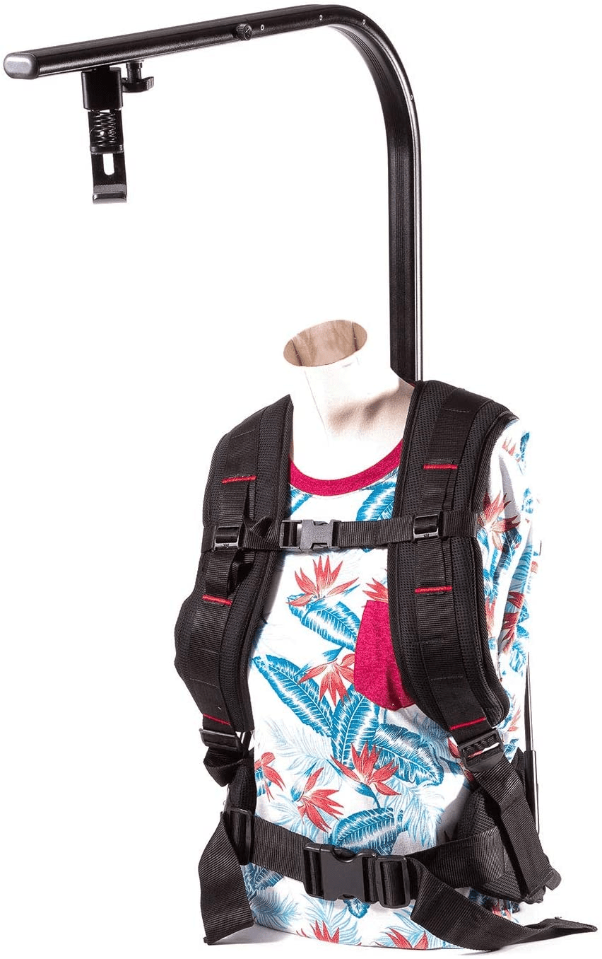

That is going to to be my next project finding a solution that is a little more comfortable.and i may be going way over the top on this one but think it's a way better idea in terms of allowing a speaker to project unobstructed would be to adapt something like a camera support
View attachment 1039628View attachment 1039629

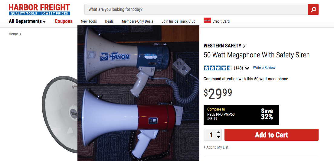

As a complete unit, the Western Safety 50 watt megaphone would probably do fine, and 18v would probably not be too much for the circuit. If you wanted more low frequency, you could replace the re-entrant horn with a 5'-8" cone, though for what you are doing (fast talking to old men..) the frequency response (and efficiency) of the megaphone and mic is probably just what you need.This would be used mostly outside as a shoulder carry unit. Mostly used in 30-45 minute shots but would want to be able to go longer. I would prefer it last a whole day (8-10 hours) but if I do a Milwaukee battery it would be simple to swap. I think 150hz would be a little on the low side. I am a little higher pitched. My biggest question is what amp to use.
The noise cancelling mic really works, loads of gain before feedback without needing to talk loud.
At $30, even if you only use the amp, hard to find anything close to it's performance- it's output is within a few dB of the Fanon MV-20s megaphone they copied that cost over $150 in the mid 1980's.
