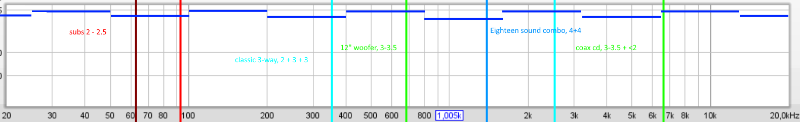

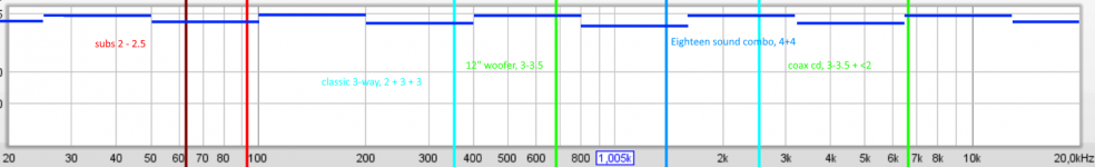

Yes, the Ruutinassakka is now my reference 🙂 I don't own them, but I'm considering them as a 2-way option. I listened to them in Hifitalo listening room recently and they sounded very good, except that I wished something more for the mid range (I had to lower the treble quite much on the amp, it was way too bright, that might have left mid range uneven). Now that I got decent bass from sealed subs I've come to want better mid range. My current speakers are a combination of Eighteen sound 8" ferrite woofer (8MB500 IIRC), Faital horn and entry level BMS cd in a ~40 litre ported box. Alone they are ok, tuned to get best bass from that element, so mid range is lacking, treble is fine, I actually like that BMS. When I plug the ports and crossover to subs at 100 Hz, the mid range clears up remarkably and with some Dirac magic the speakers turns into a very good sounding system. I could go mad with my existing dsp and fien tune them until the world ends, but I think I can get much more detail by upgrading. The Eighteen sound combo, Ruutinassakka, if I made them a sealed cabinet, cross them to subs and fine tune with DSP, just like the current system, it could be enough for me. If I employ a dsp plate for them, the price goes up, but I could better match output levels (Ruutinassakka elements have something like 20 dB efficiency difference!) and fine tune to fit my taste. Does anyone have experience with these Eighteen sound drivers and how to go versus some competion?
If you look at the attachment here (I hope the text is well visible), you can see the approximated xo points and octave ranges of drivers of a few different style of builds. When looking at this while keeping in mind that I need the same speakers to work for nearfield and to the couch without moving them, wide horizontal dispersion is needed, I think that best overall sound quality for near field would be accomplished with point source for at least mids and highs, bass is not as important. To me horn loaded coax cd looks like very good option, since I like the sound of horns.
I was looking at Troels's Faital-3WC, but it looks like drivers are too wide apart. 3-way: horn, 8" and 12"? Maybe, but the 8" looks like too big for point source and smaller doesn't differ much from Faital-3WC. Also having 3 cones (mid, woofer, sub) below 1.5 kHz seems like an overkill. Higher xo to cd might endanger to point source and wastes cd+horn capability. I was also playing with a thought of getting a KEF LS50 for its UniQ and cross it as-is to a larger bass driver (imagine WCW with 12"ers and LS50 in the middle..) and also to the subs. Many conventional hifi drivers may also offer great alternatives, although power handling could become a problem 😉
