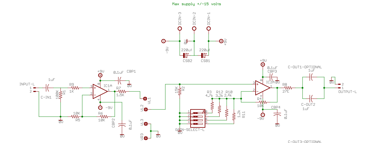

For anyone that is familiar with Rod Eliott's P88 preamplifier, I have a question. Is there a problem if I move the volume pot from between the stages to the input directly. I do this because I want to recreate the tone + loudness circuit of a vintage Sony preamp that I love, and that uses a passive Tone module at the input signal. Would there be any disadvantage to moving the volume pot to the input. Thanks !

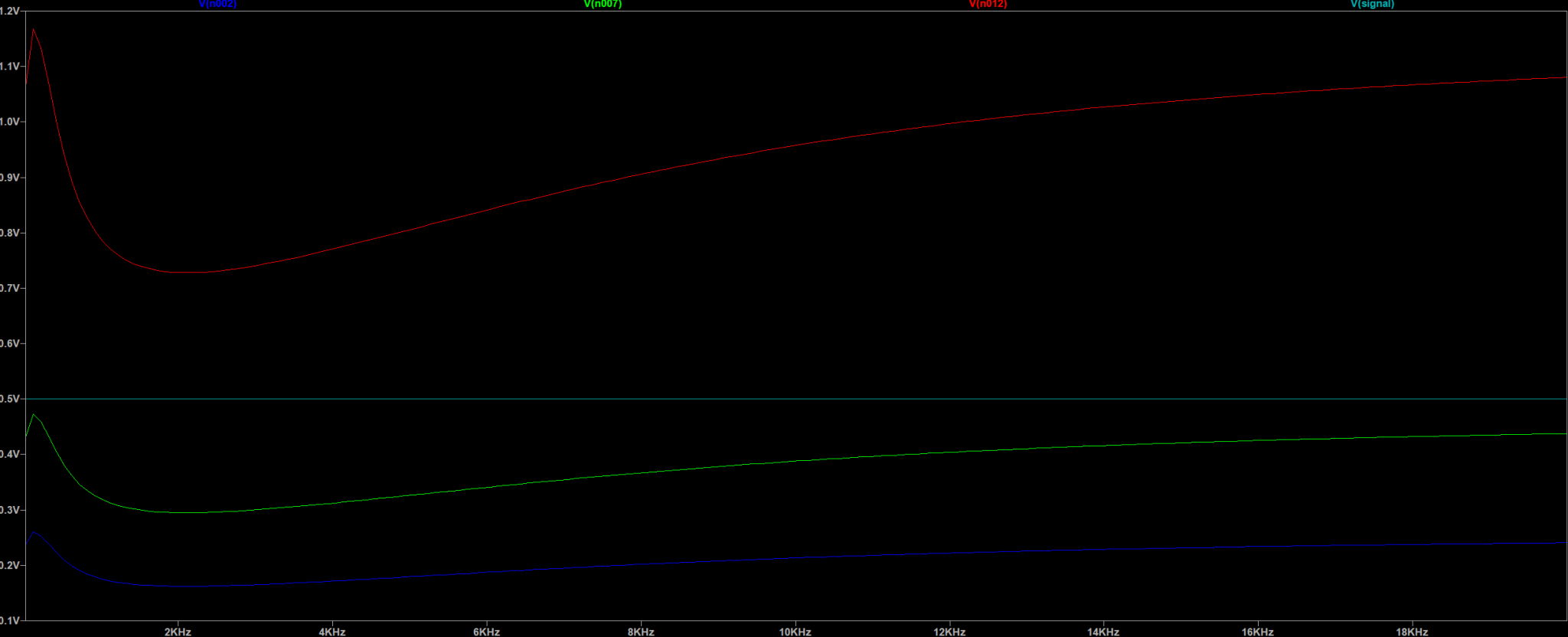

Also, does this look OK ? Teal - input signal , Blue - input signal after tone correction at netural PLUS loudness ON , Green - signal after P88 buffer stage, Red - signal after P88 final stage ( this gets sent to the P3A amp directly )
