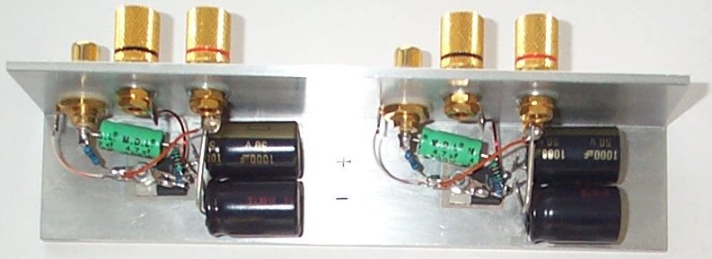

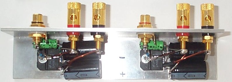

mFinalHeaven: I used enamelled copper wire that were offcuts from the toroids and a little bit (20mm) of cat5 for the signal wiring.
aiwonsi: I used the Peter Daniel's minimalist IGC schematic. 2 filter caps, 1 input cap, 2 feedback resistors but I used a 100K resistor across the input instead of a pot. Both use the identical circuit.

Hi Raka,
I'm not using a GC type PSU yet so it is a little premature to judge the sound quality and to be honest I think I may have LEAD ears anyway.
I'm using my test PSU, which is a 2x12VAC 300VA, a bridge and 2x10,000uf filter caps. This gives about only 17-0-17VDC.
What I am suprised about is;
1. with only 17 volts these amps generates more than adequate volume on my inefficent speakers.
2. the difference between the LM1875 and LM3875TF is surprising small. I was expecting chalk and cheese. The LM3875TF may have a little more guts.
3. the LM1875 seems to heat up the heatsink quicker than LM3875.
I rotate between 3 GC amps at the moment and here is my preferences, although, the differences to my ears are minute and I am happy listening to all of them.
1. LM3875 IGC
2. LM1875 IGC
3. LM1875 non-inverted GC
Even in there present state these amps sound better than my old Yamaha, but that not surprising to us DIYers,

Hi Bricolo,
Thanks. I have been trying to make these things really compact because......I don't really know why.
Anyway, I got the RCA and speakers sockets here at a local electronics store.
http://www1.jaycar.com.au/
Sorry I couldn't get the direct URLs to the parts so here are the part numbers, use them in the search field.
PS0276
PS0277
PT0430
PT0431
PP0434*
PP0435*
The speaker posts marked with an * have fragile insultators. In the first picture you'll notice one of the black insulators is not centralised because it is broken.

Nice 3875 layout. I like the idea of the chipscrew/ground star.
