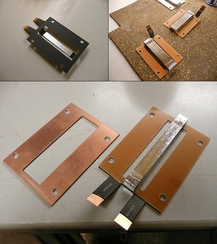

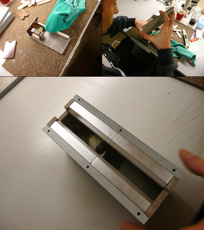

DIY RAAL Ribbon.... Sorry to go OT but how do I do this?
RAAL 140-10 copy... DIY materials:
Cold Finish Mild Steel Rectangle 1018
0.25" X 3" MILD STEEL 1018 COLD FINISH RECTANGLE
24" Length - $16.74 for three 6" high sides
Neodymium Magnets N42 3"x1/2"x1/2" NdFeB Rare Earth Magnets
Our price: $3.95 * 4 = $16

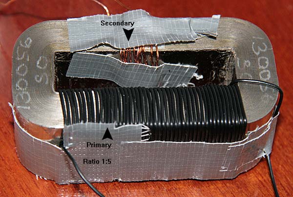

Cut open a film-foil capacitor for 5um to 9um aluminum foil for the ribbon
A premium amorphous C-Core is $22. A grade 77 ferite toroid core is $9.
Amidon FT240-77 or FT240-J or FT240-K are ~ $9
Magnet wire can be used for a trifilar transformer winding. If you use C-core sections it is straight foward to pre-wind copper foil coils on formers that slip onto the two C-Cores.
The ribbon cavity is stuffed with poly-fill or wool to absorb rear waves.
