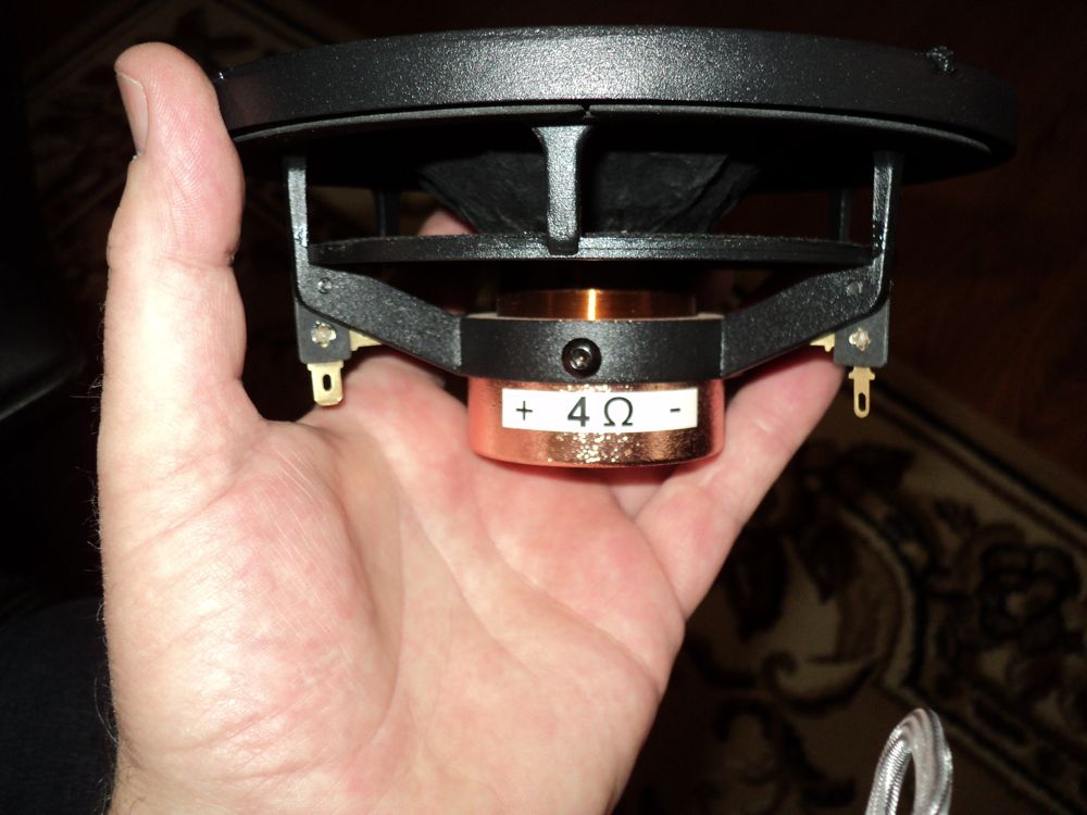

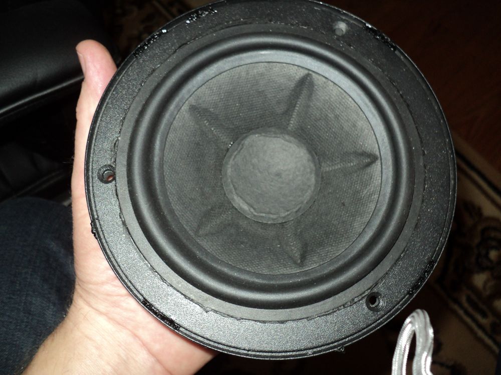

Is it a car audio driver?
If so, it seems they like that sort of thing--sensitivity is not a concern. What is the Xmax on that thing?
Thanks guys.
81 dB for a car driver? Not sure of the Xmax, I would guess 6 mm?. Ich spreche kein Deutsch.
I'm not really sure what to do with these things.
I notice the Aurasound are less than $4. Unfortunately that doesn't do my heart any good. 🙂
Maybe a good match for the Aurasound 3" full range driver to be used as a tweeter? The 3" full range has a dismal 80dB 1w/1m.
6mm of Xmax for a 13cm driver is pretty stout, throw in the Aurasound full range for 200Hz and up and you'll have some seriously jumping cones. Might be a good solution for parents of teenaged kids (like me) that like to watch cones moving back and forth. At least it won't smoke their or your hearing. Such is the price you pay for maximum "flex".

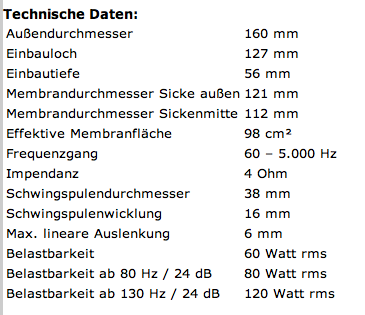

Total diameter = 16mm
Diameter cutout = 127mm
Height = 56mm
Cone diameter with surround = 121mm
Cone diameter without surround = 112mm
Effective Cone surface = 98cm2
Impedance = 4Ohm
Voice Coil diameter = 38mm
Voice Coil Height = 16mm
Xmax (linear) = 6mm
Power full range = 60 Watt rms
Power from 80Hz (24dB/Oct) = 80 Watt rms
Power from 130Hz (24dB/Oct) = 120 Watt rms
